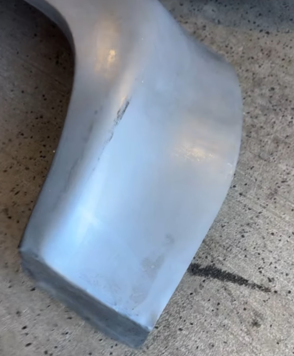

I decided to bite the bullet on flares and ordered from PMB. Knowing that metal prices seemed to be going up, now seemed like the best time to and PMB had the best price.
While PMB is fairly close to me here in Southern Nevada, I was surprised to see that the flares were originating out of Murietta, GA.
I thought to myself "I bet they drop ship them from Auto Atlanta"
Definitely the case and makes no difference to me where they came from but I found that interesting.
Autoatlanta also charges something like $200 more for the flares.
I think they all get made in Canada by Restoration Design.

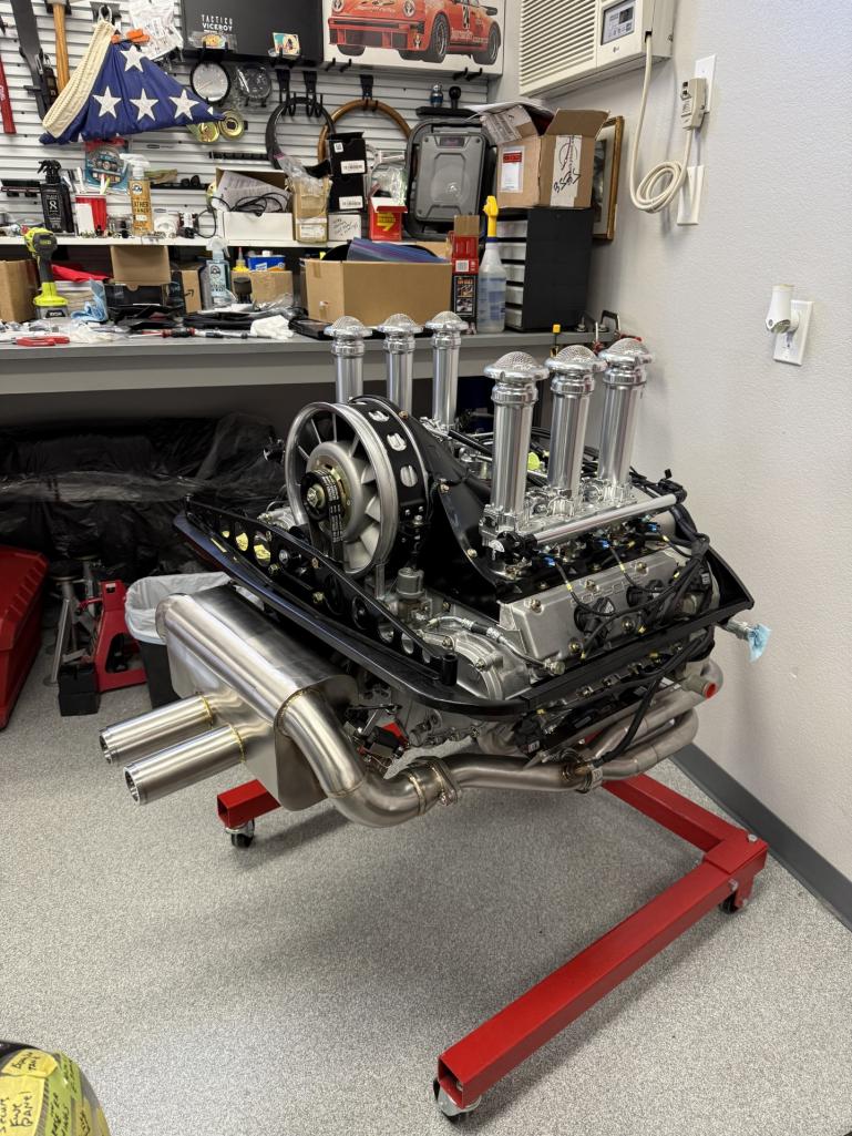

6. Full engine rebuild with J. Doring. He did the longblock I did the rest. A lot of time was spent getting the engine right and installing custom SV auto headers and the AT Power throttle bodies.

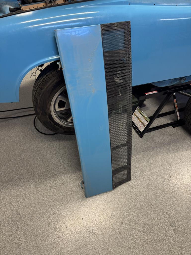

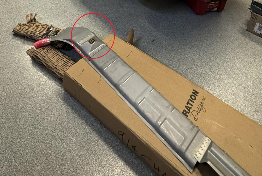

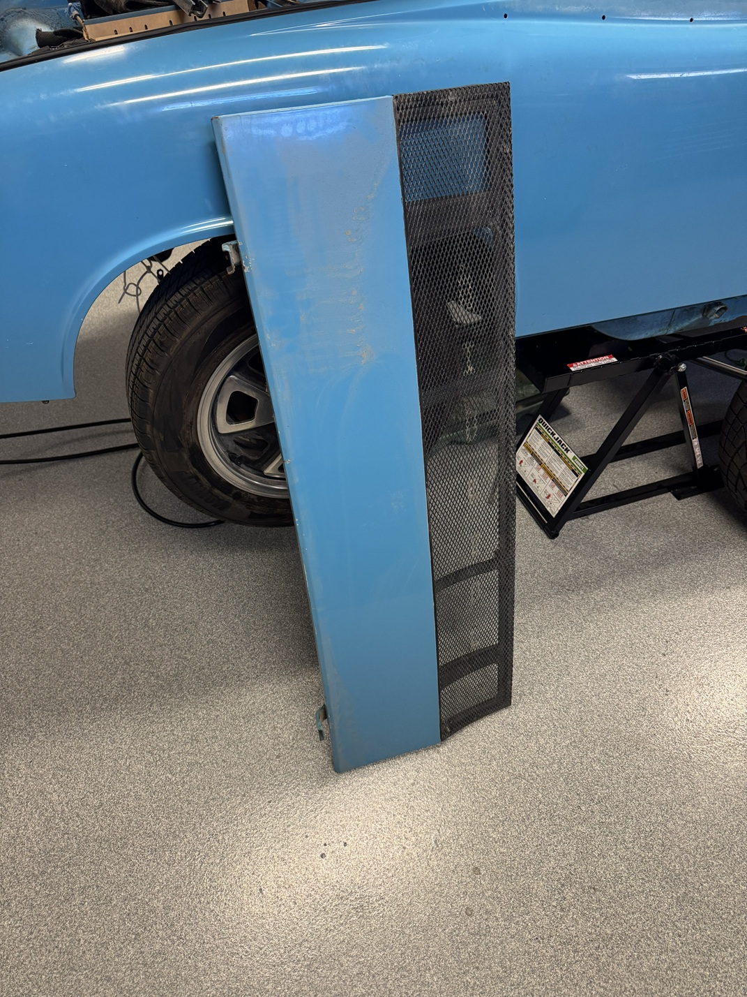

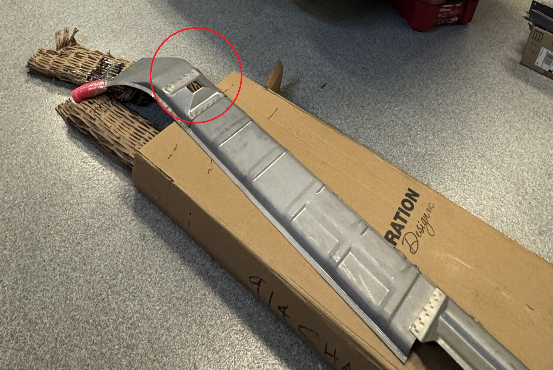

Lastly I test fit the Restoration design outter long reinforcements. In their tutorial, the show the install minus the rear quarter. I don't want to cut off my rear quarter to install these.
The trouble is that they wont slide over the jack point with the rear quarter lip in the way. I would either need to notch the RD piece in that area to put it on or cut my quarter panel for access. What do you all think?

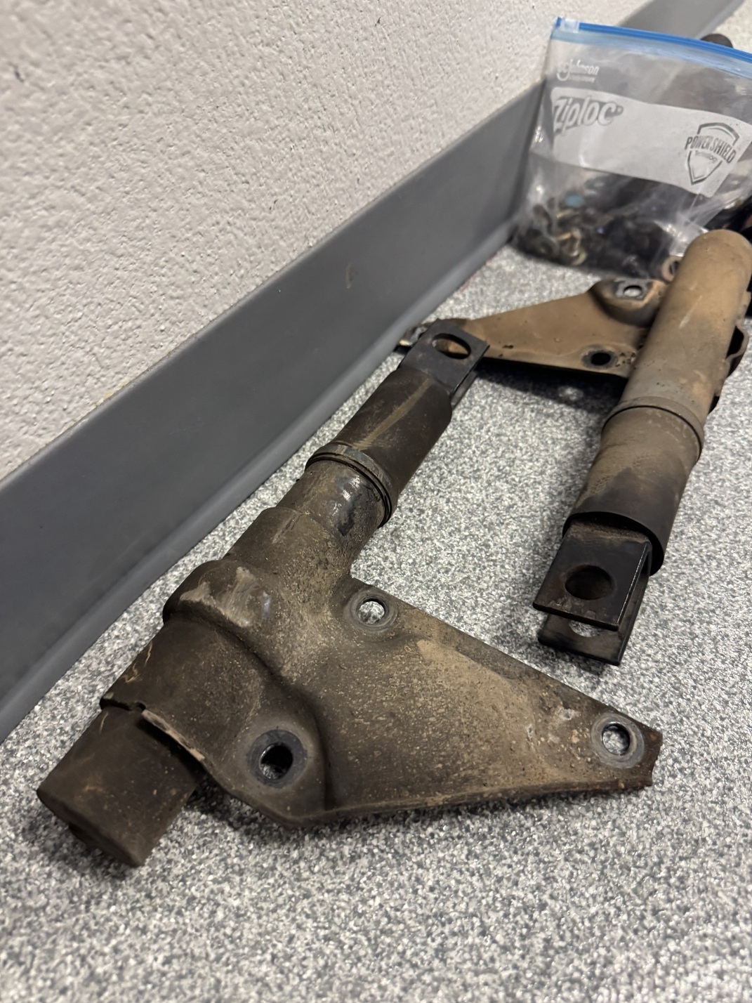

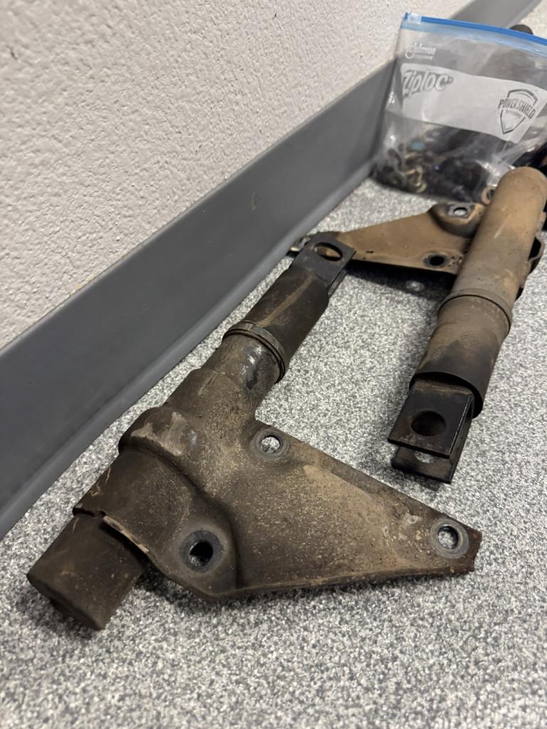

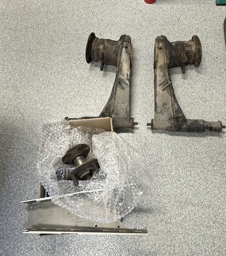

Here's a shot of the control arms after about 4 hours of disassembly. I will probably have Patrick MS put the 911 hubs in that you can see here, which I think are the correct hubs to work with my 901 914 side shift box, and maybe the custom floating axles from PMB. I think they are 69-71 911 hubs. I need to double check before i have them clean them up, put long studs in and press into the control arms.
The hardest part was the brake rotors were rusted onto the hubs. I had to drill out the little screws that hold them on for 3 of the 4 screws.
Otherwise, I'm enjoying my new battery powered impact gun. Up until this point I've been using hand tools for tough jobs or air power for impact when I occasionally needed it. Having the battery powered hand held impact has been a nice little upgrade as it saves a ton of time rolling out the compressor, hose and impact gun.
I'm also sending the control arm outer brackets to Patrick so that I can add the adjustable toe rod kit they have.

Has anyone installed these RD long reinforcements with the rear quarters still on?
post Jul 21 2026, 10:46 AM
Post #54
914-6 GT in waiting
Posts: 20,944
Joined: 19-September 09
Member No.: 10,825
I’ve never heard of them requiring the quarters being cut but I’ve never personally installed a set.

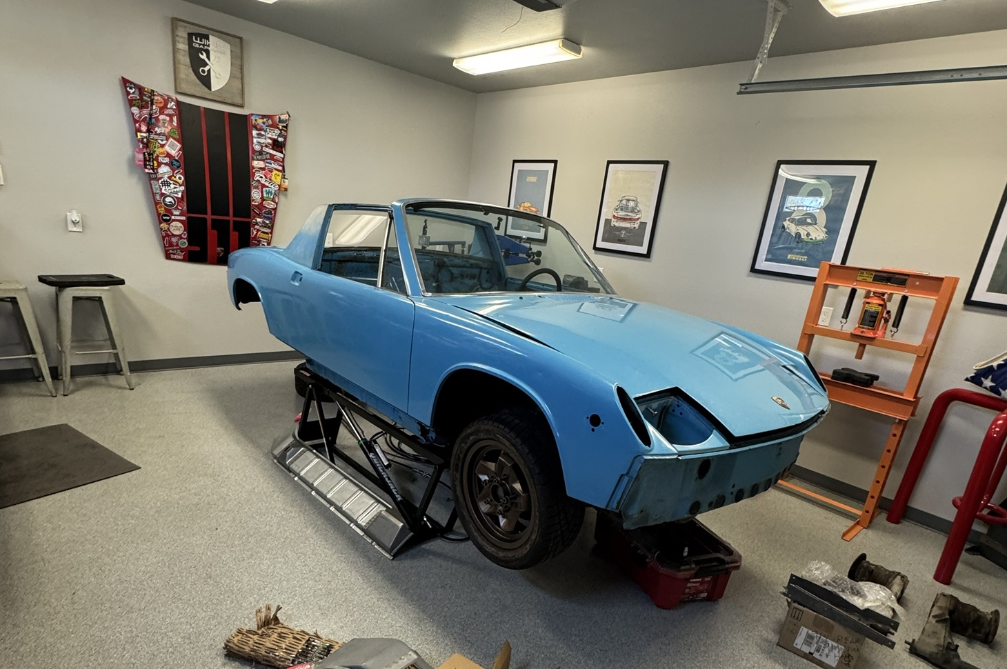

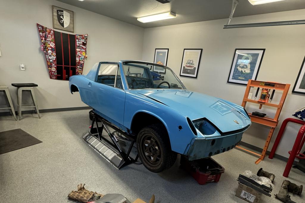

Well a fair amount of work completed on the 914/6 project in the last two weeks.
I removed the front suspension after mocking up the 5 lug 911 front struts.
My plan was to get front and rear suspension basically on so I could start the GT flare project.
That sort of morphed into a "let's find out if this body is straight" questline.
Two major things led to this and I'll start with the front end.
I was attempting to straighten out the front lip and noticed a lot of damage in the drivers headlight bucket area. The more I looked, the worse it got.
In short, I think the PO had a minor impact on the front bumper. It was hard enough that the impact shock kinked the support that is attached to the chassis on later cars.
As a result, the headlight bucket got pushed up. I'm guessing the PO then took a hammer and attempted to fix the front end as best they could, primarily to get the hood to close correctly. A couple hours with a spot weld drill and she's out:
I wanted to be able to get to that support piece and after really looking at the bucket I figured I needed to replace it. It was twisted up quite a bit.
I'll need to source a new headlight bucket and I have a couple leads.
Those of you who joke that you end up buying extra 914s -I'm starting to understand why. And that brings us to the second major issue that I found.
Both rear trailing arms are bent! Well this is what Patrick Motorsports told me.
I ended up taking my trailing arms there last week to get the full service of powdercoat, new bearings and bushings, adding the tow ring and boxing them.
My rep called me and informed me that both trailing arms are bent. I didn't ask how they verified this yet, but I'm guessing they have a jig that they use when they box the control arms and my arms probably were wonky when placed in the jig.
The rep did say they scored a bunch of 914 parts recently so they may have some good trailing arm cores. I was really hoping to save some of the cost with the core exchange, so this one hurts.
I don't doubt the PO was sliding around driving this car to the extreme, but after doing a search I didn't find much on bent 914 control arms. I read on another thread here you can put two 3' long bars through the holes and see if it's straight that way. I'd like to try that when I get my cores back.
PMS also said that someone had done some reinforcements or changes to the control arms previously.
I didn't notice anything but my reference photos before I dropped them off are lacking.
So now the plan is to strip the car to the body and take a lot of measurements. There is a Cellette Bench in town but it belongs to the most outrageous supercar paint shop here and they charge a fortune for anything.
I removed all the front suspension and also learned (shout out Evan) that the 914 front control arms are different splines than the 911. That's fine, I have a set of my 77 911 that I can donate to the 914.
I also removed the master brake cylinder and the corresponding front lines.
I removed the steering rack and column.
Next up is the E brake, and a few things to clean up in the engine bay. I think I might have the car blasted to bare metal. There's a company that specializes in the service so hopefully they wont warp the panels.
[/quote]
i dont see how. i am in the same spot, i will need to redo that entire area as mine is rotted out. and i plan to cut out a section of the quarter plus the overflare cut. just be delicate? lolzz
post Aug 1 2026, 12:50 PM
Post #57
914-6 GT in waiting
Posts: 20,944
Member No.: 10,825
You could always call RD and ask to speak to Peter. He knows his parts and how to install them.

QUOTE(mepstein @ Aug 1 2026, 11:50 AM) *
That's a good call. I imagine he would say just cut the RD part to fit. I can't imagine it's easier to cut the quarter around the bottom of the chassis.
Here's some more photos of the headlight bucket area.
I took a long look this afternoon at the whole area. I wanted to see if maybe they had pulled that entire drivers front fender off at some point. I concluded that it looks factory which I think is a very good thing. I'm debating on whether I replace the whole front panel as it's kind of a mess and pushed up as it meets the drivers fender on the end.
This support piece needs to be worked on. Not sure if I should pull it and replace or attempt to straighten it.

I checked in with Restoration Design on what to do with adding their long reinforcements, without cutting off the quarter, they said, cut the bottom loose and I should be albe to slide the piece up and under without removing the entire quarter.
I'll keep yall posted on whether that works and has enough flex without having to go up the side of the door jam as well.
I did end up cutting off the rubber baby buggy bumper hooks. I used a spot weld cutter and it was pretty easy work.
I did a lot more measurements on the front end. It's not bad, I think I replace the kinked metal in the support panels and I ended up ordering a new 71-74 front piece. It solves a couple issues:
1. No need to cut off the rubber baby buggy bumper lip at the top of the 75 front end.
2. Covers all the impact shock holes for me.
3. Is a straight and new piece that will help me align the front end and the drivers headlight bucket.
For $300 I think it was a wise investment. They already shipped it too. They are a great business. It's really amazing that we have access to these new parts.
I did end up mounting my GT bumper and stock valance in order to get another idea of how badly the front end is bent. It's not bad, but the most concerning thing is the bumper fitment.
It barely slides over the fenders. I'm wondering if someone who has done a bumper backdate can speak to how much gap there is here when you did it?
