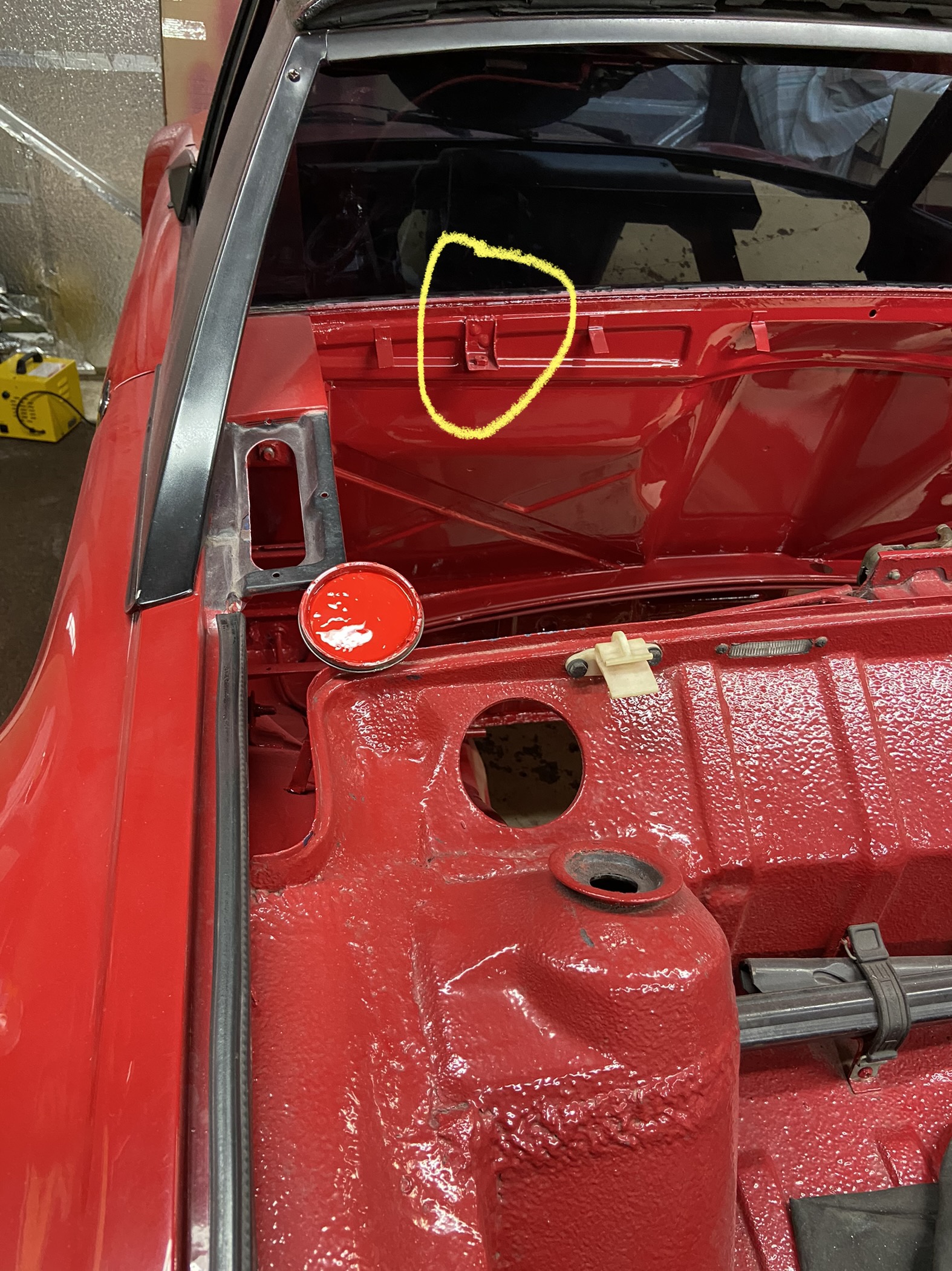

Most of us humans get saggy after several decades, but my engine lid will not stay in the upright position. All looks ok, I can't imagine the torsion bars lose their power?
TIA |

Superhawk996 Look at hinges - probably has broken spot welds an... Sep 1 2022, 06:52 PM
tygaboy Check the "L" brackets to which the lid ... Sep 1 2022, 06:52 PM
