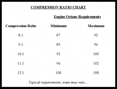

Likewise octane rating has nothing to do with power output on its own. Octane rating just allows for higher compression ratios (more power) and more timing advance.
You will not get more power running 93 octane in a 914 than you will get on 87 octane. Where octane rating comes into play is the ability to run more timing advance without getting Detonation that destroys engines fast! On a modern car timing is altered automatically in real time via the Knock Detection sensor(s). Timing try’s to run as advanced as the timing map will allow, if detonation is detected, timing is retarded until it stops.
On a 914 you can get more power (in some situations) by advancing timing. The problem is it is set there and can’t be adjusted in real time. If you start getting detonation and ignore it, piston melting, piston holes, etc come next.

Our engines don't really benefit from the higher octane as we are not generally running a high compression.

Here's a rule of thumb Octane/compression chart. FWIW, I'm theoretically running 8.2:1 compression as calculated by deck height (haven't measured directly) and it run fine on regular gas. I do run at high altitude though which requires less octane. I might have to bump to mid-grade if I ever drive down out of the mountains.
And just to complicate more, ethanol blend has more oxygen than pure gasoline so runs a little leaner.
