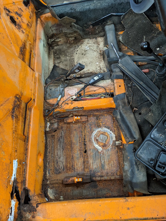

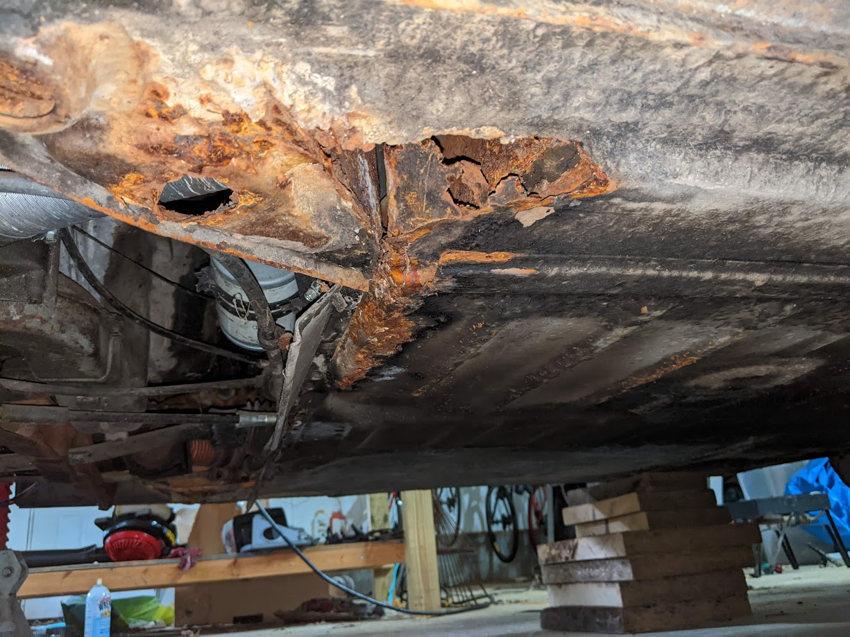

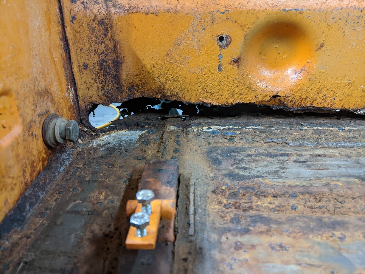

Hello all, I'm a bit new to this. I had one of these in my 20's and and did a little stick welding fixing the hell hole.
I'm not sure how to approach this. Do I need to strip all this and go on rotisserie? Or is it feasible to cut and patch this from the top
The driver side floor is bondo (or something). I'm not sure what is holding the seat mounts. The passenger side seat mount right is about broken loose. There's also holes past the transverse strut into the battery area.
The longs seem ok from what I can see. Can I get the sill covers off without taking the fenders off? I was worried I drill out all the rivets to figure one hidden under the fender.
Any good tool recommendations for rust removal?
I was thinking maybe I can get away with with https://www.restoration-design.com/store/product/PP345BR and a https://www.restoration-design.com/store/PR...duct_Code=PP325 and the seat brakets and patch the holes.

Superhawk996   Read these before you do anything. You have more ...   Sep 10 2022, 05:21 PM
SirAndy   You have more project on your hands than you think...   Sep 10 2022, 05:57 PM
bbrock   You have more project on your hands than you thin...   Sep 10 2022, 10:30 PM
Mikey914   If you choose to do this sure you have a brace in ...   Sep 10 2022, 06:10 PM
930cabman   Welcome aboard and it looks as though you are jump...   Sep 10 2022, 06:32 PM
mepstein   :wttc: The rust you see is always the tip of the ...   Sep 10 2022, 07:53 PM
bkrantz   Jump (gently) up and down on the right side and wa...   Sep 10 2022, 08:28 PM
