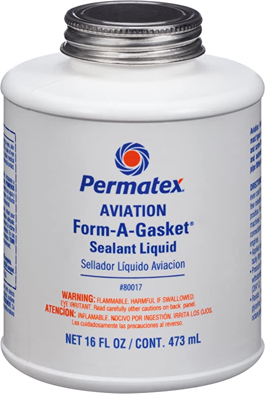

So, I have read several posts and watched several videos to do with engine rebuilds. I am wondering what people recommend for the engine case sealant. In Jake Raby's video, he used Aviation gasket sealer, which I have used on other applications with great success.
That being said, this is my first type IV build, so I am seeking input from those who have done their own builds. I would like to know what you used, why and pros and cons.

Yes, good old fashion Permatex Aviation Gasket Sealer.

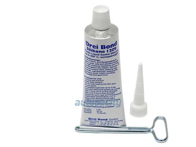

Drei Bond
(IMG:http://www.914world.com/bbs2/uploads_offsite/media.autoplicity.com-1143-1662983074.1.jpg)
Like 914Sixer, I used Permatex gasket sealer when I rebuilt our Super 90 engine. It seems to have worked fine, but it has only run on an engine stand.

(IMG:style_emoticons/default/agree.gif) quick effective simple. no need to complicate things

Looking at the article that @DennisV linked, it seems the test isn't whether they seal the case so it doesn't leak (seems they all do that pretty well), but whether the residue can contaminate the engine and possibly clog an oil galley. Looks like the Loctite and Aviation Sealant are the winners there.

Thanks everyone for your input. Ireally appreciate it. Looks like a toss up between the 574 and Permatex Aviation. I have used the Permatex on other items and found it very user friendly and leak proof. So I guess it depends on availability of the 574.

Permatex Aviation is the old standby.
