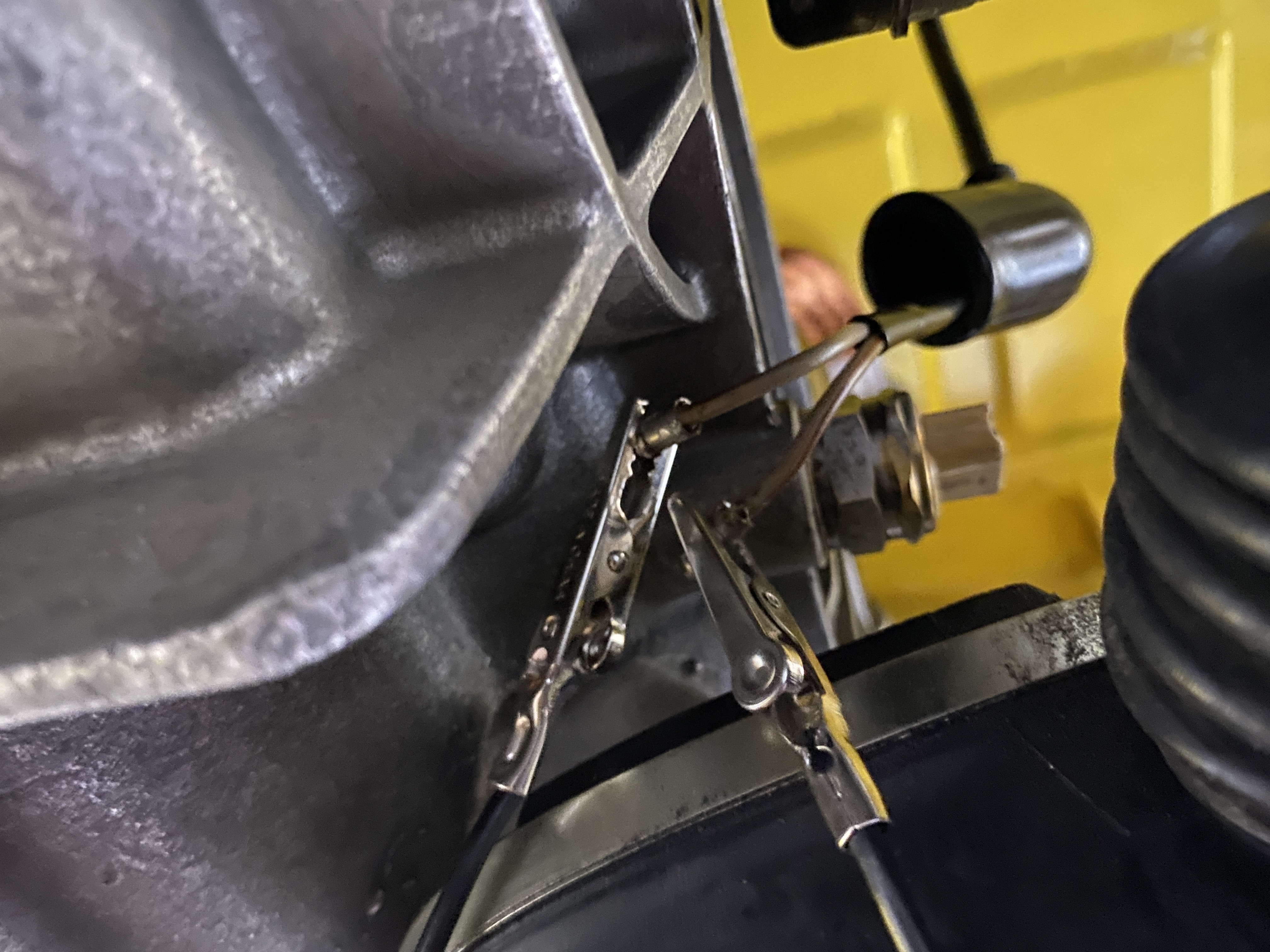

Can one of you transaxle gurus tell me if removing the reverse light switch will let the lube out? My switch seems to be bad.

I was able to make it work. The switch checked out, and the pin action was fine, but did not project into the switch enough to close the circuit. The trans rebuilder had used a thick spacer/washer under the switch. I swapped that out and the pin triggers the switch.
