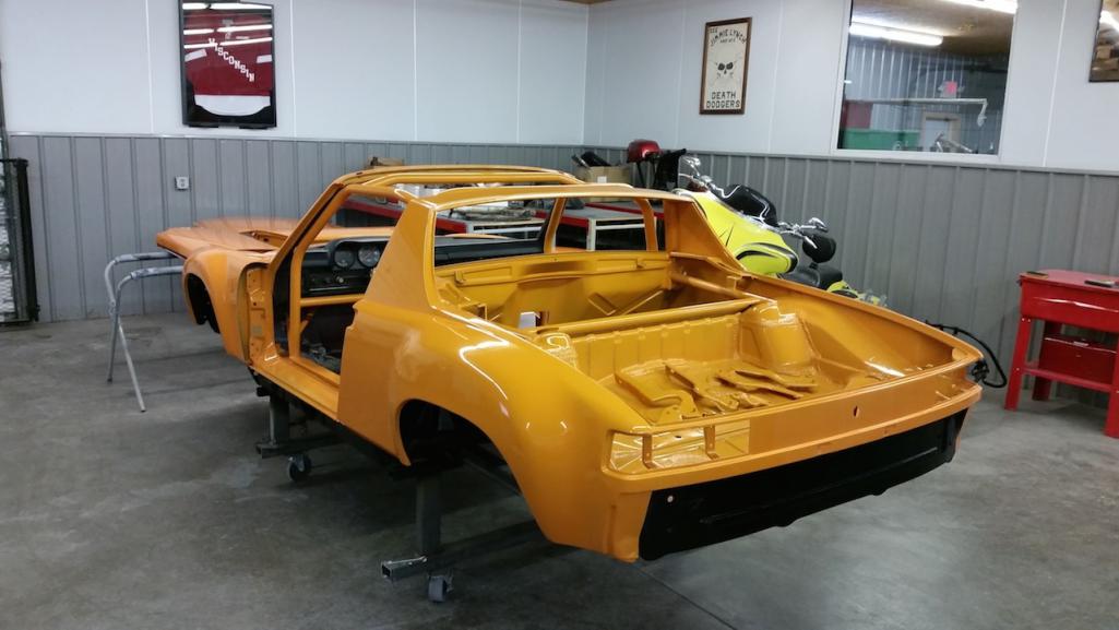

It's (of course) the prep that costs the bulk. I had my 914 painted with some body work done for about $11k. I did 98% of the metal work and repair. The shop did a bit more welding and shaping, but it was minimal. The work was mostly removing crap paint, shape, skim, flat board etc. prime, paint, cut and buff.
I wish I would have spent a bit more time on door gaps before sending in. The shop painted all lids off, both trunks and door jams.
Keep in close contact with the shop, remind them of your budget with each contact. Also remind them there is no rush as long as the project stays within budget. Oh yeah, remind them again to stay within budget.
(IMG:style_emoticons/default/wink.gif)
Post 120 shows the shops progress:
http://www.914world.com/bbs2/index.php?sho...4276&st=120
Turned out very nice.

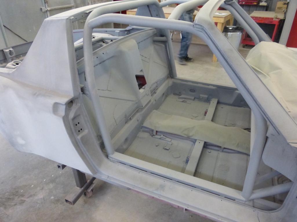

It took me a year and 1/2 to get a hot-rod builder to agree to finish and paint my car. His estimate was 5 to 8 thousand....but it came in at $10,000. Very happy with the results. MarkAttached Image Attached Image

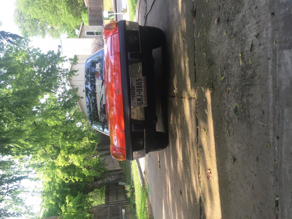

Raising kids I didn't have the money for a proper job. At the time I was looking at $6-8k paint shop bids.
So,
I have a rattle can paint job that's 4 years old and it's just now showing a little age. 100's of hours (lost track) taking things apart and filling dents and sanding - about 4 months worth. 3 coats of Duplicolor gray primer, sanding, 3 coats of color, sanding, 3 coats of clear, sanding. I spent about $400 in paint and another $300 in supplies and wore out several pair of jeans using a a plastic and PVC pipe booth, with a/c filters on fans for venting. So, you can do a respectable job until you're really ready to spend the big bucks.
I'm looking at a new professional job over the winter months. I've looking into some local shops that rent out the booth to their employees, as long as their painter does this on the weekends when they're closed. So that's another option to look at.
