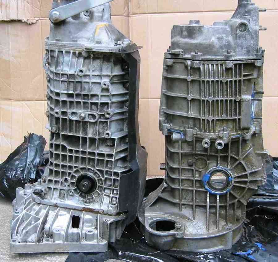

Andyrew   THat renault trani is HUGE!!!   Aug 18 2005, 03:01 PM
neo914-6   <...   Aug 18 2005, 04:40 PM
