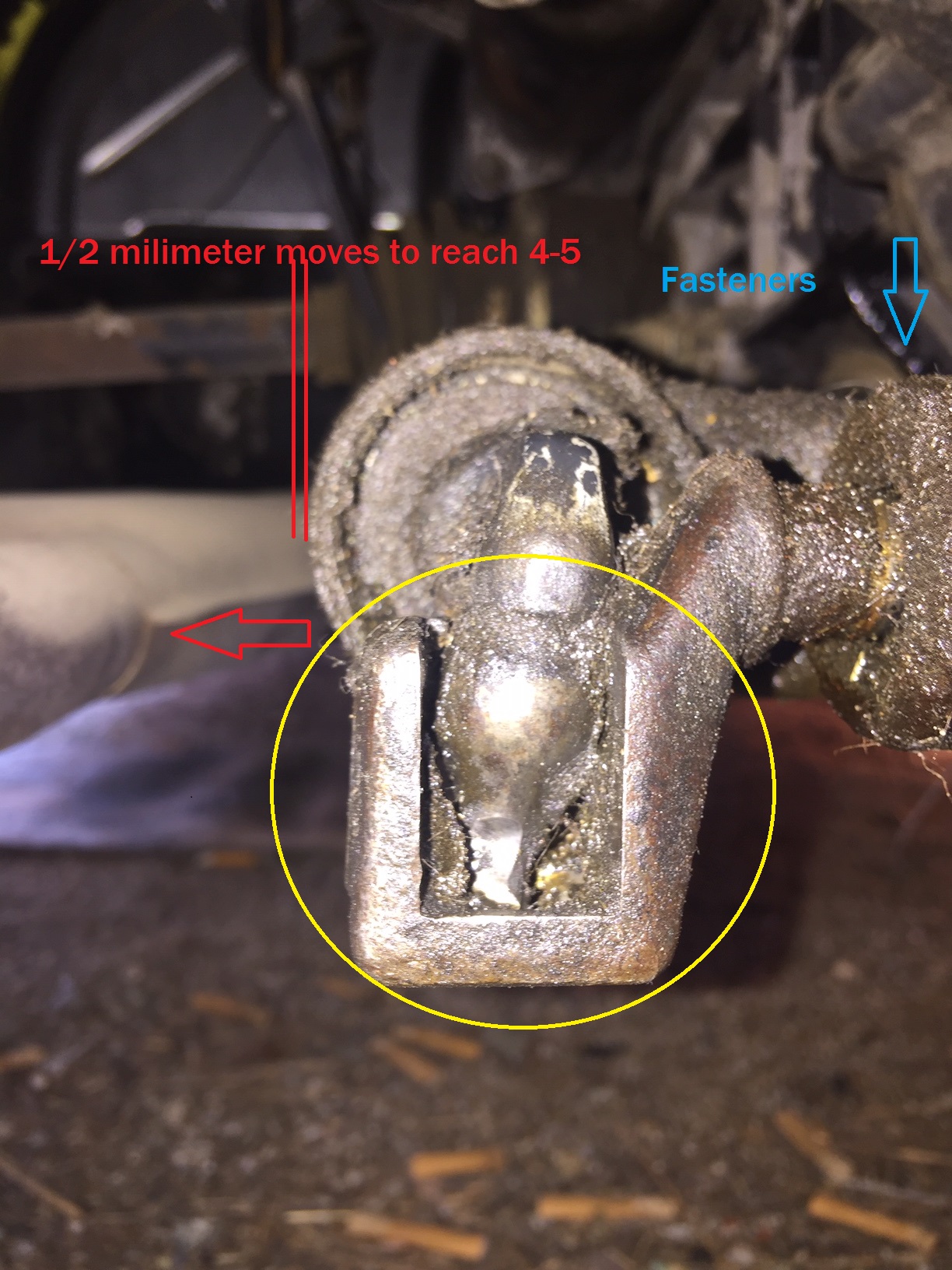

So new oener here , messing with my 1972 car , i have noticed that i dont seem to have 4/5 gear , i did mess and i ended up loosing Reverse , so am starting to lose the will to live lol, is there a guide on setting up linkages ? i also notice my shifter doent seem to go to the right much also, not sure if thats part of the problem ? but too travel left its got loads and its springs back also ?

emerygt350 Are you playing around with the adjustments in the... Sep 17 2022, 09:19 AM
rhodyguy Failed roll pin in the assembly above the rear acc... Sep 17 2022, 11:20 AM
PCH Is your gearbox a rear shifter? Just got mine shif... Sep 17 2022, 02:03 PM
rjames How are you adjusting it?
If bushings are good, f... Sep 17 2022, 02:35 PM
Shivers My 72' is a tail shift. If yours is stock the... Sep 17 2022, 04:06 PM
tonybolony wow thank you for all the response , its all new t... Sep 18 2022, 03:18 AM
emerygt350 Try checking the cone screw where the rod enters t... Sep 18 2022, 04:35 AM

ChrisFoley There are two plastic balls in that location which... Sep 18 2022, 05:46 AM
rgalla9146 Adjustment is done at the rear of the tunnel. Remo... Sep 18 2022, 08:58 AM
Shivers Sorry about the dirt and grease. Been parked for a... Sep 18 2022, 09:55 AM
Dave_Darling You might also use a mirror and flashlight to chec... Sep 19 2022, 03:08 AM![]() ![]() |
