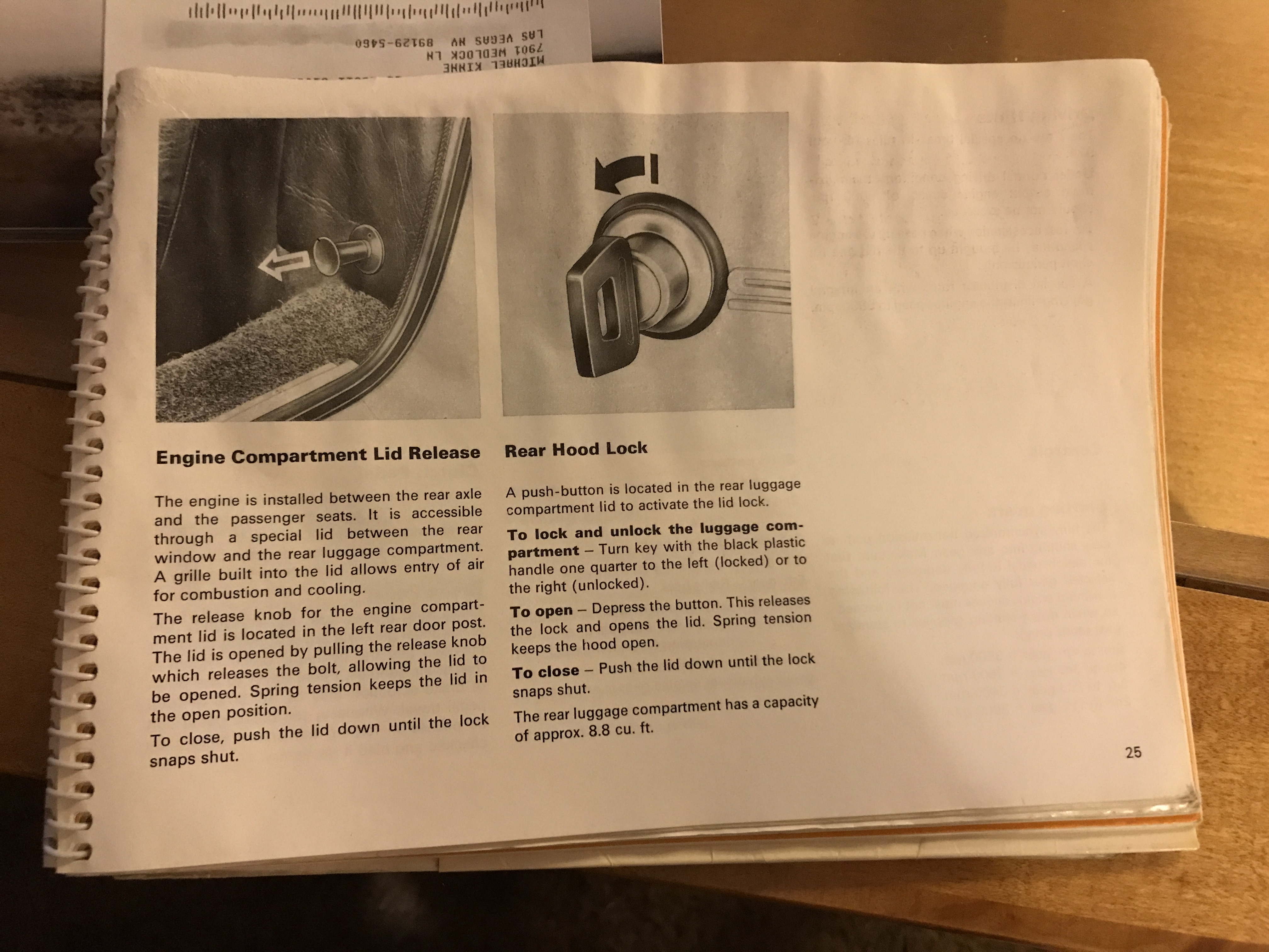

It was pointed out to me at the RRC my key direction was incorrect. I installed horizontal = unlocked and vertical = locked. Is that right or should it be the other way around?

Edit. It's been a long time since l installed one so l went out and checked it out. The lock assembly only goes in the body panel one way. With the key in the vertical position and the actuator to the top is unlocked. Turning to the left to horizontal will lock it. With the key vertical, and the actuator to the right(9.00) it will be locked. Turning the key to the left again will unlock it.
fter installation. Get a flashlight and look before shutting trunk. The actuator should be almost touching the release lever, not to the side of it on the

Thanks @thecabinetmaker , Curt,
I figured the guy who does all the keys and locks would know.
I just reoriented the actuator. Vertical is unlocked (pin up pushes the trunk release), turn left locked (pin pushes nothing and is locked).
Mike

Guess I should have just looked at the owners manual.
Mike Attached Image
