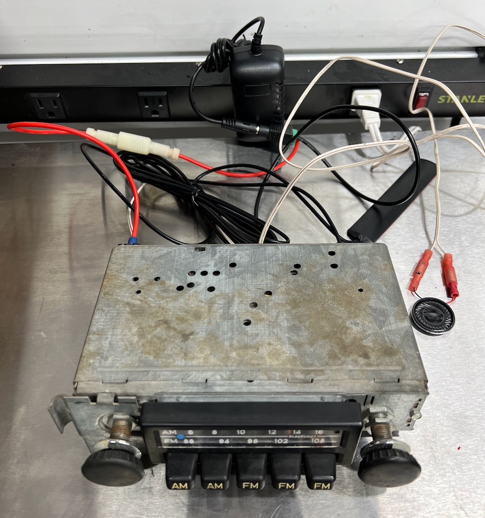

I have a couple old radios now, and I didn't know if they worked. Despite very little electrical knowledge I came up with a ~$20 bench test rig that requires no soldering, no car battery, and no multimeter. Maybe this will help someone else. Details on my blog.

Even if you don't want to listen to radio via the analog waves, you can still confirm that the radio and internal amplifier are working. Then plug your mobile music player into the aux port. I believe a 6-pin DIN (male) to 3.5mm adapter would be all you need for the Frankfurt.
