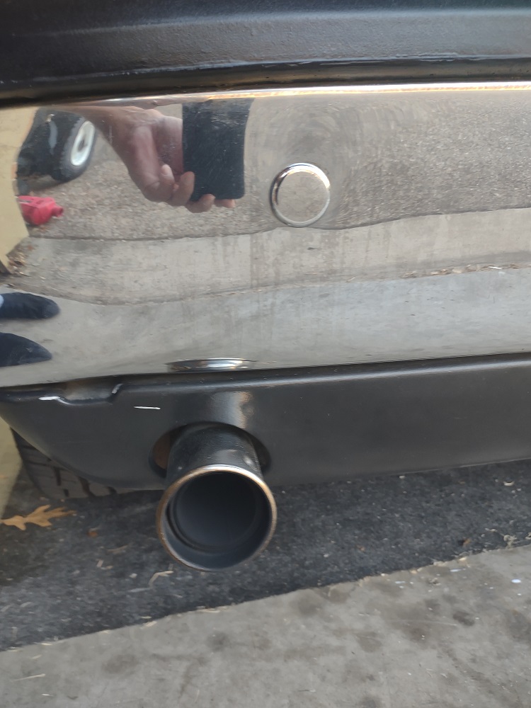

Can anyone tell from the photo if this is the correct rear valance for a 914-6? I am referencing the Restorer's Guide to Authenticity, but the angles in the photos make it a little hard to tell. The text says
The four-cylinder car had this hole (tail pipe) several inches inboard of the 914-6 opening.
Given the condition of this valance, maybe we'll go for the M471 look (i.e. no valance). (IMG:style_emoticons/default/biggrin.gif)

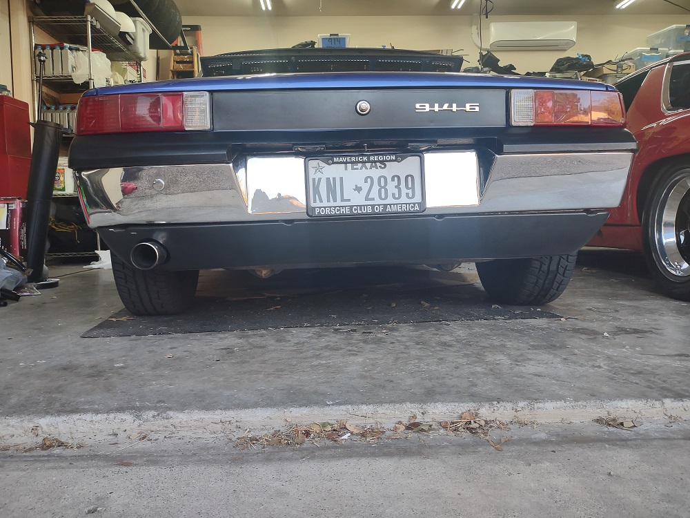

I just took this picture of our 70 914-6 with a NOS rear valence that we bought for it. It was the correct part number so I know it is a 914-6 valence. I tried to get the same angle as your car.
If you look, the right side of the porthole lines up with the tow hook hole.
Here is a closeup for you.
For the cost of a real six porthole valence (and I am NOT saying how much we paid for the NOS one (IMG:style_emoticons/default/pinch.gif)), I would suggest getting that one fixed. It is worth it, and a good body man can make it right.

Also, you have a later model bumper on it. The early sixes had a sharp corner on the license plate opening. The early bumpers are hard to find.

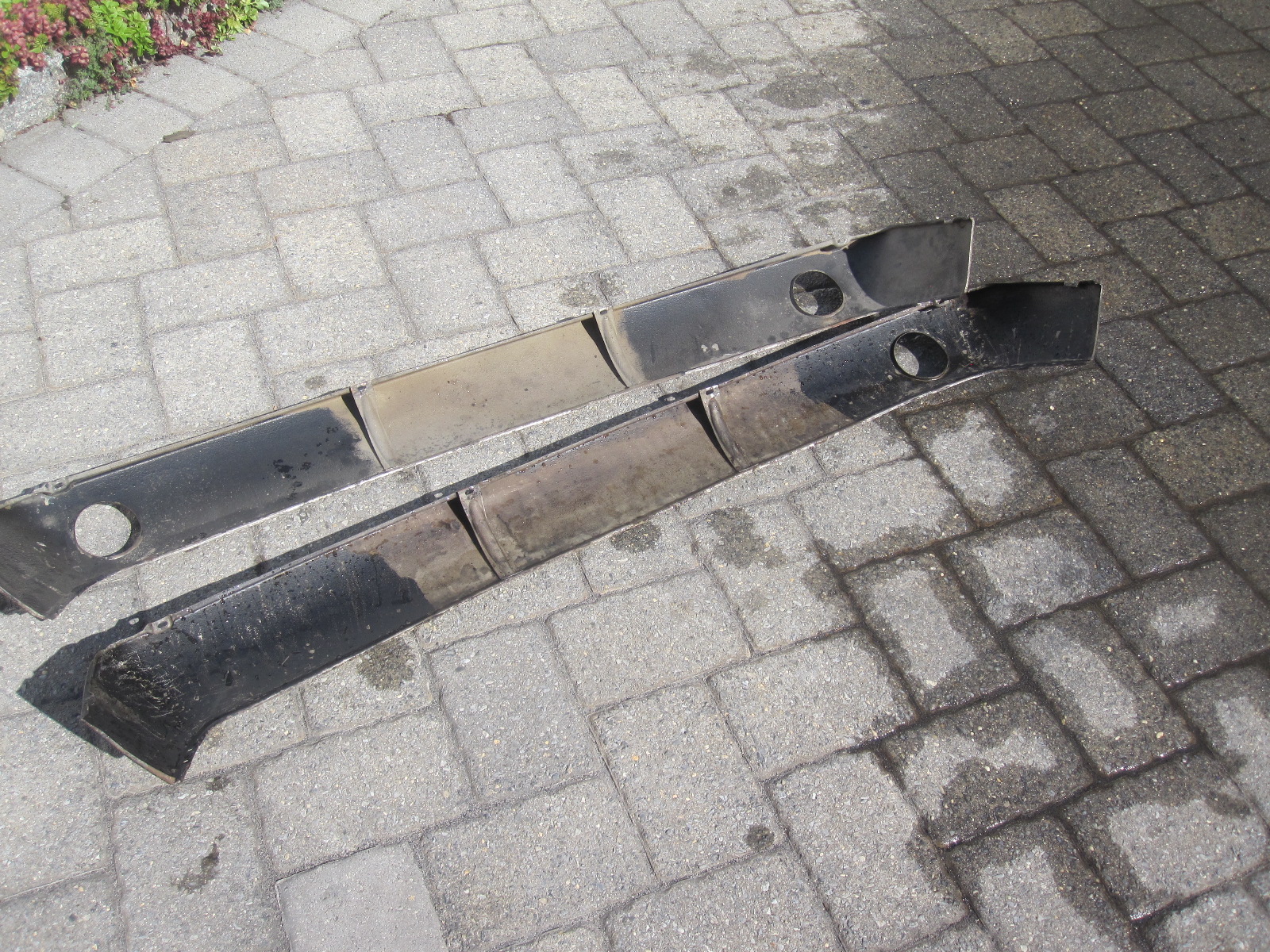

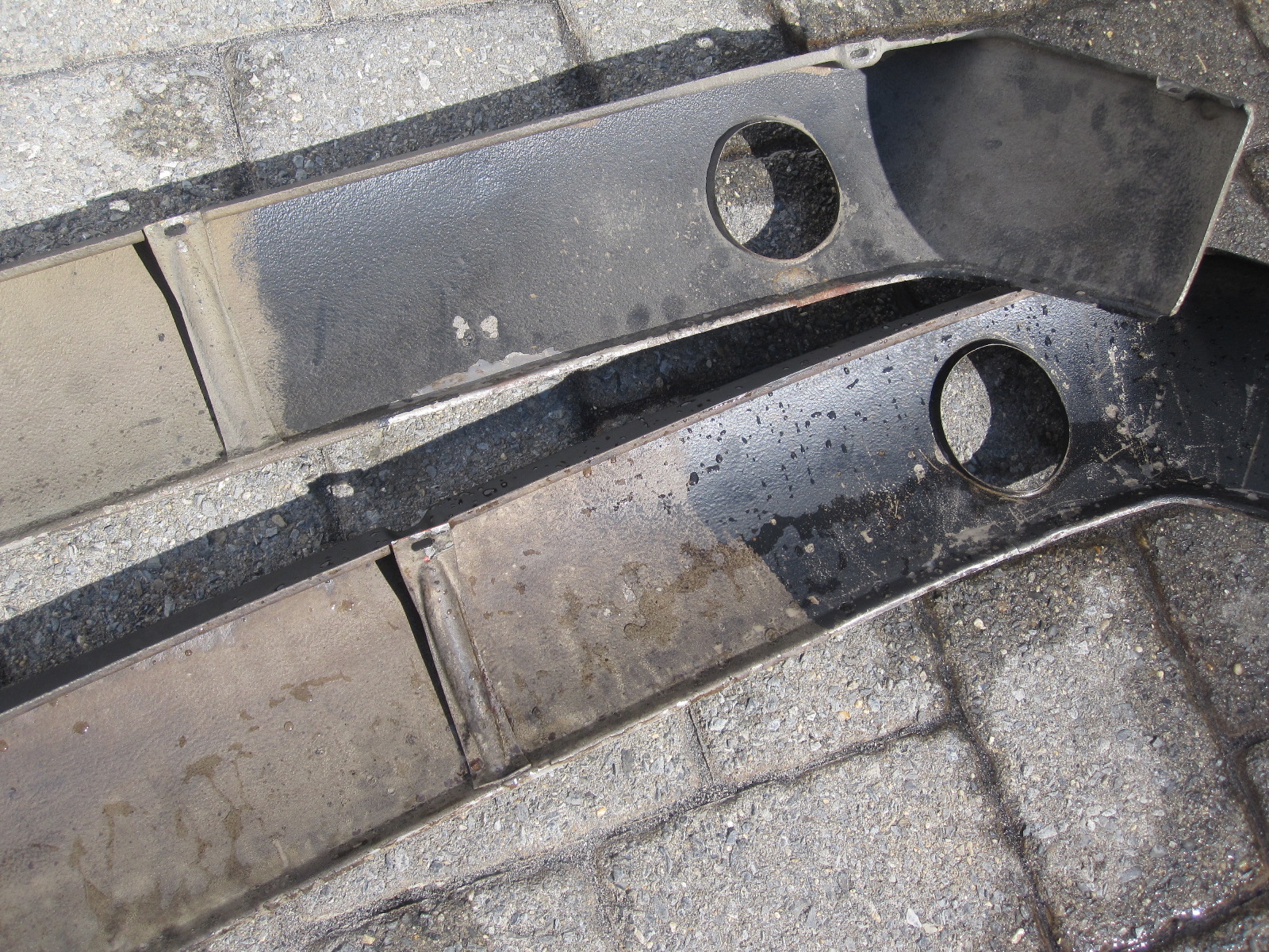

@DennisV
take a look here:
Valance difference

It doesn't look like the current PDF parts catalog distinguishes. I only find "rear apron" 914-503-009-10.
I am aware of the bumper. Between that and the primer on the valance, I'm guessing the car either backed into something or was hit from behind. It bugs me, but I am biding my time given that decent examples cost several hundred dollars and I've got plenty else to work on.
@gms Thanks for that link. Measurements always help!

That is a 6 valance. Hard to find. As for the rear bumper, they changed from the hard edge to the smooth transition mid-year ‘71. My 6 is a late ‘71 and came with the smooth, later rear bumper. (IMG:style_emoticons/default/beerchug.gif)

Allow me to save face with a small rear valence observation.
Original (factory fitted original) valences were sprayed with an undercoat type
material on the inside at both ends.
I've seen it on more than the ones pictured.
One of those pictured has had a right exhaust hole added.....unfortunately
