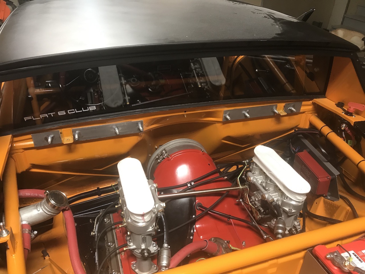

I have both the engine shelf and tin. But for better engine access I had the top angle portion of the trunk wall removed when rear suspension support was added. MarkAttached Image
