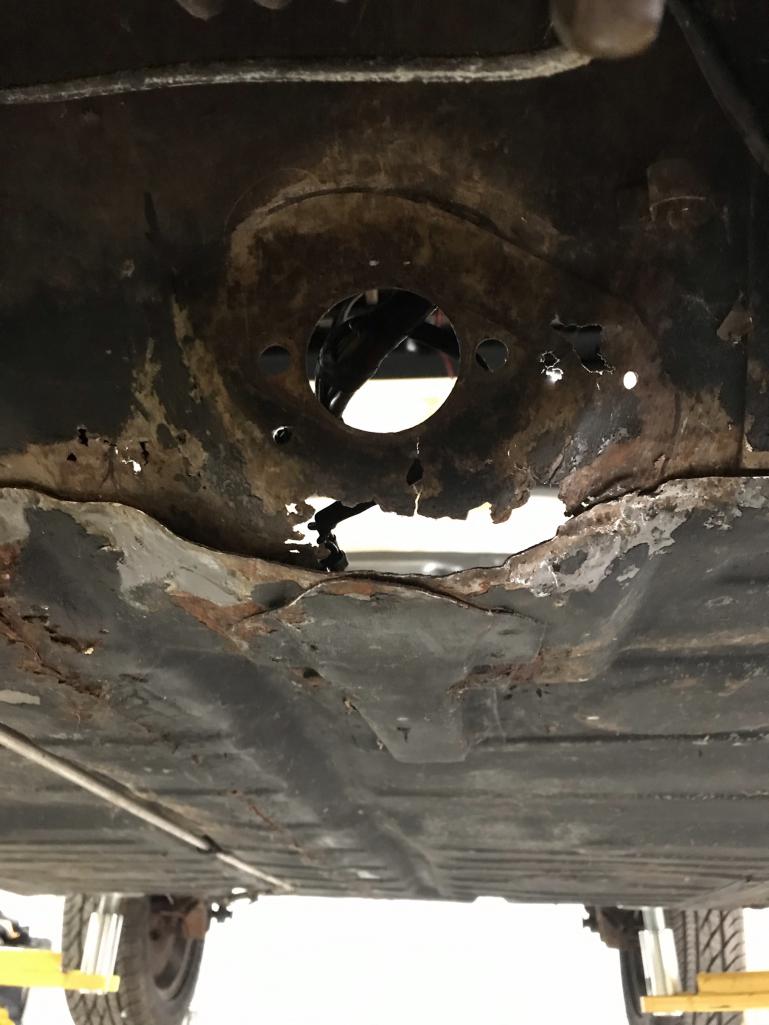

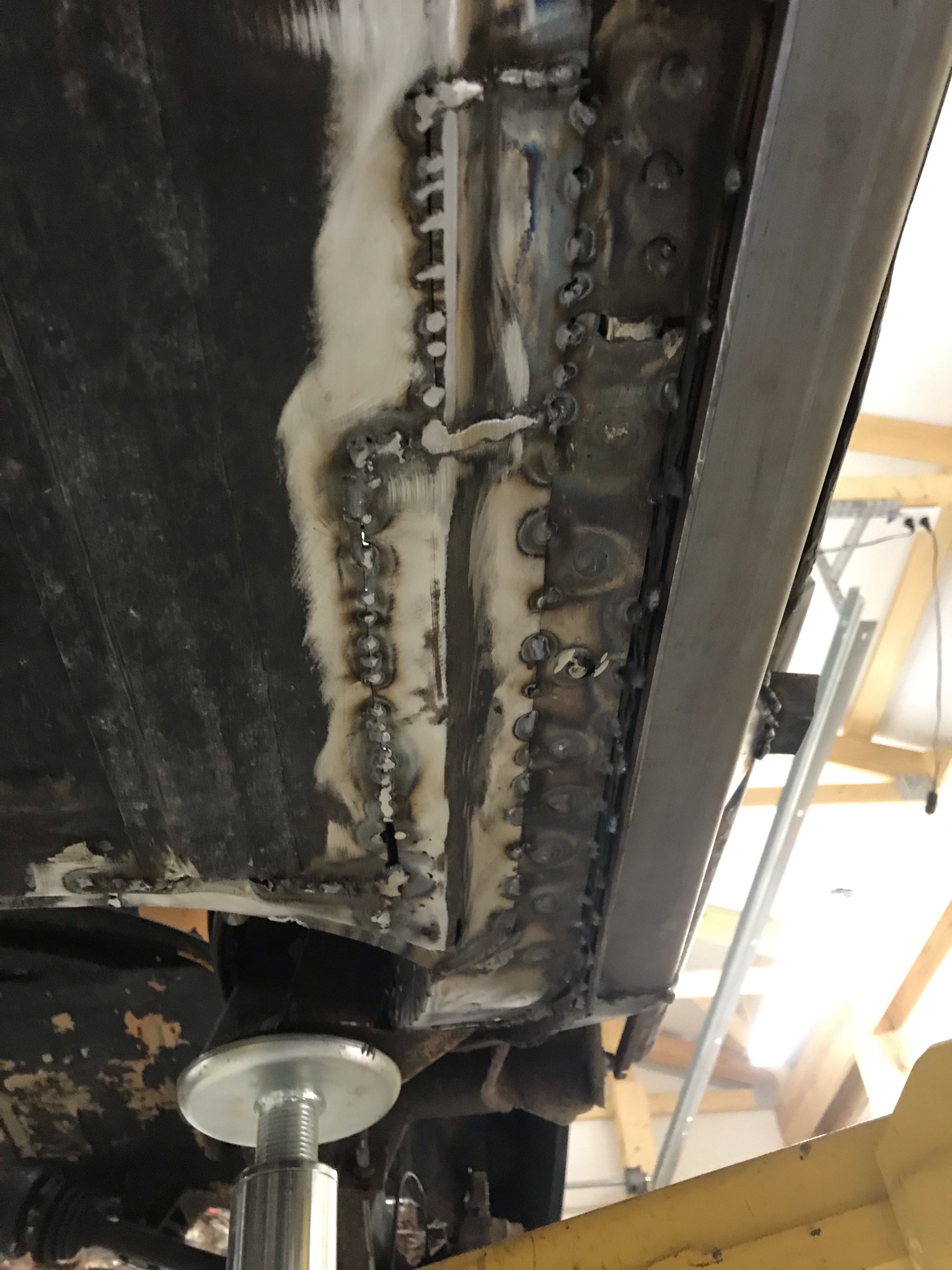

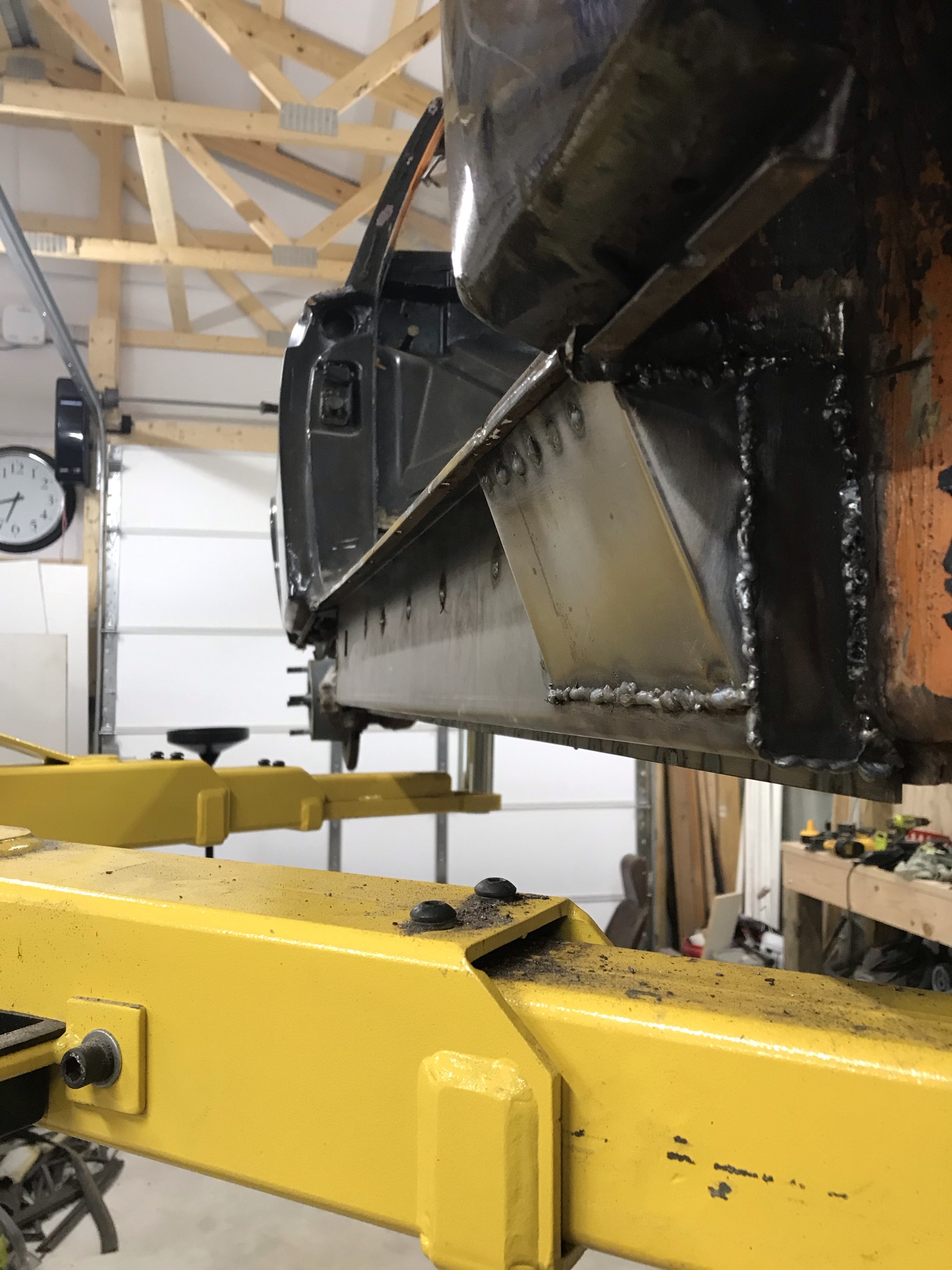

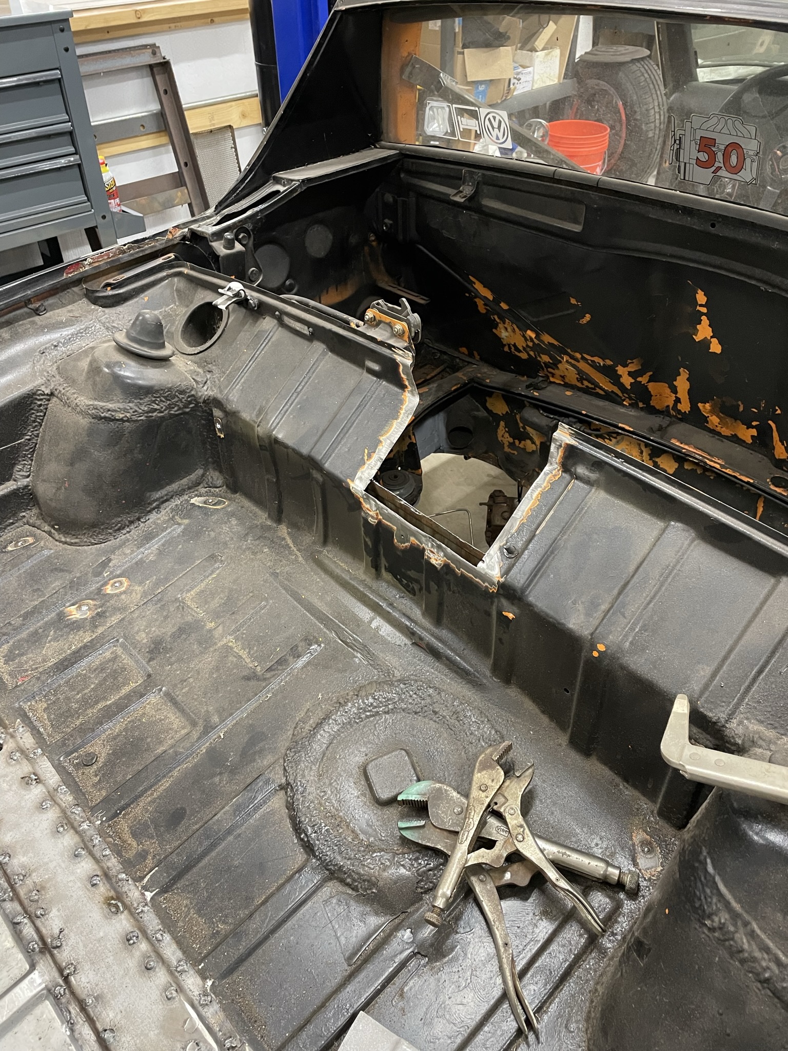

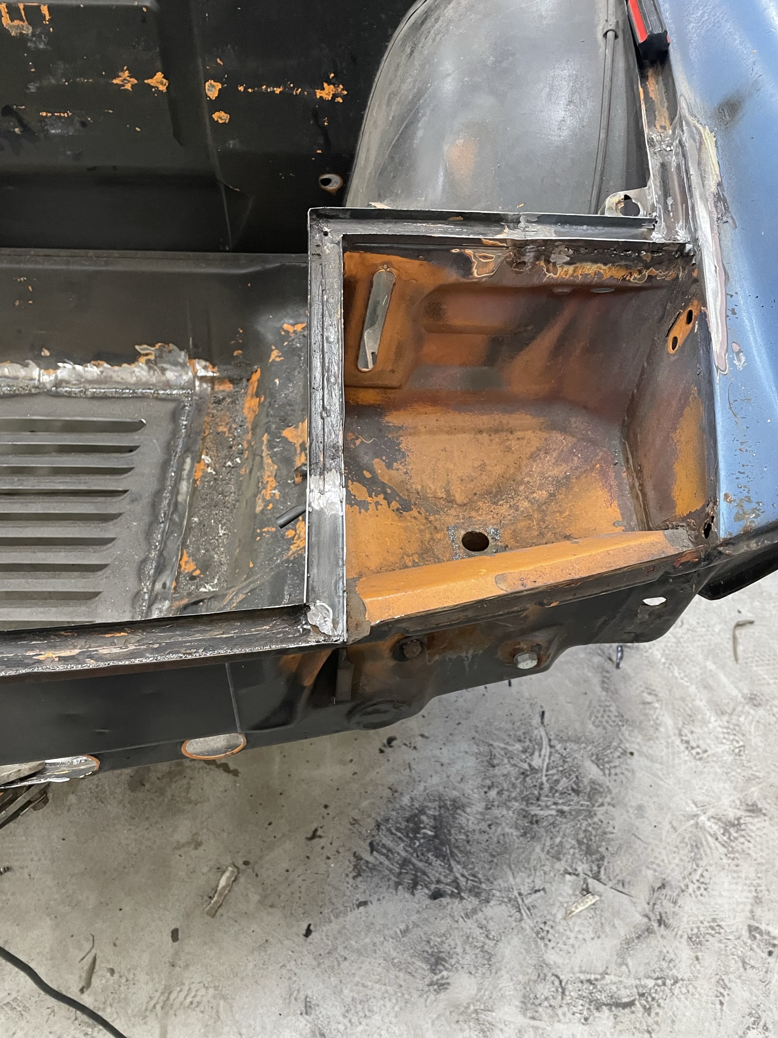

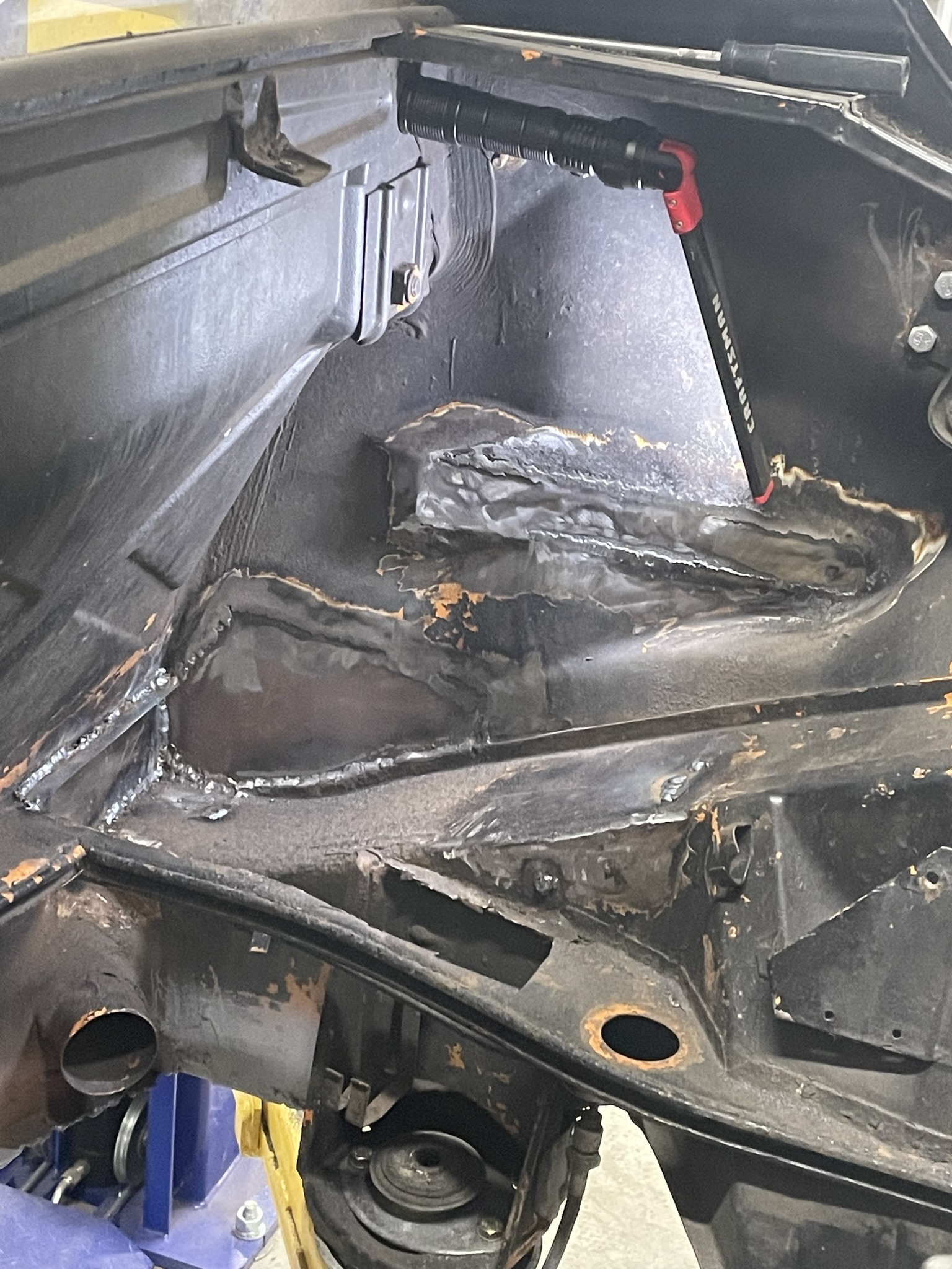

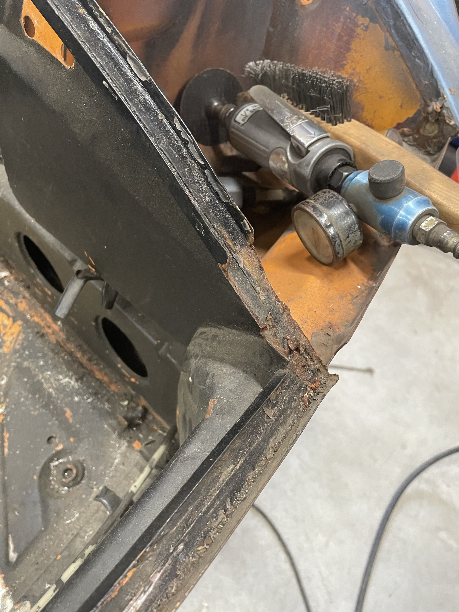

I stripped it down and sold the engine and tranny (it was a partially completed V8 conversion). Then started cutting out rusted areas a welding in new metal.
Some Radom rust repair pics in no special order….

Attached Image [

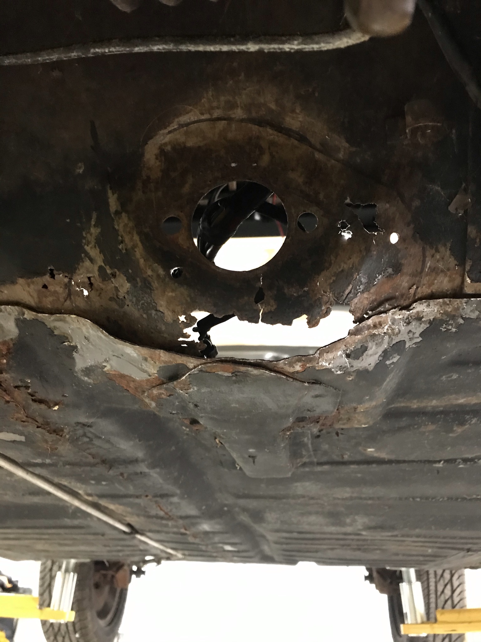

Hell hole
attachmentid=856763]

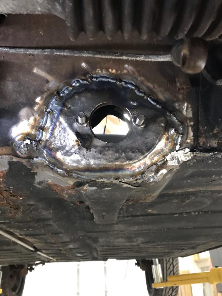

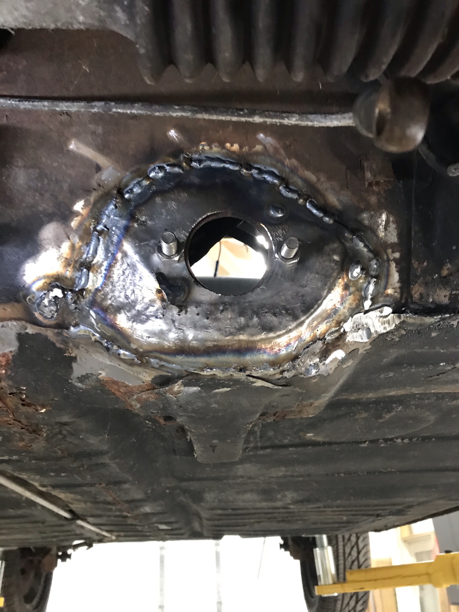

Closed up the tell tale V8 mod

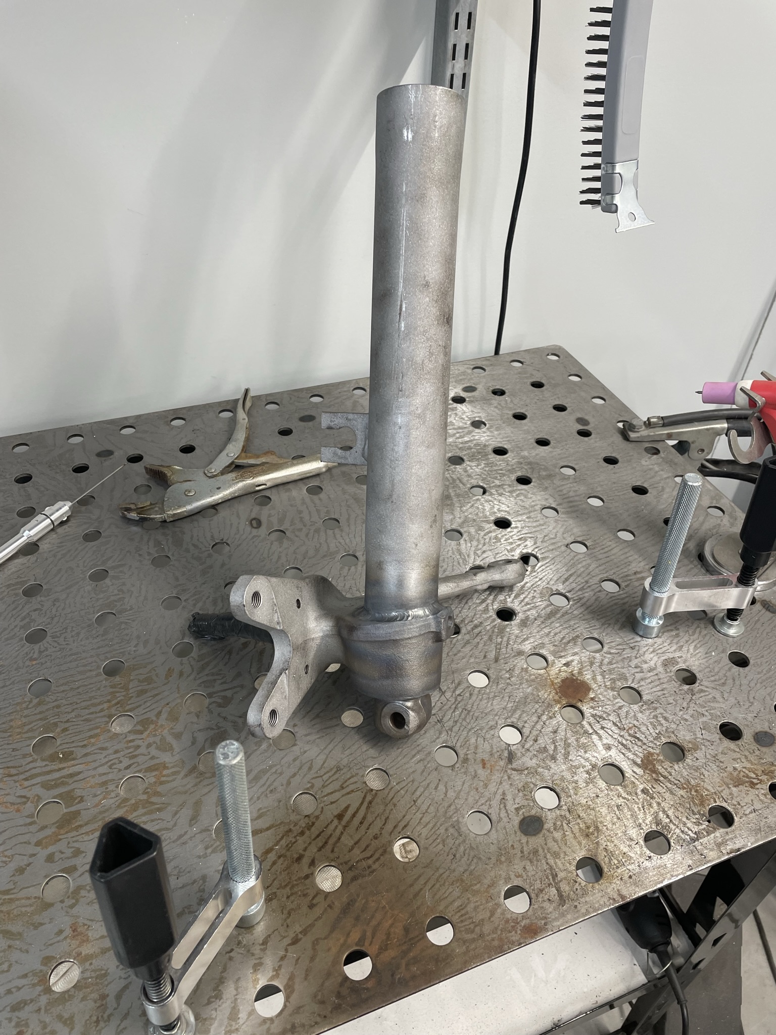

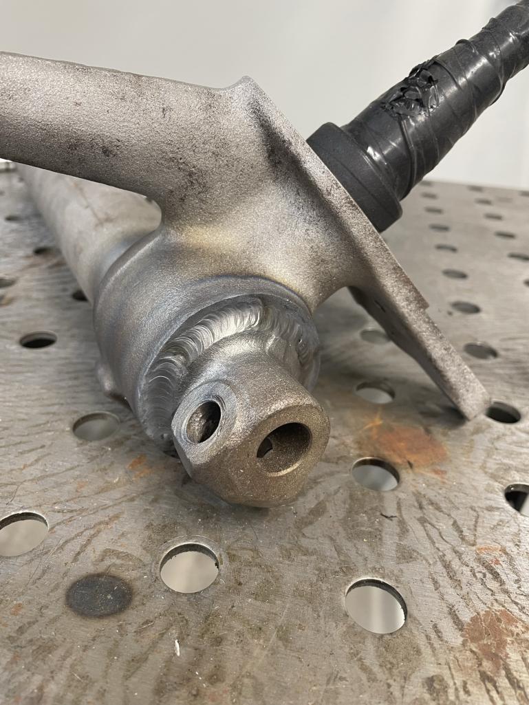

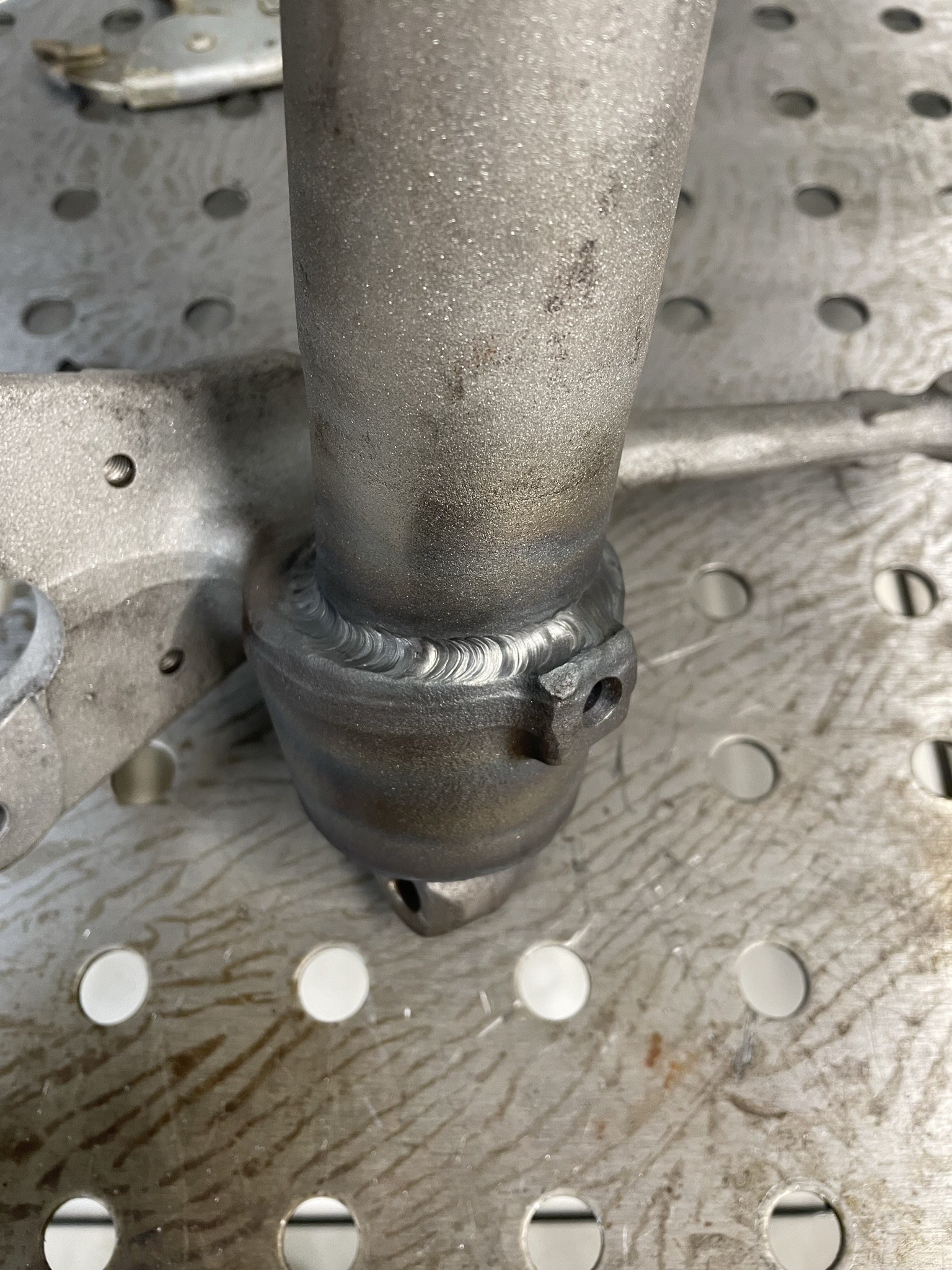

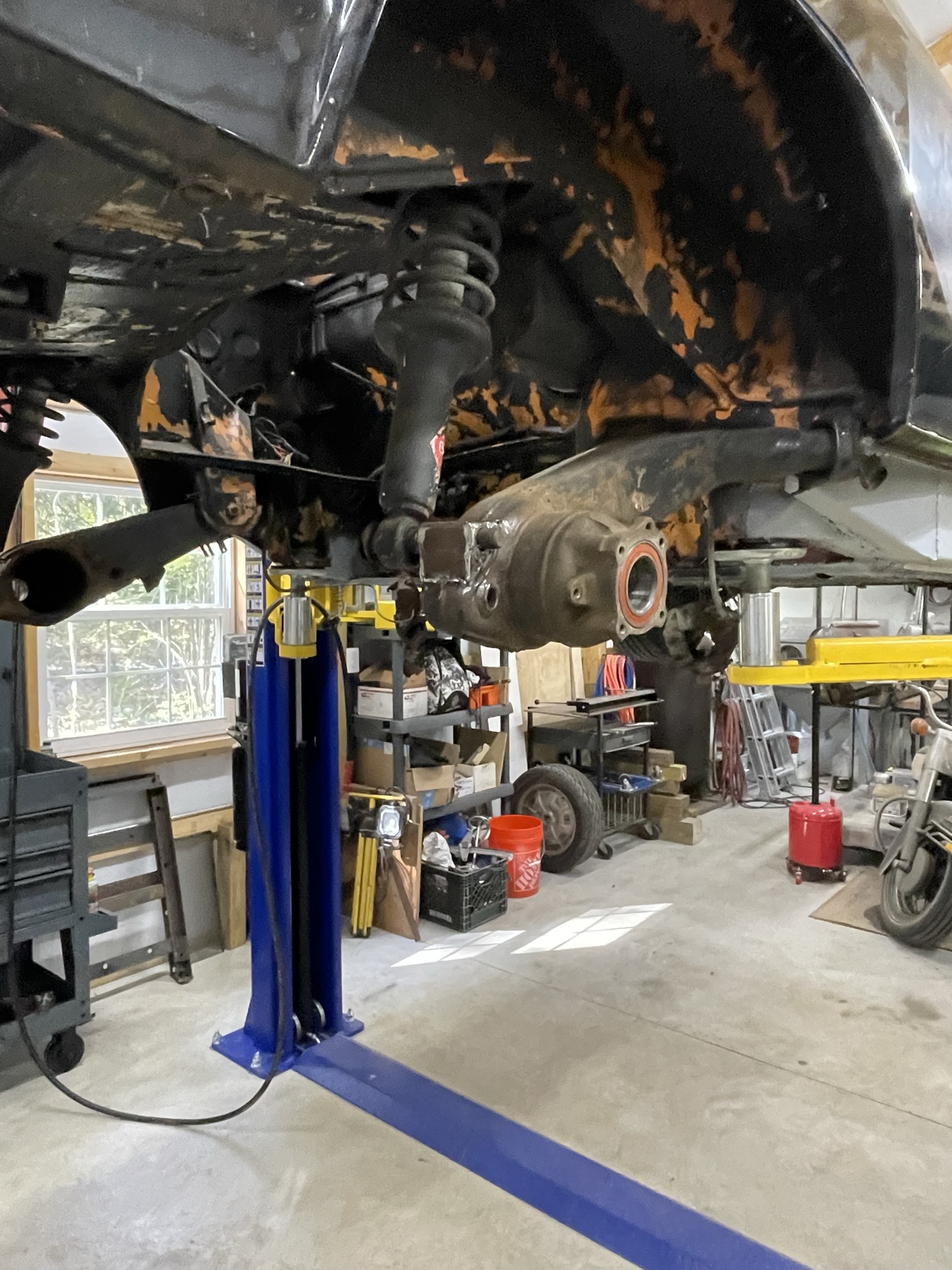

And moved on to some suspension fun……aka Safari lift
Raised the attach point on the rear trailing arms by 2”
Then moved to fron struts and lowered the spindles to the max

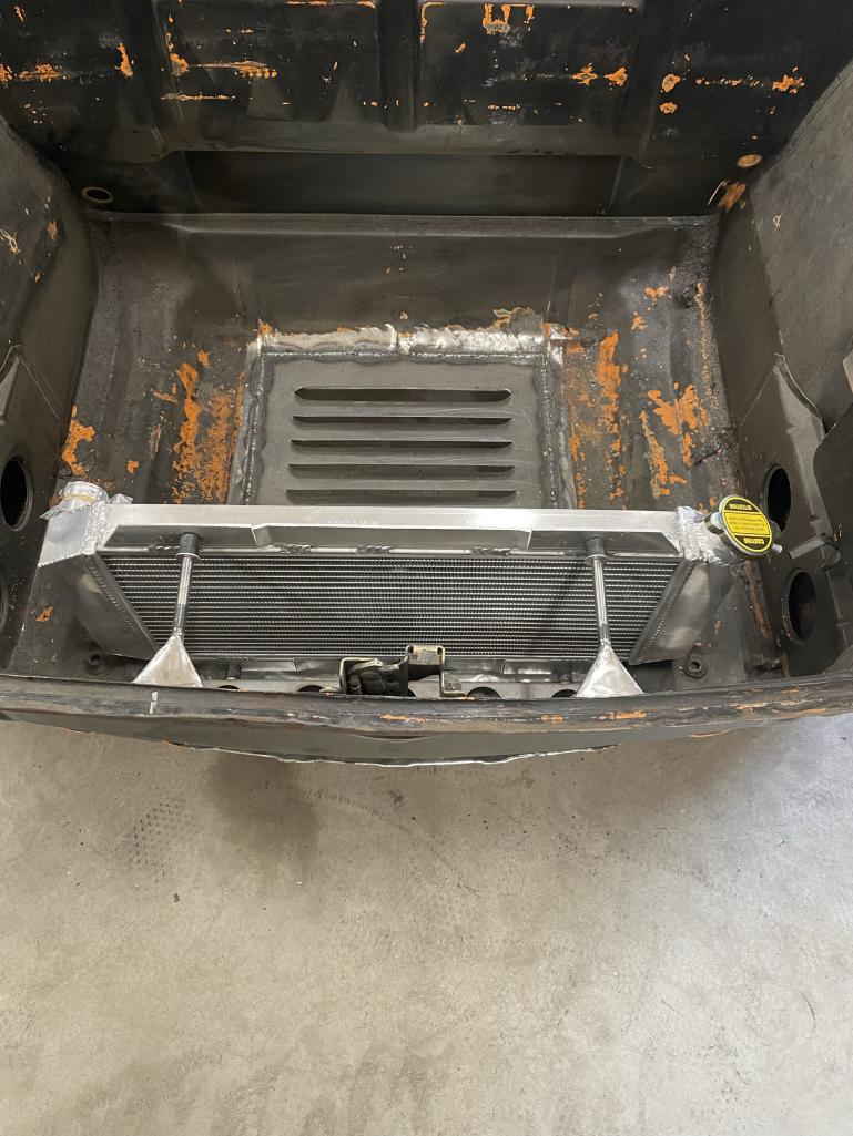

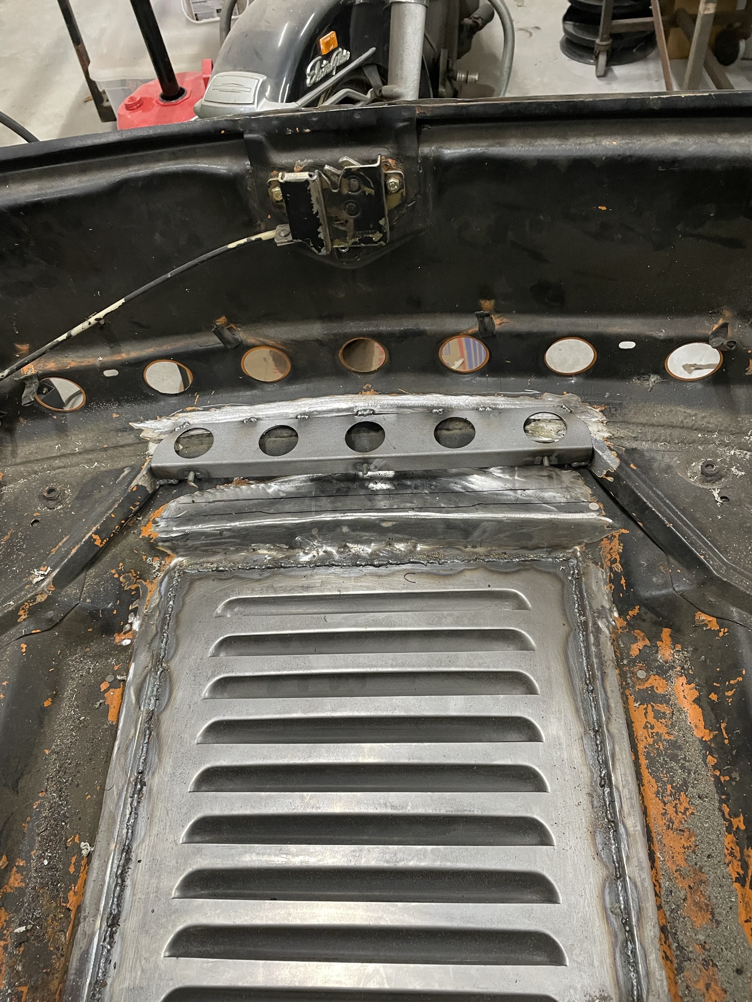

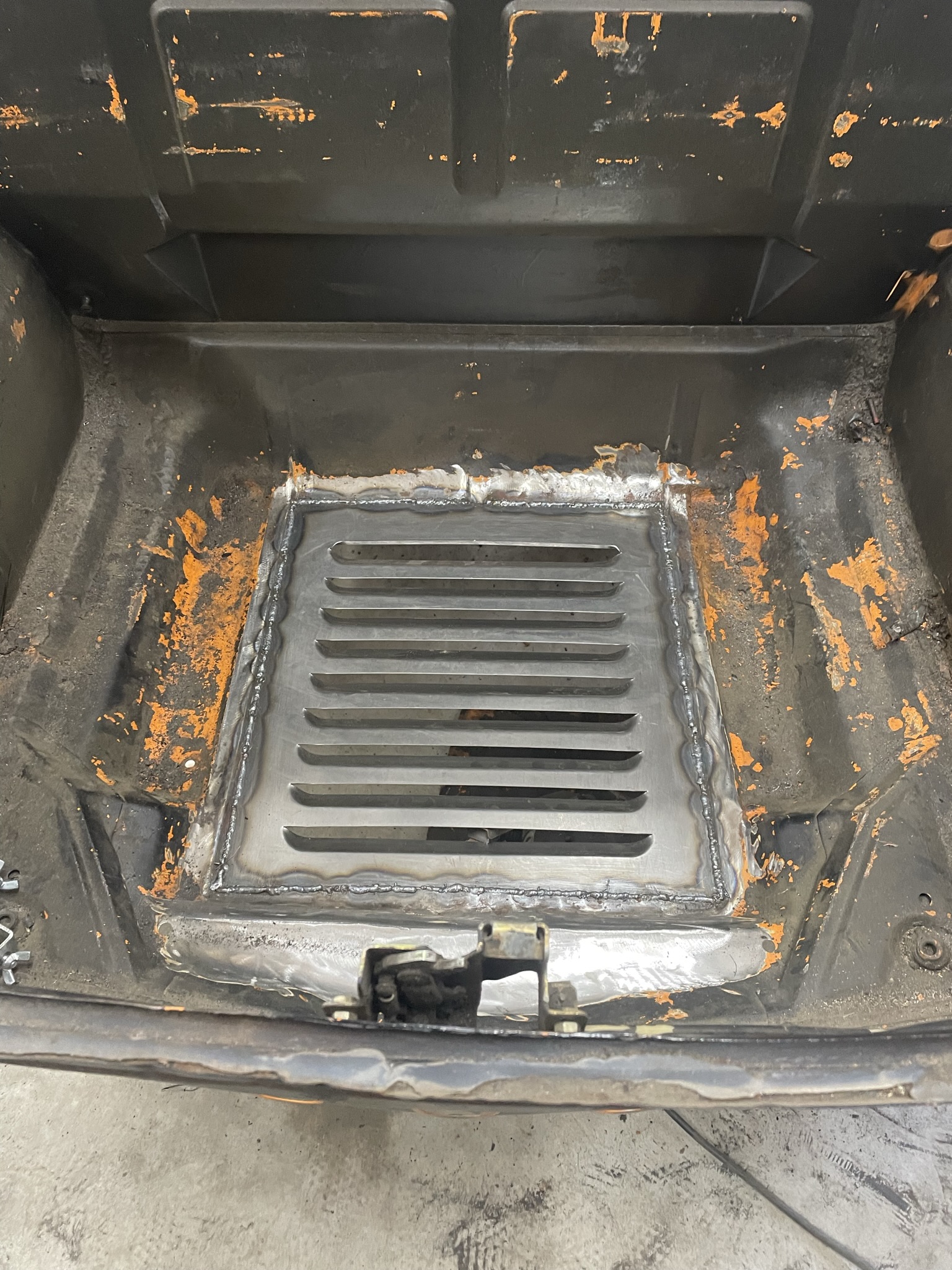

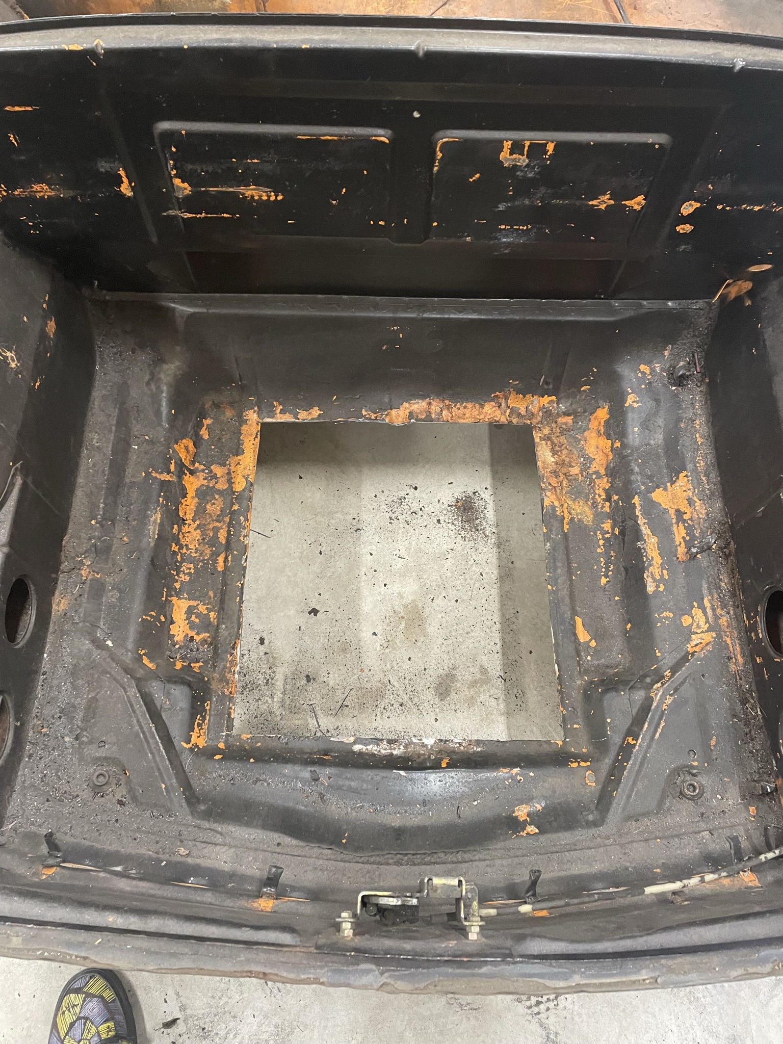

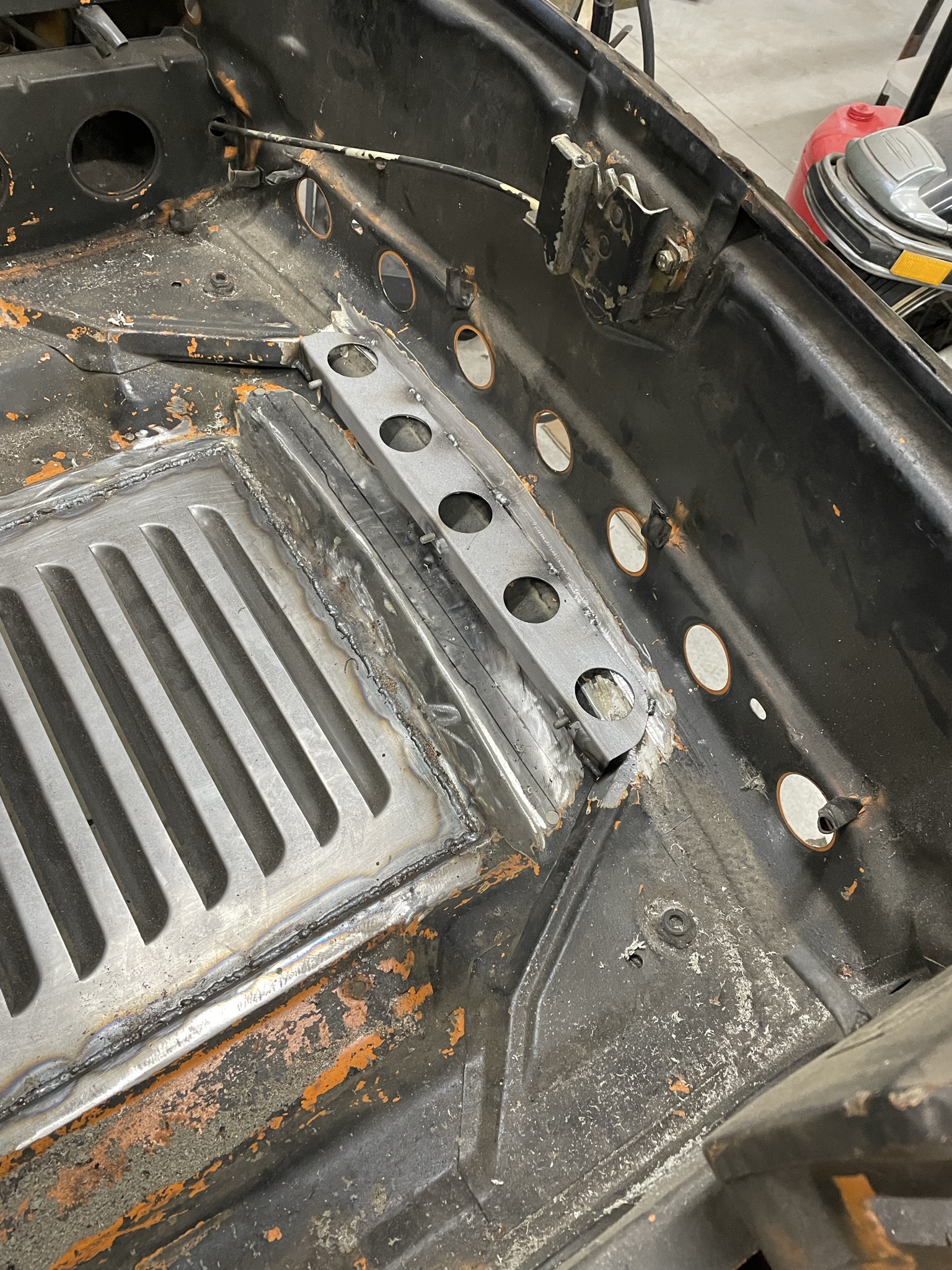

Working on the radiator install. I plan to vent out the bottom, but with the air ducted rearward. So I started by cutting a big hole….
Then filled the big hole hole with a louvered panel from a VW Bus

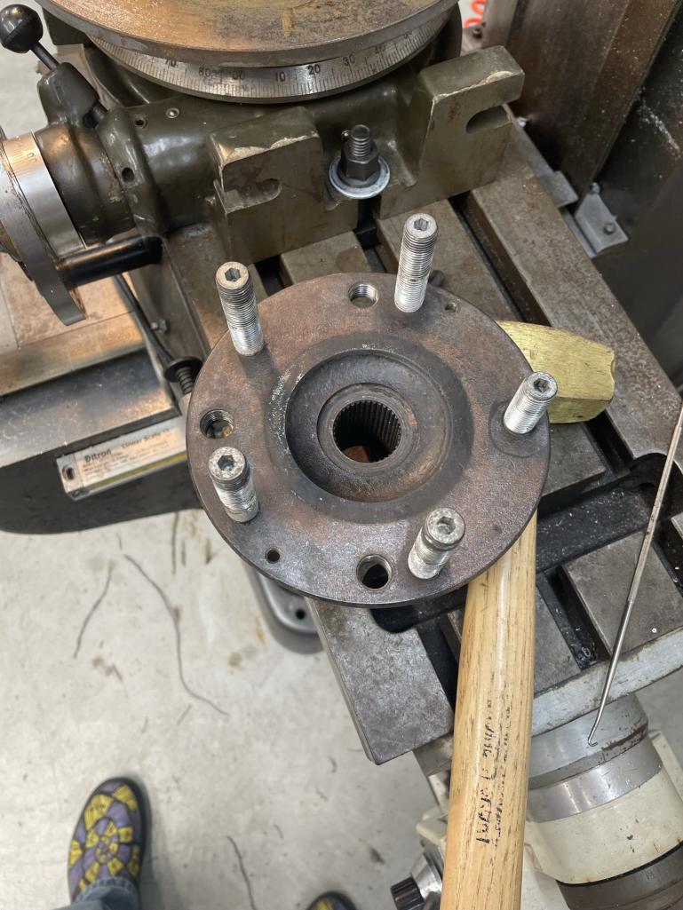

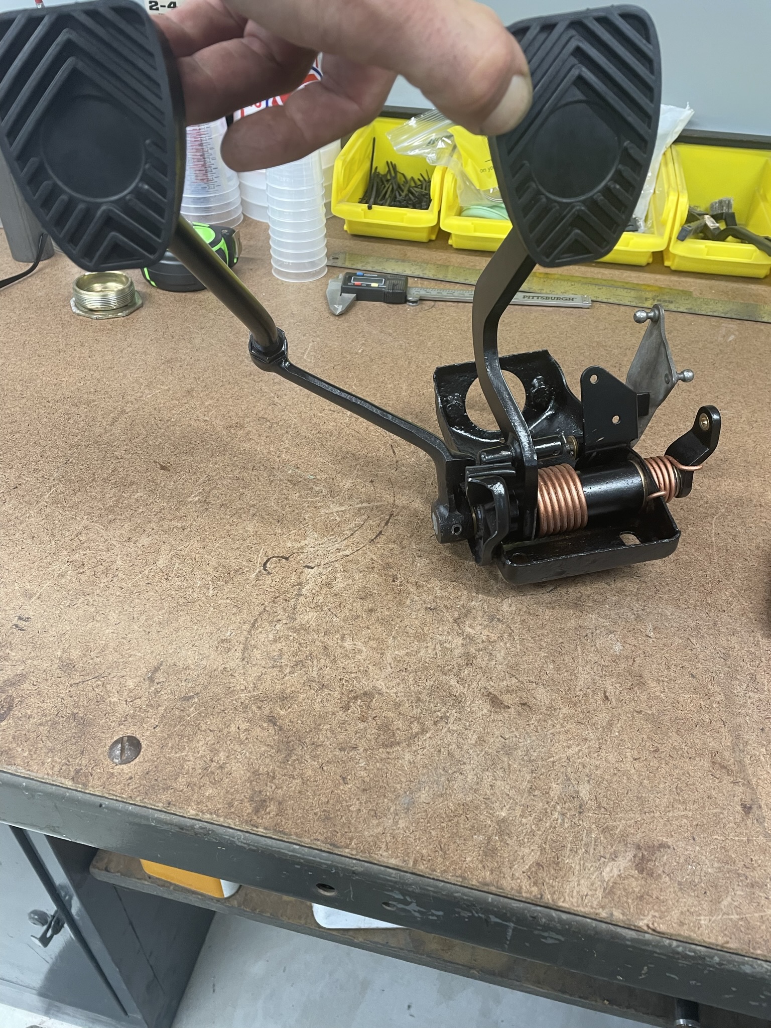

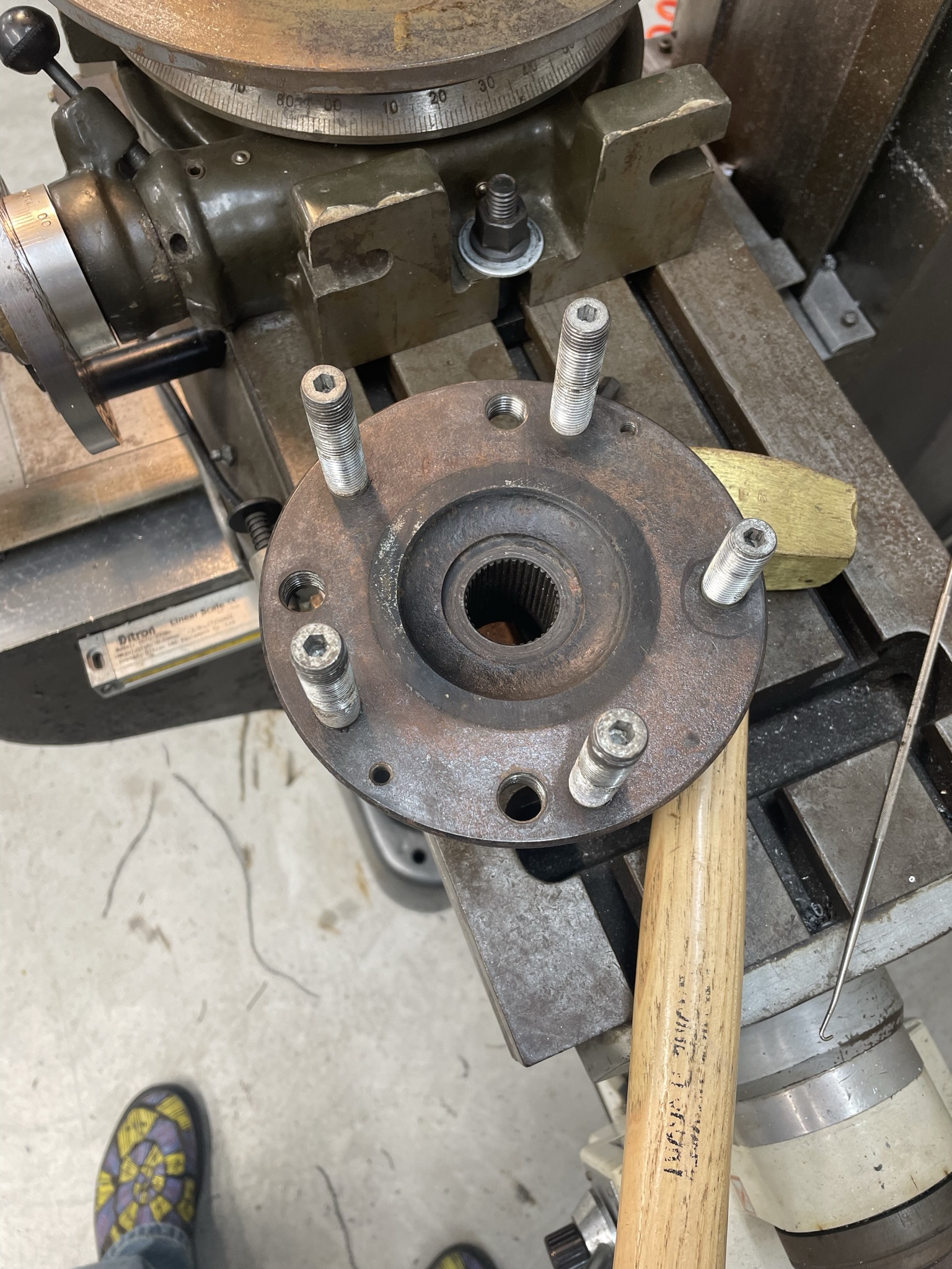

Machined rear hubs and rotors for 5 lug….

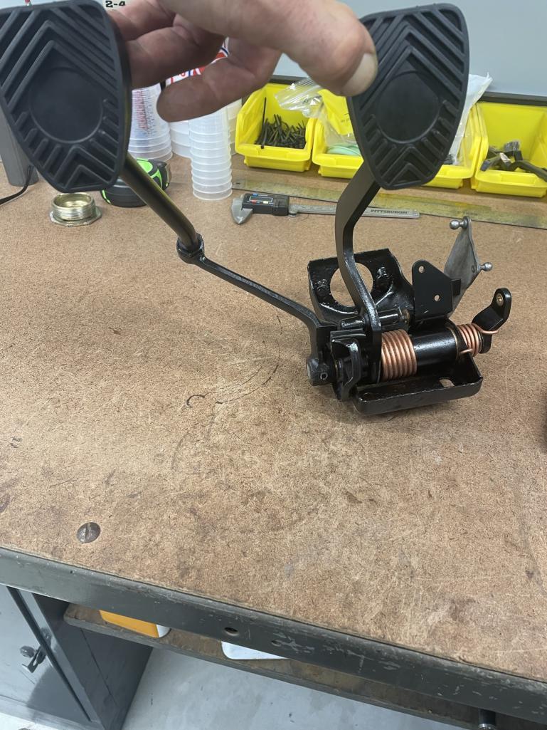

Rebuilt the pedal cluster….

Will you finishing the welds on the floor pan? Looks like a good start but also some finding and blending in your future.
Yes, these were just some random shots. The welds have been completed.

QUOTE(East coaster @ Nov 4 2022, 07:15 PM) *
Are you planning to cut and weld the trailing arm to add camber back? You could lower the inner suspension console/mounting point too. I considered making a reversible insert in the inner ear for my build. I still might do it if I find I don’t have the adjust range I need.
East coaster
post Nov 7 2022, 06:42 AM
Posts: 1,992
Joined: 28-March 03
From: Millville, NJ
Member No.: 487
I guess I’ll see where I end up with camber. I saw the mod you did on your arms but didn’t know if it was to achieve extra camber or to be able to get to stock specs.

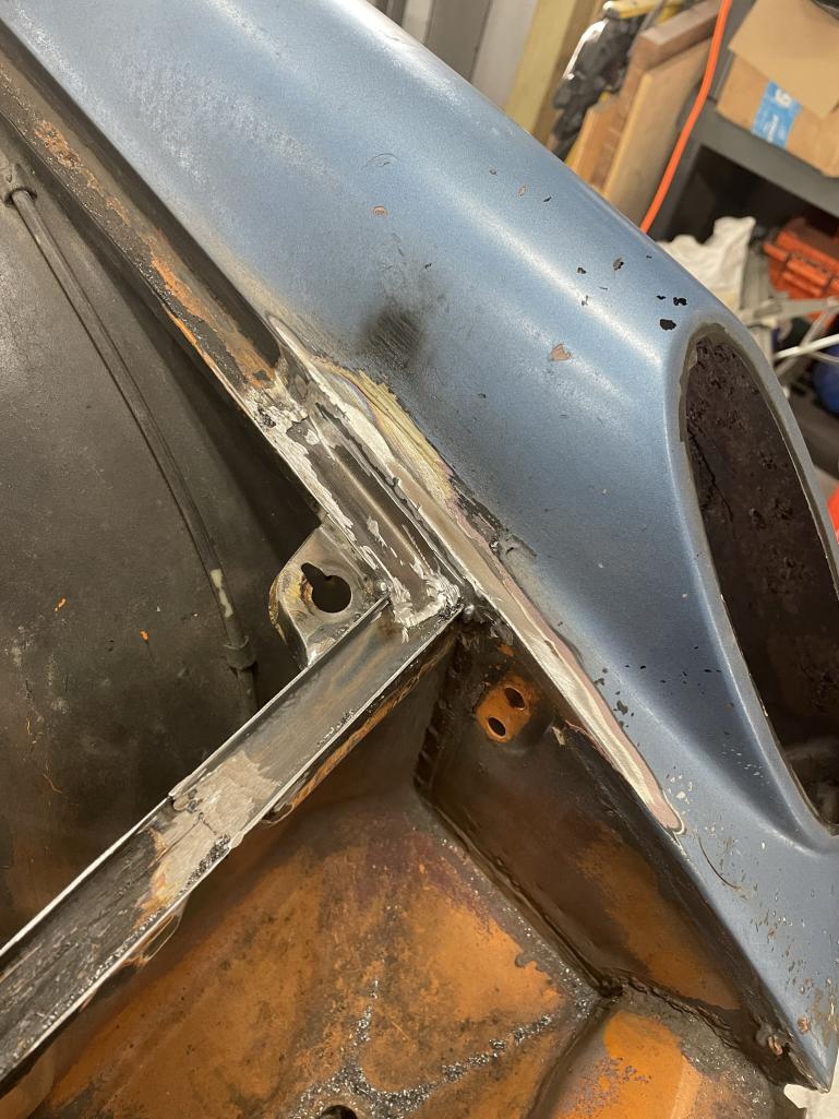

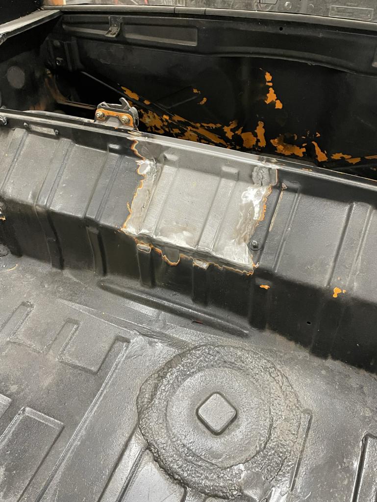

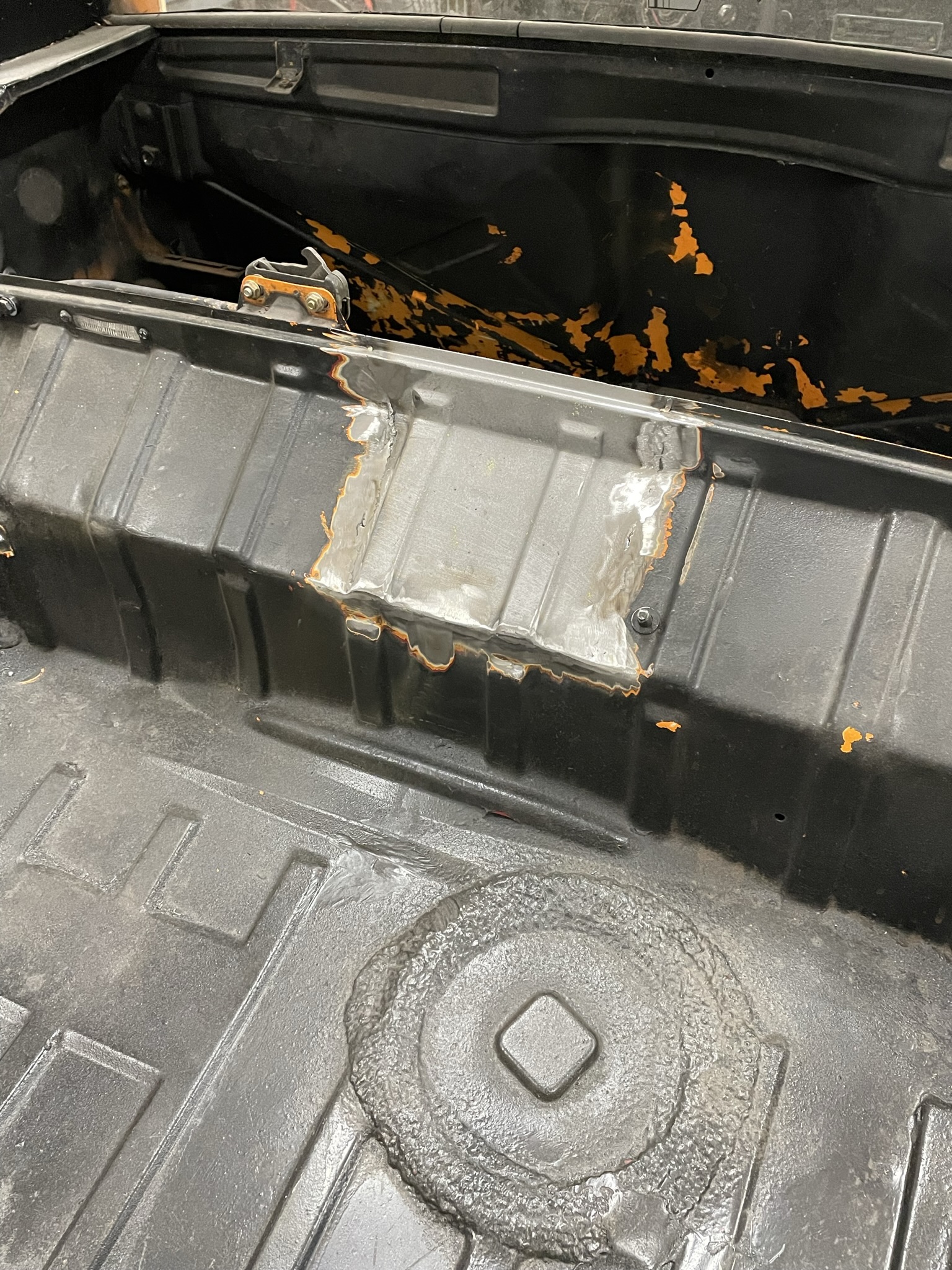

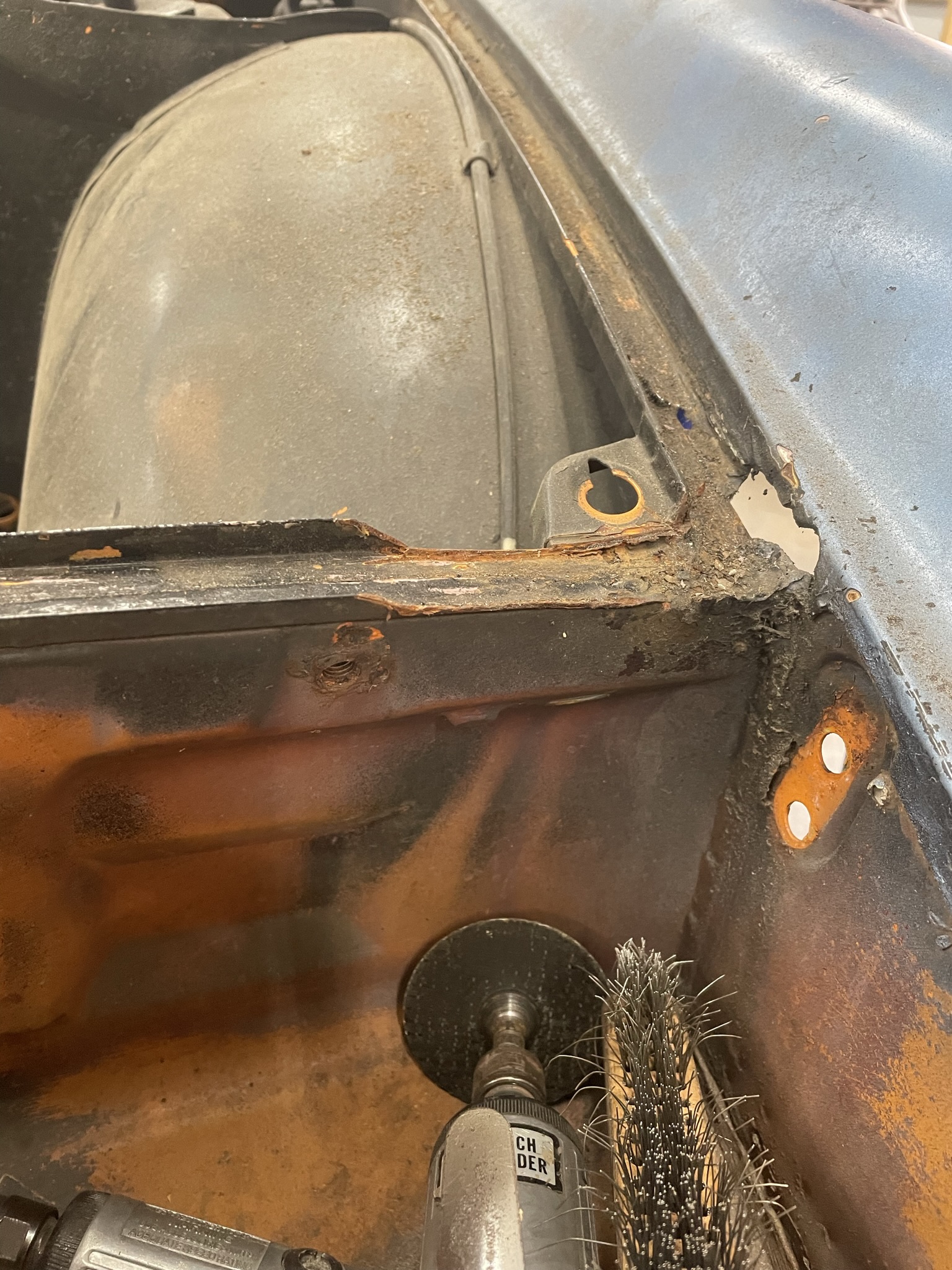

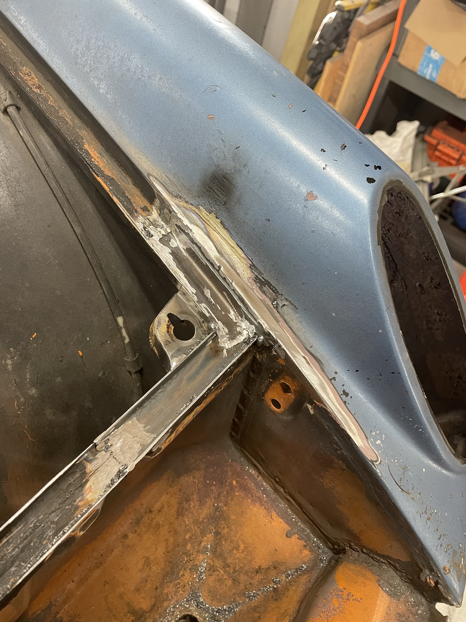

It was hood seal channel repair day. Bent some 18 gauge channel and went to work. Some before and afters……both sides were pretty much the same.

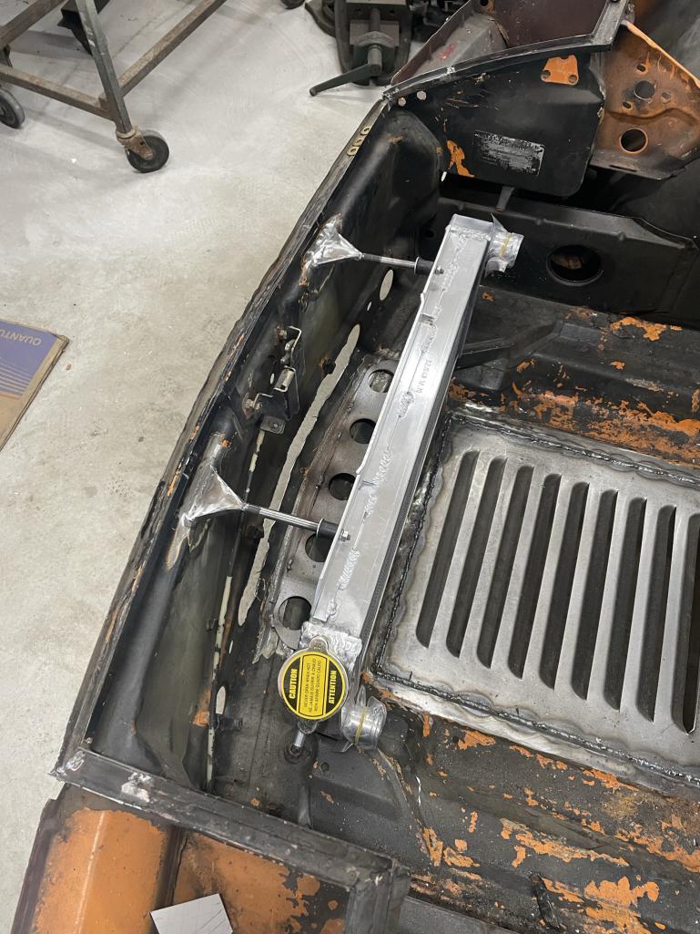

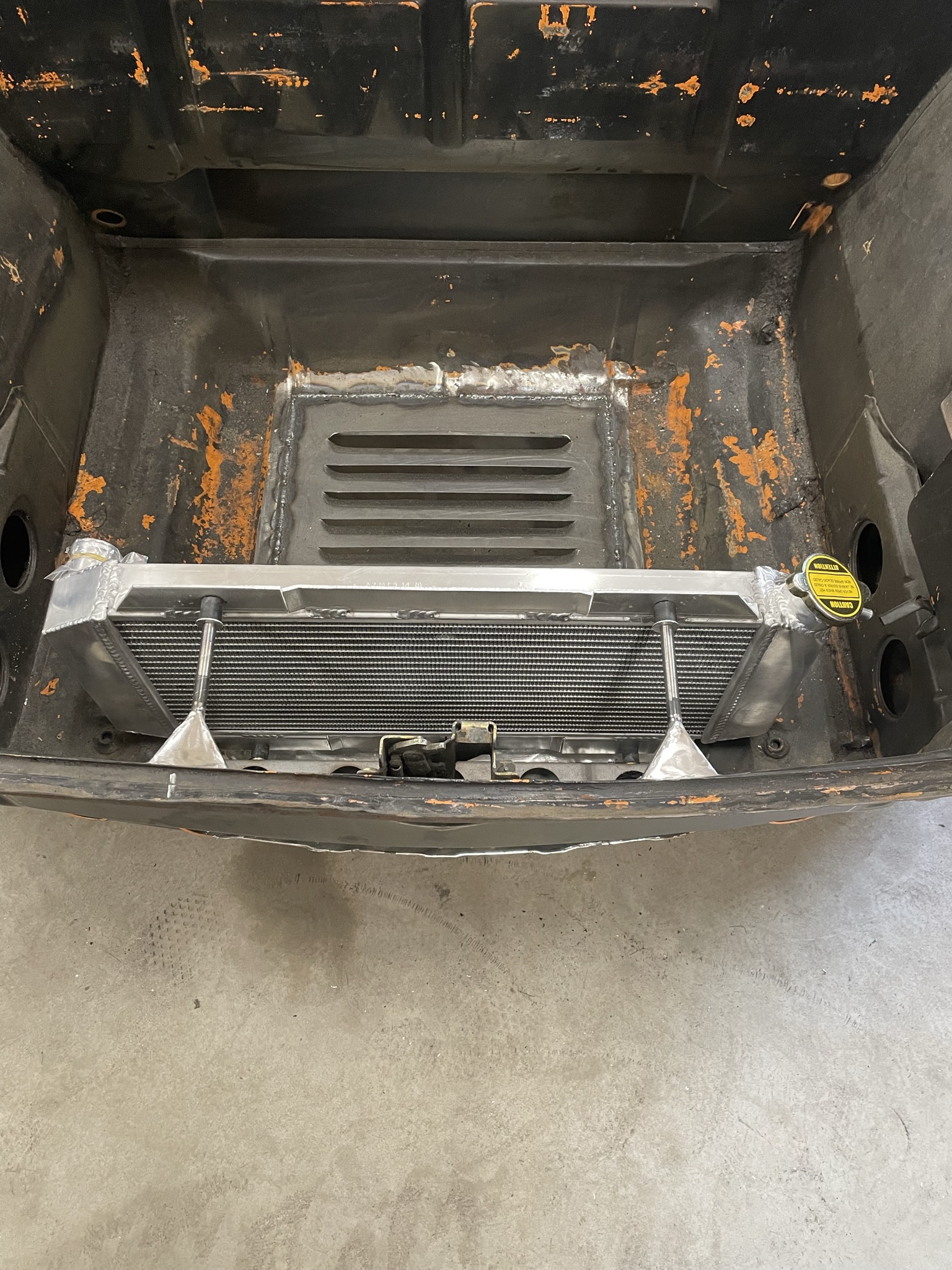

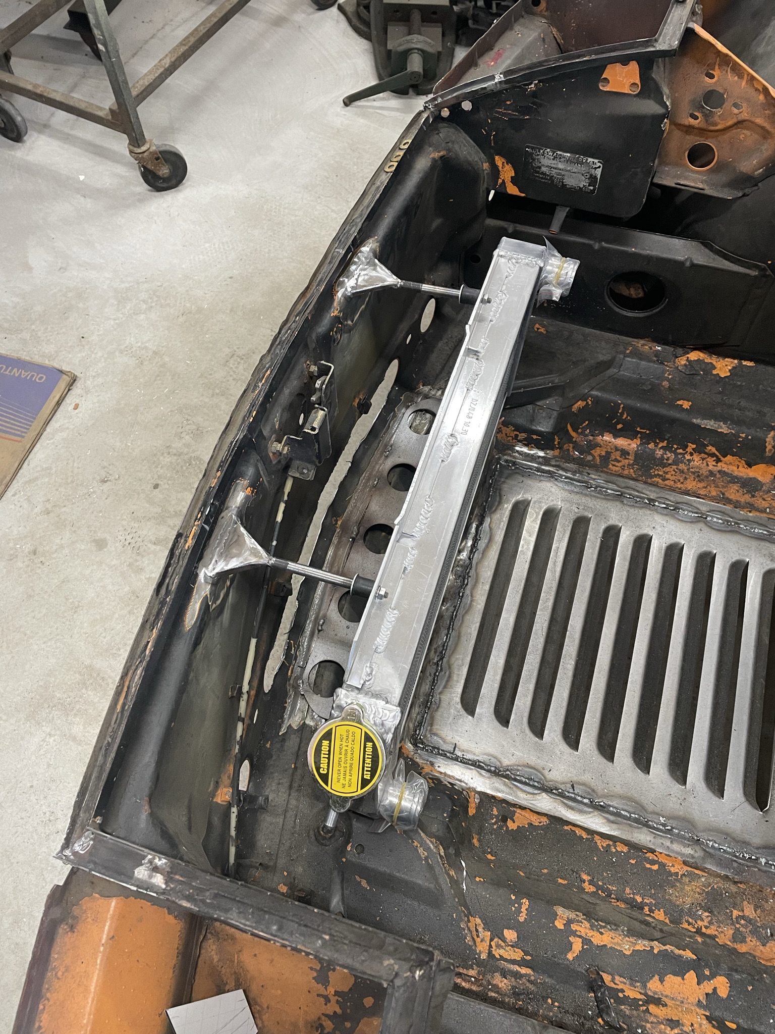

Radiator time…..made a mount for the bottom of the radiator and welded it into the front of the trunk. It has 3 rubber mounts at the bottom of the radiator that will support the majority of the weight and stresses.
East coaster
post Nov 12 2022, 08:36 PM
Posts: 1,992
Joined: 28-March 03
From: Millville, NJ
Member No.: 487
Then moved on to a means of mounting the top of the radiator. These mounts won’t have much stress but I wanted them to be strong, but minimal. I decide on two reinforced posts extending from the front wall of the trunk. These are 3/8” chrome-moly tubing passed through the chassis and plug welded on the outside, then braced with some simple flanges on the inside. Rosette welded some 6mm studs into the radiator end of the tubes that mount the rubber isolating moun.
Very light and simple, but very strong…...
