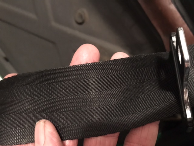

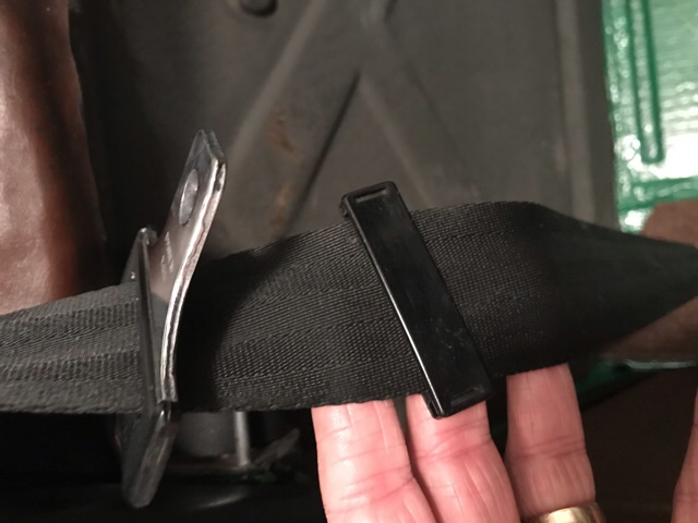

Ok; now onto reassembling things after new door sill carpet install. Noticed that the passenger side seat belt has a handy clip that keeps the insert tab from falling down to the anchor piece down next to the seat. See first pic. (IMG:style_emoticons/default/biggrin.gif)
Of course, then checked drivers side and NO CLIP! See second pic. Is there supposed to be one there, or only on the passenger side? (IMG:style_emoticons/default/WTF.gif) If so, how to source one of them?
Also of course, the PET diagram (Body: 812-00) is of no help as it shows sort of a clip but a) not a separate part so no part # and b) on the OTHER side of the belt guide bar as if to keep the belt from going too far into the retractor ????
Oh, and not to mention the small C-clip I found back behind the backpad; no telling WHERE that came from….. (IMG:style_emoticons/default/dry.gif)

https://www.pelicanparts.com/More_Info/9288...goaAq0tEALw_wcB
and
https://www.pelicanparts.com/More_Info/9288...=928-803-151-02
available numerous places under 928 part numbers - requires BOTH parts:
928-803-153-02 and 928-803-151-02
one is the "top" other is the "bottom"
You could also go "modern" and use the buttons like many late-model cars:

yes, one on driver's side too.
flacas got you covered there.
