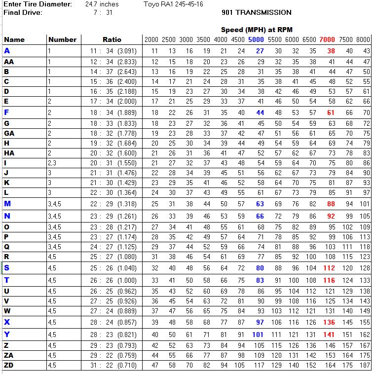

The question of hp/torque limits on the 901 transmissions always comes up and I have commented on my experiences a few times, but here they are:
My car was strictly track only for 23 years and originally had a 3.0 l making about 275 hp and for the last 20 years had a twin plug 3.4 l making about 335 hp (290 to the wheels). I used a 901 gear box with the billet intermediate plate. I had two transmission failures over the years, one was the R&P and the other was broken tooth on 4th gear. During the last 15 or so years I had no failures at all but pulled the transmission every 3-4 years to freshen which included bearings, synchros and any other parts that looked questionable. I also drained and replaced the gear oil every season. I looked for gold-colored bits in the oil to get a sense of the condition of the bearing cages. I only used first gear with a light throttle and most race tracks involved gears 3-4-5 with a rare few needing 2nd gear on a tight, slow corner.
I think that you can save a huge amount of money going this route if you are sensible about first gear and do an occasional refresh. My race shop told me when I asked about a 915 conversion, that the money not spent on the conversion could buy a lot of 901 rebuilds. I fact, I built two race boxes, a long gear box and a short gear box. I always ran the long gear box and kept the short gear box as a spare. My long box has a Guard limited slip and the short box was built with a Torsen style differential.
Now that I have retired from racing and have converted the car to a street hotrod that just goes to shows or a little local canyon carving, I think the transmission may outlive me. Many years ago when I pulled my box during the winter off-season and sent it to be freshened, I got the freshened box back and re-installed it only to find that I had one forward gear and five reverse gears. My shop was very apologetic and instead of me pulling the box and replacing it had me trailer the car to the shop and they made it right. The tech obviously though he had a 911 box instead of a 914 and flipped the R&P.

Good point from Steve:
"I switched to the latest 915 trans because the 914 trans drove me up the wall with my 3.2 motor on the street. I felt like I was shifting all the time. Because my 915 gearing was designed for the 3.2, all the gears are taller and now its like driving a stock 911. It’s also much nicer on the freeway."
My car has 245-45-16 Toyo RA1 all around and is turning 3000 rpm to make 60 mph so it is not optimal for long trips, but it suits my purposes of a once per month C&C or canyon drive. This is with an AFNSY gear set. Using a ZD top gear can get me to 70 mph at 3000 rpm with this size tire. My track tire used to be a Hoosier 274-45-16 which was a little bit taller.

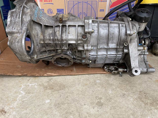

I have a WEVO based 915 done by Patrick Motorsports with my 3.8... shifts like butter and as Steve pointed out the gearing is a bit different, allows the big 6 to really stretch its legs and feels like the gearing is appropriate to the crazy HP. I was a fan of the 901 shift pattern but honestly with the big 6 the 915 really feels much more suited to the engine.

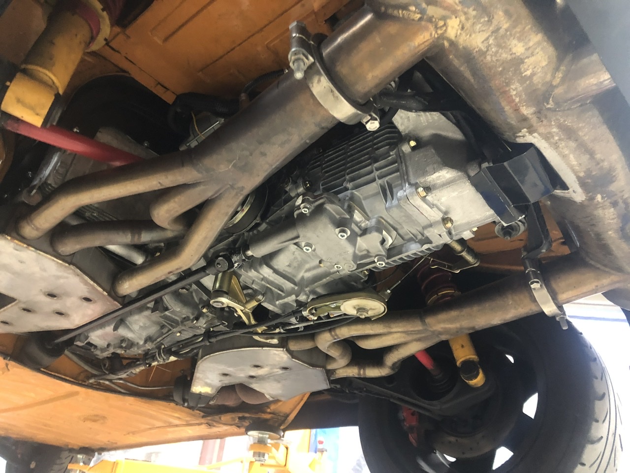

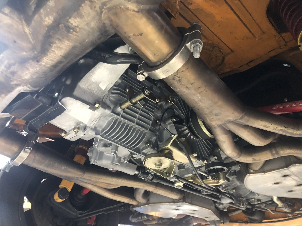

I was just talking about this with 914Dave today. He used a Vellios kit - NLA. He said it's a lot like the Martin Bott kit. He's a machinist and carefully fit everything together. Even had to make a piece missing from the kit. Says it shifts like butter and handles any abuse from his 3.2. He drives his car thousands of miles per year so it's a real thing, not just a future plan. I know for sure he isn't going back to a 914 trans.
https://frontstreet.media/2019/02/20/how-to...4-6-gt-tribute/
I have a 914 trans in my 3.2 conversion car but the next one is getting a Carrera trans with WEVO and LSD built by Peter Dawe. It came in on a 914 race car and I snagged it up. If you don't like the 915 trans, you just haven't driven one built by Peter. The Dawes built 3.6 went to a friend.

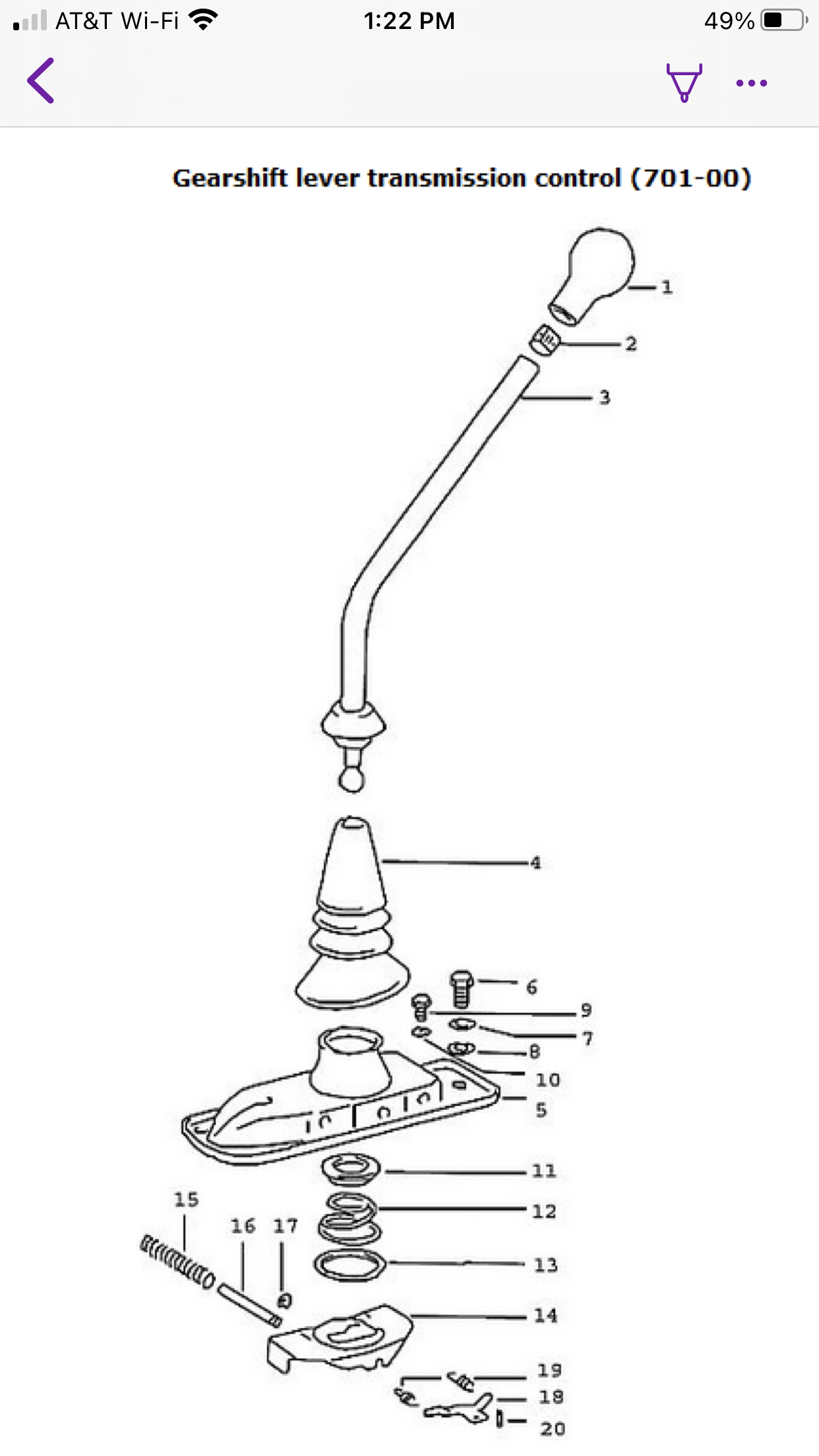

Shifter information: all 915 conversions that have ever been made use a 911/tail-shift style shifter with the ball cup and support bracket under the shifter.
Some 915 conversions are referred to as "side-shift" but the linkage is not designed to use the 914 side-shift type shifter. If you use the side-shift shifter with a 915, you will end up with the shift pattern flipped left-to-right.

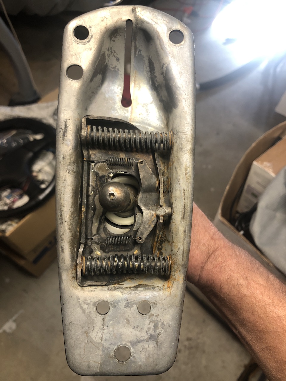

(IMG:style_emoticons/default/agree.gif) The only experience I have with a 916 is my own but I realized early on
that the reverse interlock on a 914 side shifter and the change of motion would
not work with a 915.
My trans is a '72. It's the only 915 that uses a stamped steel shift base that looks
just like a 914 rear shifter.......but it is very different down below.
The reverse lockout is on the opposite side and has two additional small springs.
I was lucky to find one.
I think the '73 and on 911 aluminum bases are the correct choice for any
915/916 install. OR, your choice of quality aftermarket 915 replacements.
Rory
I tried them all desperately trying to figure out why it wouldn’t shift right before taking the car to Patrick Motorsports. The 916’s and other period correct GT’s with a 915 gearbox all have this one year 1972 shifter, since that is the year they came out. It looks like a 901 shifter with the reverse lockout on the other side. I still have one in my collection. I sold the Wevo and kept the 915 rennshift that JWest mentioned. The 915 rennshift is much more precise and with the stock short throw, I have zero issues with the 5th reverse lockout. The rennshift and Wevo is spring loaded to the 3rd and 4th gate, but the Rennshift also has a shorter left and right neutral. Literally when shifting from 2nd to 3rd all I do is push up on the Rennshift and it automatically goes into 3rd like butter. The stock 915 shifter and one off 1972 915 shifter is only spring loaded for reverse and 5th. The rest of the gears you have to fish for.
Notice goofy one off part numbers 18,19 and 20 5th reverse lockout. It does work and is period correct, but doesn’t shift like a modern Rennshift.
