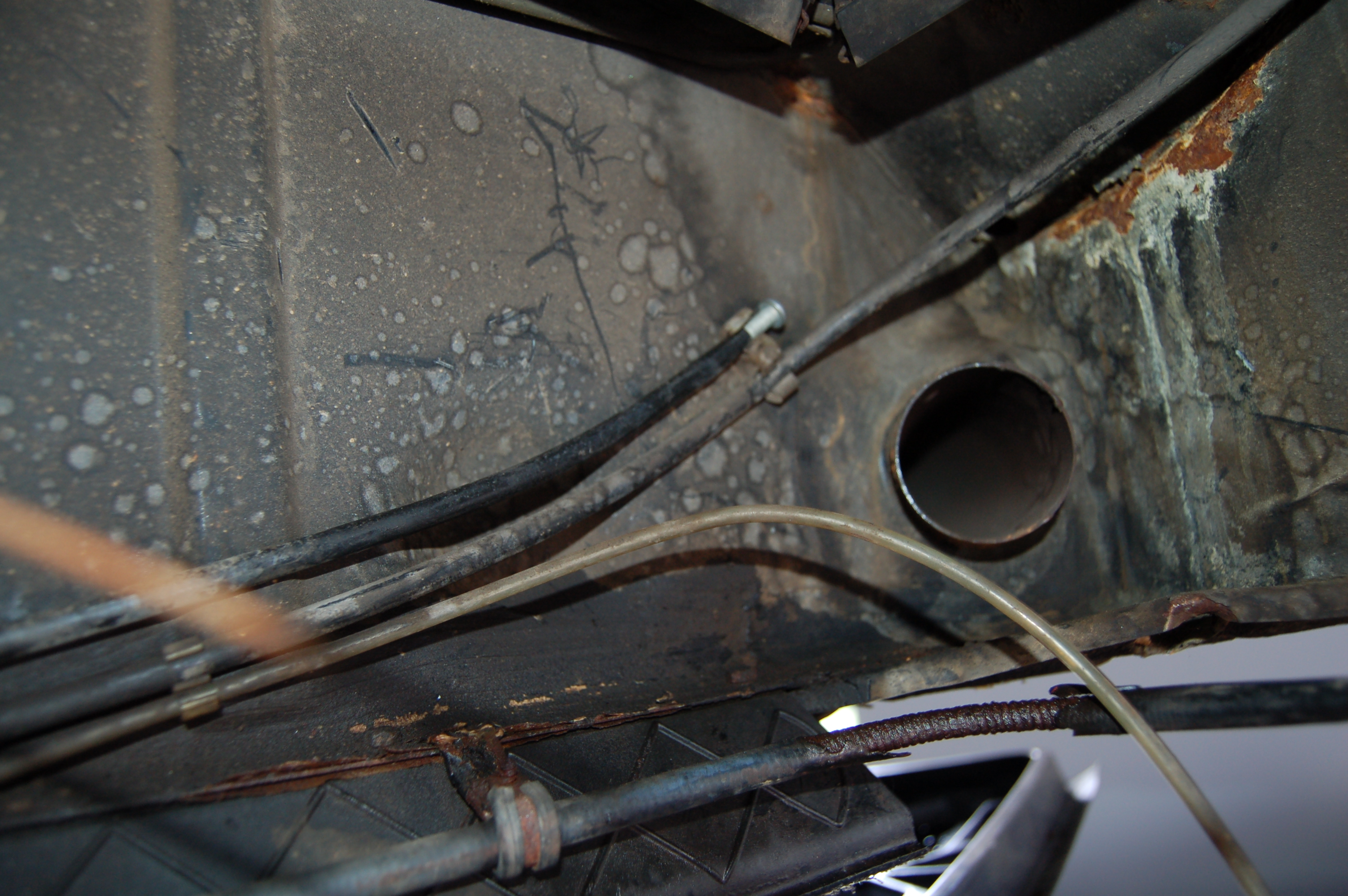

OK, i get carbs only need one fuel line, but hey, there are 2 sticking out of the bottom of the tank.
I Did the Tangerine SS lines to eventually go back to FI, but going with the Webers to get the thing up and running.
Out of the tunnel and into engine bay, what's going on with the orphan fuel line? Block it off out of the tank or in the engine bay? Which one gets blocked off? The one with the tank screen filter or the other?
And What the Hell is this little white tube? Is it for the FI or does it have some function with the carbs? I don't think so but I keep seeing this tube in my disassembly pics.

White line = Vacuum line for the charcoal vapor/fume recovery system

The one with the filter is the supply line. Do not block it off. Even with carbs you can and should run the return line. Weber makes a fitting for the dual carb setup that is a "T" banjo. You plumb supply to one side of it and run the other side to the return line. That way the fuel is being cooled and you wont vapor lock.
I assume you know you cant use the stock fuel pump, you need 3-5 psi, not 60.
IF you're not running the return line, then yes, you can cap it at the tank, not the line end, which would be real dangerous.

QUOTE(914werke @ Dec 6 2022, 06:12 PM) *
OK, one end goes on the vapor recovery tank on top of the fuel tank. where does the other end go in the engine bay?

QUOTE(Robarabian @ Dec 6 2022, 06:38 PM) *
OK, makes sense to prevent vapor lock. Yes, your assumption is correct. I ordered a new fuel pump with the SS lines.
you mean capping it in the engine bay would be unsafe!! Like the PO did in my pic. Not only did he cap it in the engine bay it looks like he used whatever screw was laying around.
