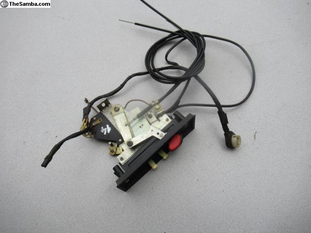

Specifically for the 1973 era? At the very least, are the dash units the same size? Trying to fill a hole. Thanks

NO. Different electrical connection. 911 has plug on it.

The 911 ventilation controls are the same size as the 914 controls. There are different variations in the actual cable and electrical connections. So if all you are trying to do is plug the hole, then it will fit. Otherwise you may have to do some creative modification to get it hooked up.
I bought a 76 911 control head and used pieces from it in a 914 control head because the top lever in the 911 is split in two. That way the blower can be run separate from the cable control. I can use the top lever cable to run the recirculation door, and still be able to run the blower in my stalled AC install.
