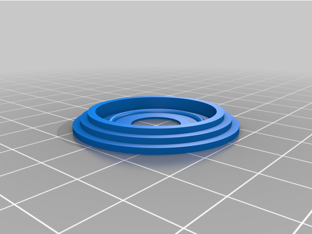

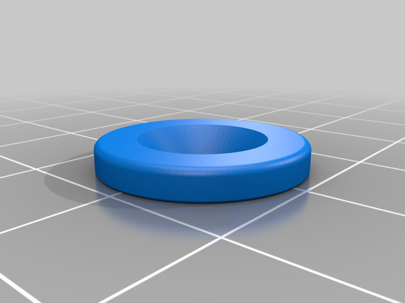

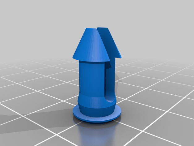

Hi Folks,
I bought 1972 914 last summer and I've been working on various little improvements to restore/repair some issues. This forum has been a great resource - an ongoing source of information and advice, so thanks to everyone who has contributed their experience.
While performing the various fixes, I decided to 3D print some of the little bits that I needed along the way. Most are actually available and not expensive, but: 1) I live in Canada and it can be annoying paying shipping, duty, taxes that end up being 2-10x the cost of the actual parts and 2) I wanted to take on the learning challenge and come up with my own solutions.
My designs are shared on Thingiverse and you can download the STL files for printing as well as the original FreeCAD files I created them with. They are mostly nothing special, but perhaps they will be useful to others some time. I looked around and did not find anywhere here where we can catalogue 3D printable parts for our cars, so perhaps we can start with these. I'd love to see what other people have come up with too.
The items I have so far are:
- Marker light clips
- Targa bar trim buttons
- Window winder handle trim rings
- Window regulator buttons
- Rear brake adjuster covers
- Trim washers for M5 flat screws
- Button plungers for contact switches
I'll be pleased to answer any questions or take your suggestions for improvements.

I think that is great that you are offering the files for free but Mark has a valid ppint about the stress on some parts makes them unsuitable for 3d printing. I remember a member offering engine lid hinges that were 3d printed and some failures were reported.
The window crank disks and rear caliper adjuster caps should be fine.
What material are you using?

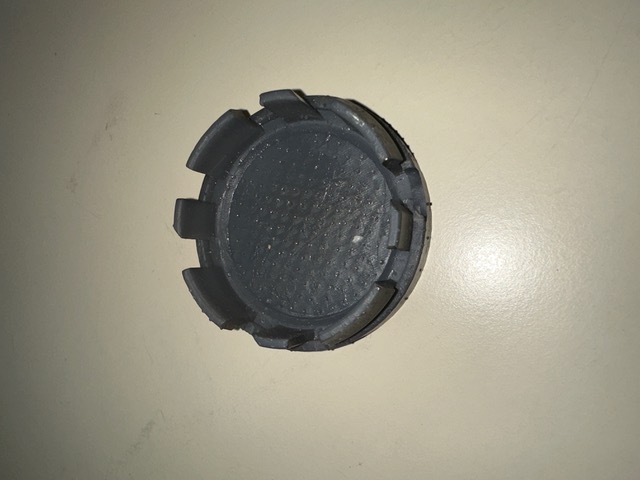

Yup... my thoughts exactly... too "Corvette ish" and too British for a German car.
My car is in winter storage so I don't have quick access to to it but here is a photo of one of the trial 3D prints I did. The gold color is from pressing the part onto a freshly sprayed piece of plastic film. I still have not decided if I will do this in gold, silver or leave black.
For those that don't know what we are talking about...

one problem is that it takes way too long to print a part, hence not worth it with small cheap parts (we have over 500 injected molded side marker pins on the shelf) if we had to print them, we would still be doing it!!! LOL
It is hideously slow - one print can easily take 5 hours or more (depends on size / complexity). Good for prototypes, DIY or very low volume or custom specials - as in "made to order". Also most machines have small print volumes which limits size or number of parts that can be done at once.
It is too costly of a process for making parts to sell that have a reasonable demand.

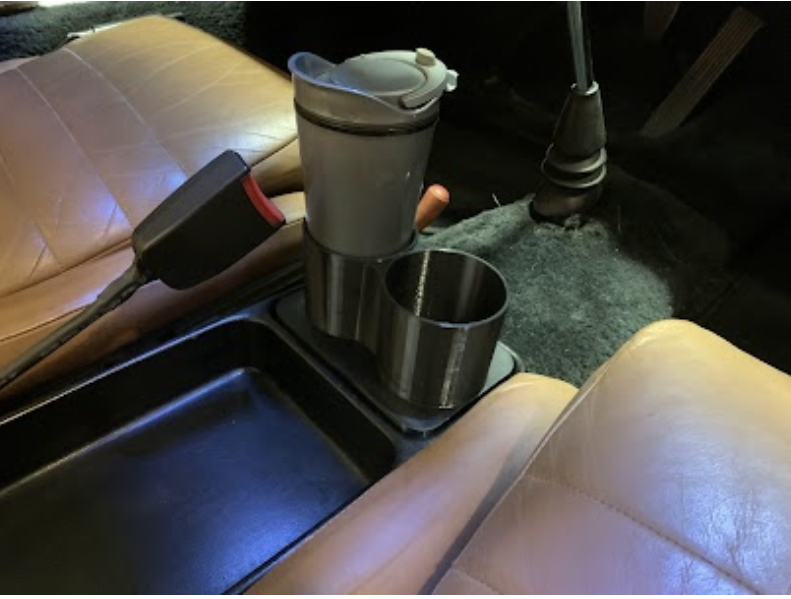

I’m also working on a cupholder that fits into the center console storage bin. I will share that design too when I’m done prototyping it.

"I’m also working on a cupholder that fits into the center console storage bin"
Sweet! can't wait to print that. Been looking for one!
