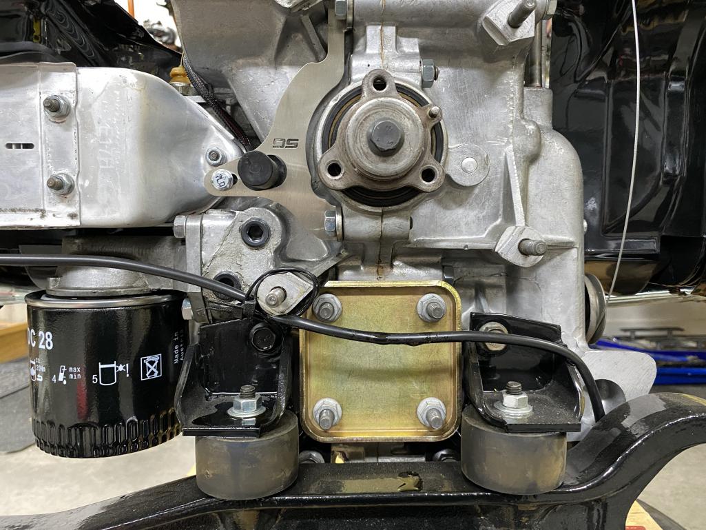

As I described in my build thread, last year, once I got the engine running, I noticed significant oil drops (or more) after each drive. With winter in full throttle, I decided to drop the motor, and see about fixing the leak.
Here's the view of the front. Maybe you can see some oil.

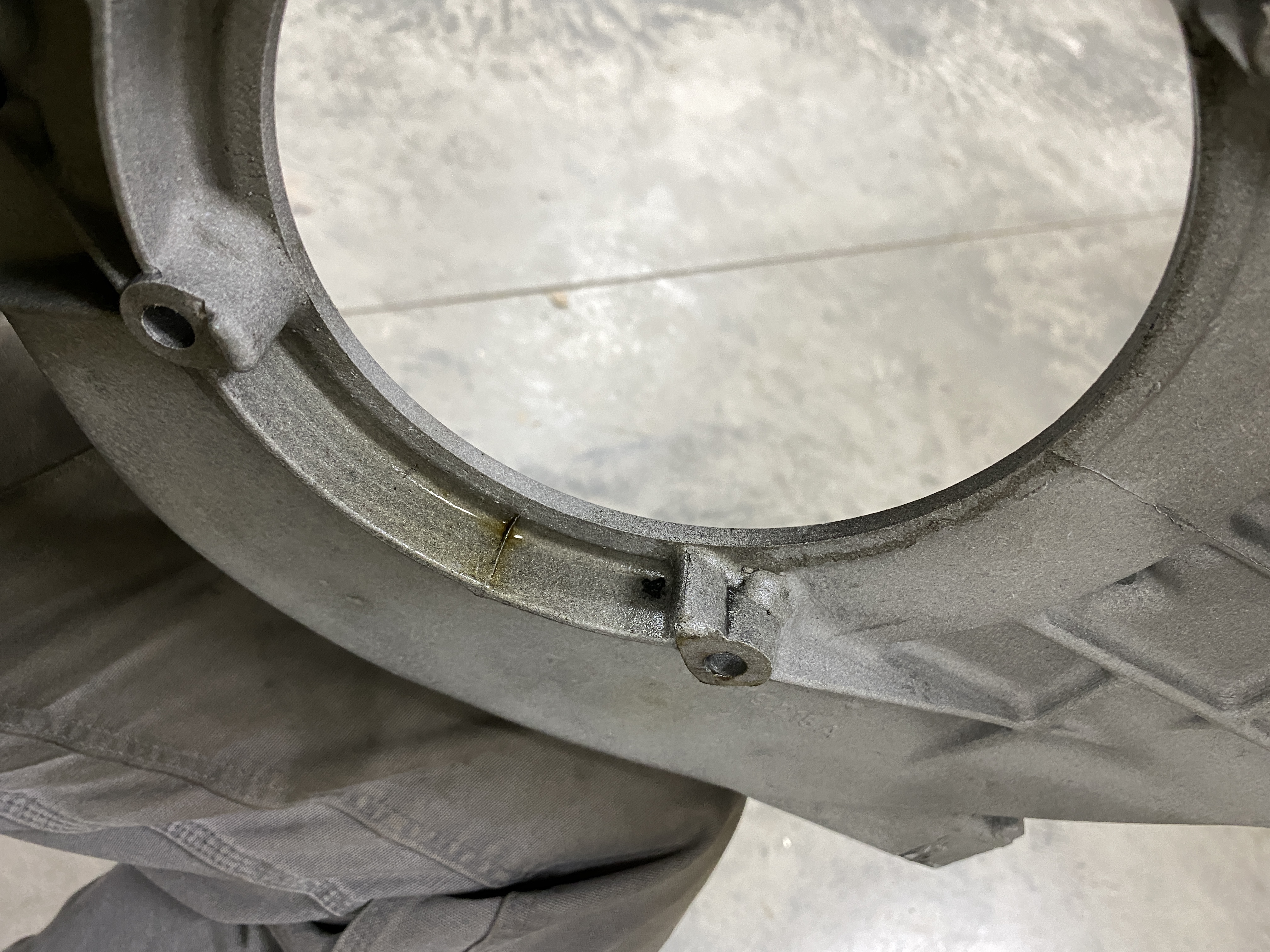

bkrantz   I found some oil inside the inner blowing housing,...   Jan 5 2023, 09:26 PM

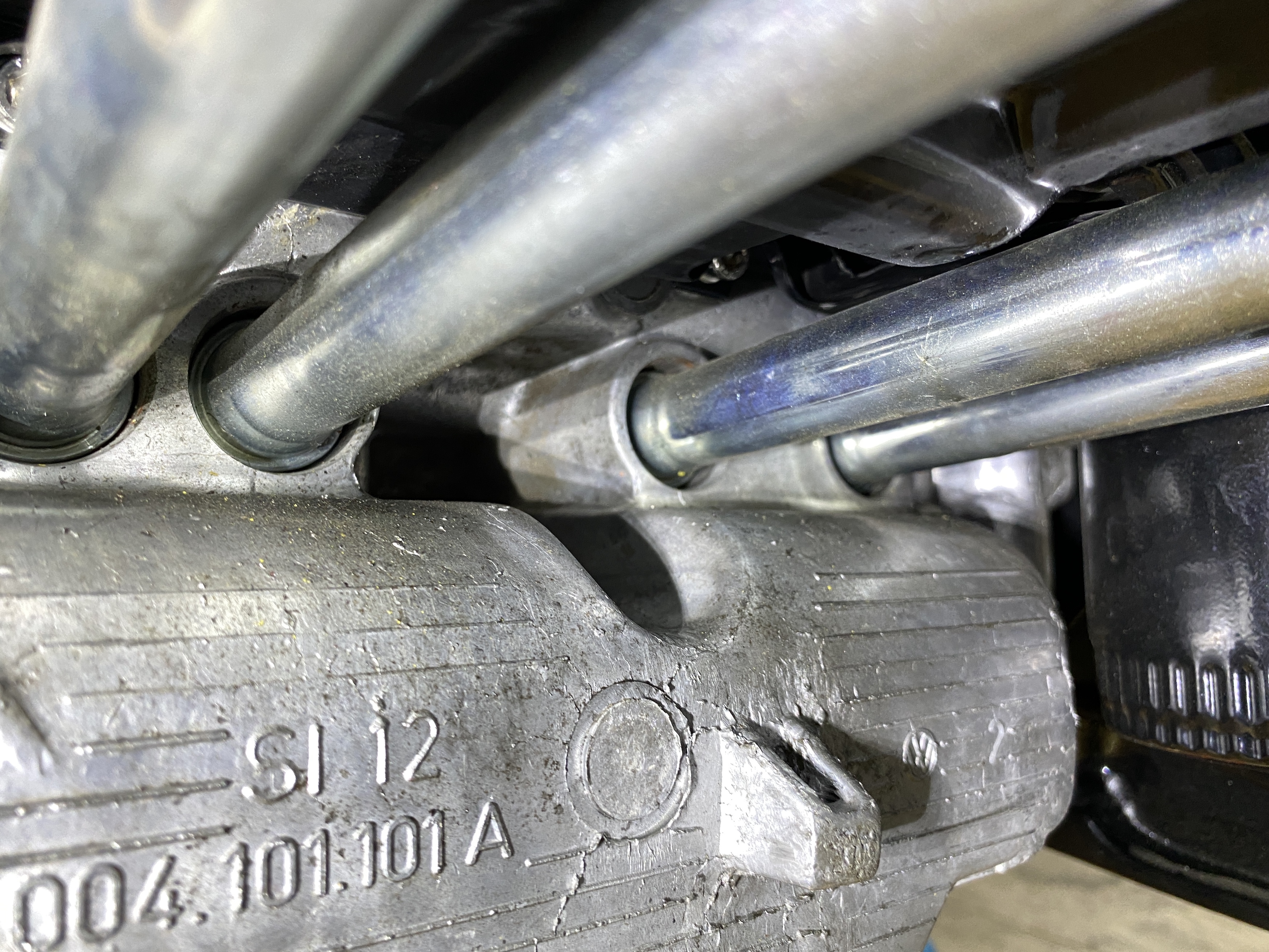

bkrantz   Starting from the top, the case seam looks OK.   Jan 5 2023, 09:27 PM
Krieger   Starting from the top, the case seam looks OK. ...   Jan 7 2023, 08:29 PM

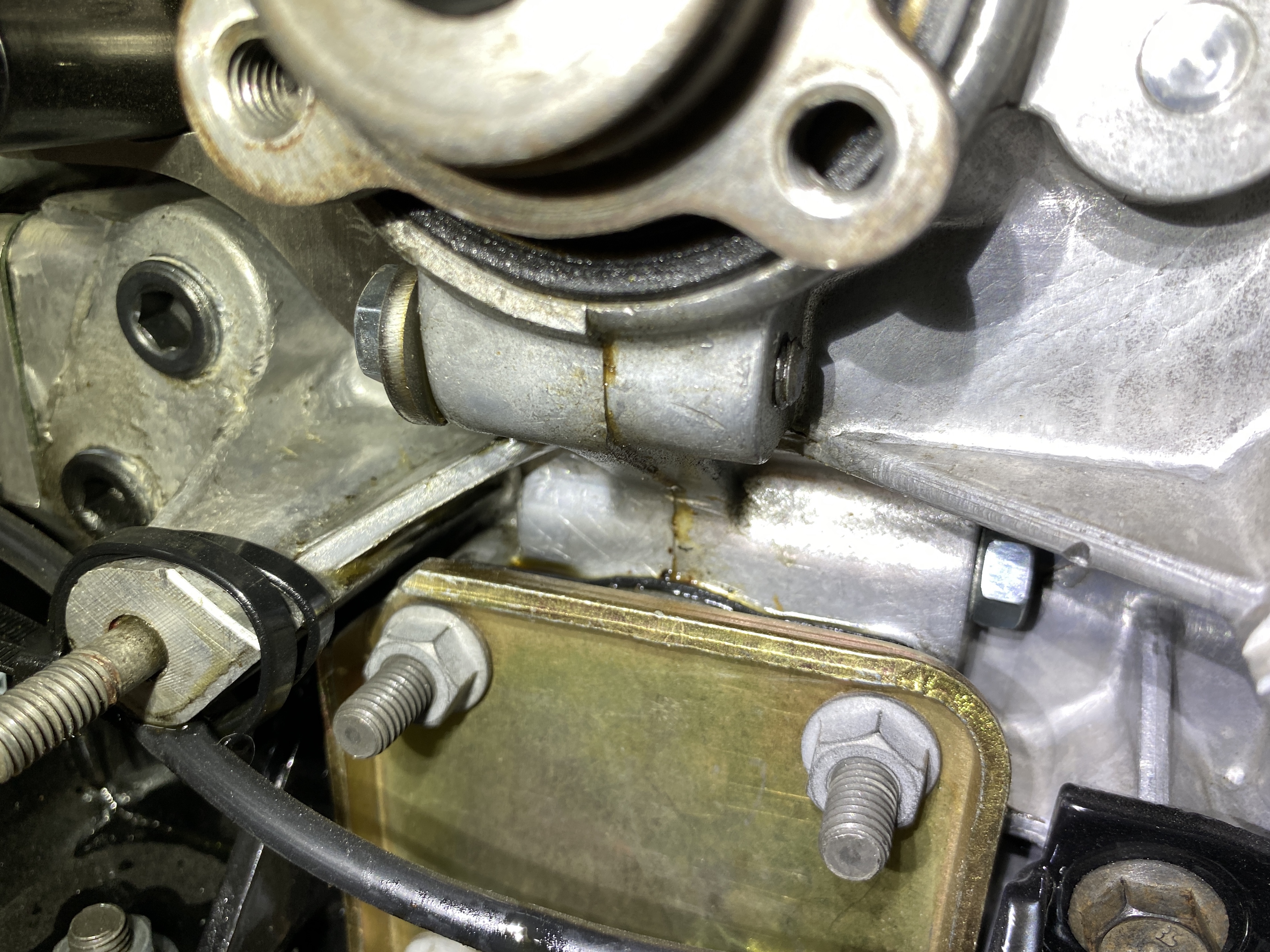

bkrantz   The front seal looks a bit oil wet. But is the se...   Jan 5 2023, 09:29 PM
bkrantz   Lots of oil sitting on the top edge of the oil pum...   Jan 5 2023, 09:30 PM

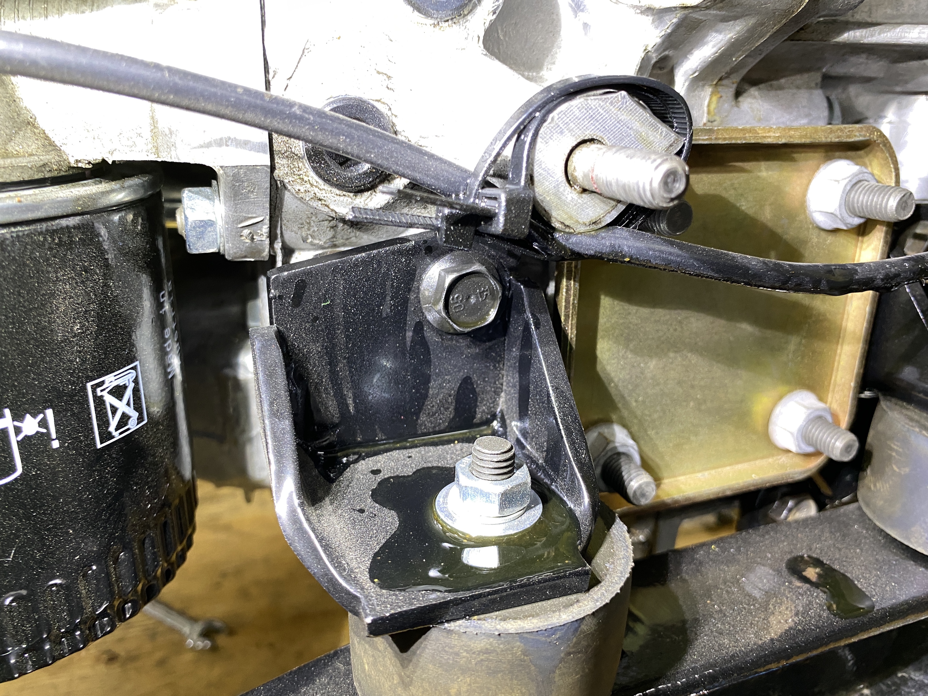

bkrantz   Quite a bit of oil pooled in the right motor mount...   Jan 5 2023, 09:31 PM

bkrantz   But the inner seals, and the cylinder-to-case join...   Jan 5 2023, 09:38 PM

bkrantz   Thanks everyone. Based on what I see so far, I wi...   Jan 6 2023, 09:54 PM
Superhawk996   I think you have oil going in the direction of the...   Jan 7 2023, 11:50 PM

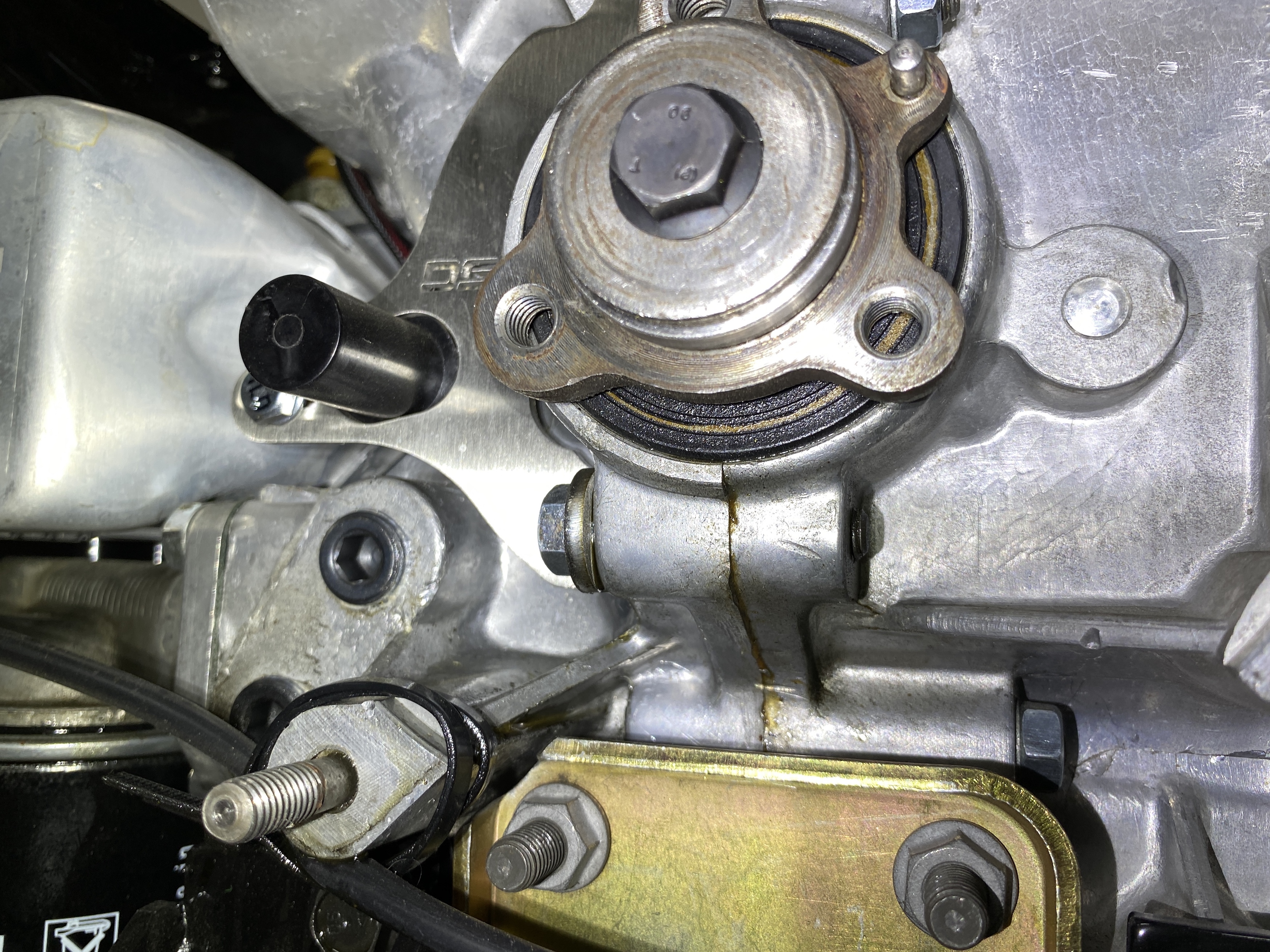

bkrantz   OK, more info. And in my quest for the right answ...   Jan 9 2023, 08:12 PM
bkrantz   I confirmed this by running a Qtip around the base...   Jan 9 2023, 08:15 PM

bkrantz   Here's the cover off. No dramatic scoring. A...   Jan 9 2023, 08:25 PM
930cabman   Here's the cover off. No dramatic scoring. ...   Jan 10 2023, 12:26 PM
bkrantz   Here's the cover off. No dramatic scoring. ...   Jan 10 2023, 07:46 PM
