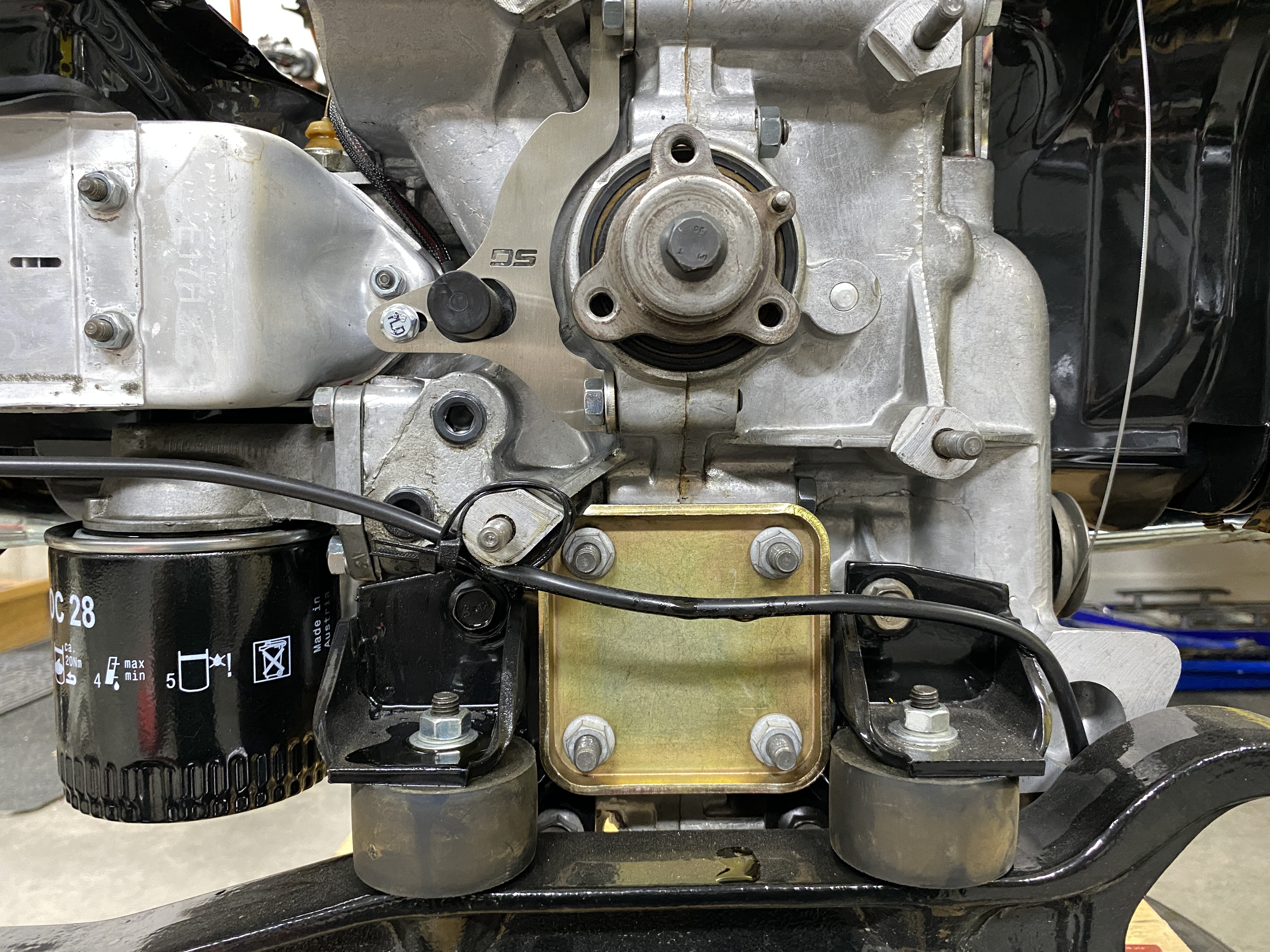

As I described in my build thread, last year, once I got the engine running, I noticed significant oil drops (or more) after each drive. With winter in full throttle, I decided to drop the motor, and see about fixing the leak.
Here's the view of the front. Maybe you can see some oil.
bkrantz   Help me find my oil leak!   Jan 5 2023, 09:24 PM
bkrantz   I found some oil inside the inner blowing housing,...   Jan 5 2023, 09:26 PM
bkrantz   Starting from the top, the case seam looks OK.   Jan 5 2023, 09:27 PM
Krieger   Starting from the top, the case seam looks OK. ...   Jan 7 2023, 08:29 PM
bkrantz   The front seal looks a bit oil wet. But is the se...   Jan 5 2023, 09:29 PM
bkrantz   Lots of oil sitting on the top edge of the oil pum...   Jan 5 2023, 09:30 PM
bkrantz   Quite a bit of oil pooled in the right motor mount...   Jan 5 2023, 09:31 PM
bkrantz   No oil visible where I would expect it if the cool...   Jan 5 2023, 09:33 PM
bkrantz   Some oil sitting on top of the filter.   Jan 5 2023, 09:34 PM
bkrantz   Meanwhile, underneath I might have just a bit of o...   Jan 5 2023, 09:36 PM
bkrantz   But the inner seals, and the cylinder-to-case join...   Jan 5 2023, 09:38 PM
Shivers   Looking at that black wire on the front of the eng...   Jan 6 2023, 08:00 AM
porschetub   Looking at that black wire on the front of the en...   Jan 6 2023, 01:35 PM
dr914@autoatlanta.com   you have an aftermarket oil pump, they are very ve...   Jan 6 2023, 01:36 PM
930cabman   you have an aftermarket oil pump, they are very v...   Jan 6 2023, 02:20 PM
Superhawk996   [quote name='dr914@autoatlanta.com' post='3049581...   Jan 6 2023, 09:58 PM
930cabman   [quote name='dr914@autoatlanta.com' post='304958...   Jan 7 2023, 06:38 AM
Superhawk996   I have wondered the same. Is this an application...   Jan 7 2023, 09:44 AM
930cabman   I have wondered the same. Is this an applicatio...   Jan 7 2023, 06:19 PM
bkrantz   I have wondered the same. Is this an applicatio...   Jan 7 2023, 09:16 PM
Superhawk996   [quote name='Superhawk996' post='3049751' date='J...   Jan 7 2023, 11:23 PM
bkrantz   Thanks everyone. Based on what I see so far, I wi...   Jan 6 2023, 09:54 PM
Superhawk996   I think you have oil going in the direction of the...   Jan 7 2023, 11:50 PM
cassmcentee   Is it possible to have a Wobble in the Crankshaft?...   Jan 8 2023, 04:35 AM
Shivers   Is it possible to have a Wobble in the Crankshaft...   Jan 8 2023, 07:08 AM
BeatNavy   My two cents from my experience here: http://www.9...   Jan 8 2023, 08:06 AM
Geezer914   If your oil pump cover was leaking, oil would be d...   Jan 8 2023, 04:56 PM
bkrantz   More thanks, everyone. During assembly, I used a ...   Jan 8 2023, 10:13 PM
searunner   As I described in my build thread, last year, onc...   Jan 9 2023, 04:32 AM
bkrantz   OK, more info. And in my quest for the right answ...   Jan 9 2023, 08:12 PM
bkrantz   I confirmed this by running a Qtip around the base...   Jan 9 2023, 08:15 PM
bkrantz   First stupid: when I went to unscrew the oil filte...   Jan 9 2023, 08:21 PM
bkrantz   No obvious leak point around the pump cover.   Jan 9 2023, 08:22 PM
bkrantz   No leaks around the studs.   Jan 9 2023, 08:23 PM
bkrantz   Here's the cover off. No dramatic scoring. A...   Jan 9 2023, 08:25 PM
930cabman   Here's the cover off. No dramatic scoring. ...   Jan 10 2023, 12:26 PM
bkrantz   Here's the cover off. No dramatic scoring. ...   Jan 10 2023, 07:46 PM
bkrantz   And the pump itself. BTW, if I need to pull this,...   Jan 9 2023, 08:26 PM
iankarr   I have the same oil pump cover and it was farrrr f...   Jan 9 2023, 08:50 PM
cassmcentee   Great news! Nothing crazy   Jan 9 2023, 09:15 PM
bkrantz   Great news! Nothing crazy But perhaps prett...   Jan 10 2023, 07:37 PM
r_towle   Is there a slot in the body and cover for an o-rin...   Jan 10 2023, 07:54 PM
bkrantz   Is there a slot in the body and cover for an o-ri...   Jan 11 2023, 08:22 PM
nathanxnathan   The fan tends to suck in and redistribute oil all ...   Jan 11 2023, 11:44 PM
bkrantz   Thanks, everyone. Going back to my build thread.   Jan 14 2023, 09:26 PM
