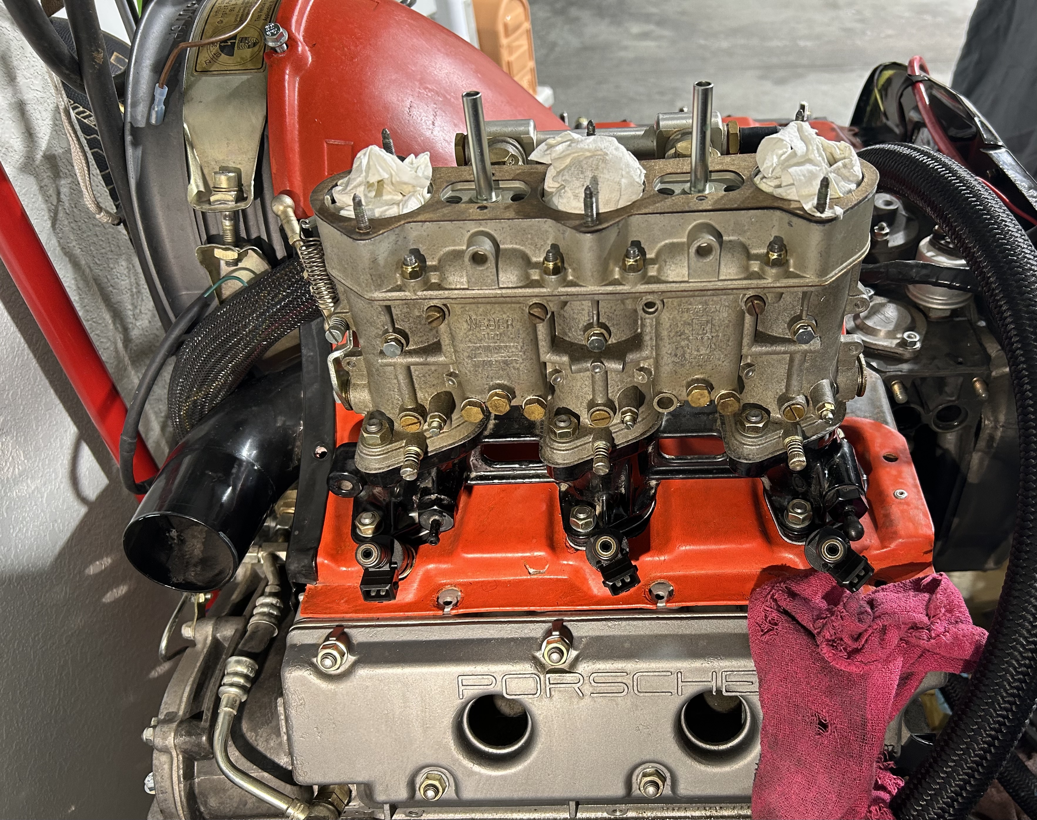

Just a quick update. MFI to EFI bungs are in and will be using the carbs will just be throttle bodies and port injection.
Have at those questionsAttached Image

You’re being a tease
What ECU?
Planning to run Alpha-N control (Throttle Position only)or are you using something like the stock air filter canister with a MAP sensor and Speed Density (SD) control? ECU maybe supports combo mode? I don’t see a TPS on that carb - does that mean you are using SD?
How easily will it be to tune?
Will the ECU support coil on plug or still running a distributor for spark? Can’t see the distributor in your photo - tricky!
What’s required for crank and cam sensing? Let’s see those sensor brackets!
Inquiring minds want to know (IMG:style_emoticons/default/happy11.gif) Can’t wait to see this project progress and some documentation forging a path. I know EFI has been done before on the sixes but this one is sort of unique and something I may do with my 73.5’ 2.4L

Phil,
Gonna use mega squirt. I have base map’s already. I need to drill 6 fittings in the intakes for the map signal. Will not run TPS. This will be very close as far as principle as bittz racing setup except this system is more precise. It will only use map. The link I provided on the other thread is the system so am mirroring
http://forums.pelicanparts.com/porsche-911...14-mfi-efi.html

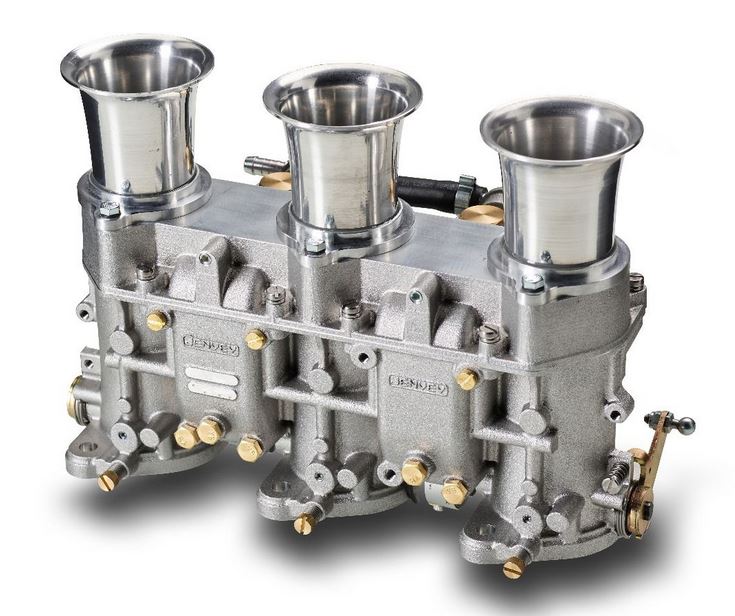

Why not use these?
https://store.jenvey.co.uk/heritage/heritag...ottle-body-42mm
They are a bolt on replacement for Weber IDA3C carbs. All of the EFI stuff is inside the throttle bodies.

QUOTE(ClayPerrine @ Jan 12 2023, 09:51 AM) *
Why not use these?
Pretty cool - but come on $3800? (IMG:style_emoticons/default/huh.gif)
The thing I don’t get with the Jenvey’s Is where the injectors are spraying to? The angle of the injectors seems to be that they spray into a passage like a carb jet instead of directly into the air stream? Maybe I’m just not seeing it correctly but Google doesn’t seem to reveal details of their fuel flow path?
The potential to use a common set of carbs as throttle bodies and to repurpose the MFI / CIS ports on some of the early engines is what makes this proposal that Ben is showing unique vs a set of PMO ITB’s, Jenvey’s, or any number of other high(er) cost EFI solutions were you have to ditch the carbs and buy all new ITB’s (IMG:style_emoticons/default/drooley.gif)

QUOTE(Superhawk996 @ Jan 12 2023, 09:17 AM) *
Why not use these?
The potential to use a common set of carbs as throttle bodies and to repurpose the MFI / CIS ports on some of the early engines is what makes this proposal unique vs a set of PMO ITB’s, Jenvey’s, or any number of other high(er) cost EFI solutions. (IMG:style_emoticons/default/drooley.gif)
These are designed for a stealth EFI installation. They look like carbs, and unless you find the wires coming out the bottom, nobody would notice. For a factory six, this would be perfect. Hide a microsquirt ECU under the air cleaner, and nobody would notice the EFI.

QUOTE(mb911 @ Jan 12 2023, 04:17 AM) *
Phil,
Would love to see some datalogs when you get them. MAP only with ITBs on a 4 tends to be problematic, especially at lower RPM+higher throttle angle. Even with undersized ITBs you could wind up with only about 30% of the fuel map tunable. Interested to see if it works better on a 6.
Megasquirts hybrid alpha-N mode (uses speed density where you have vacuum and alpha-N where you don't) is amazing when setup properly. The trick is getting it setup properly.
