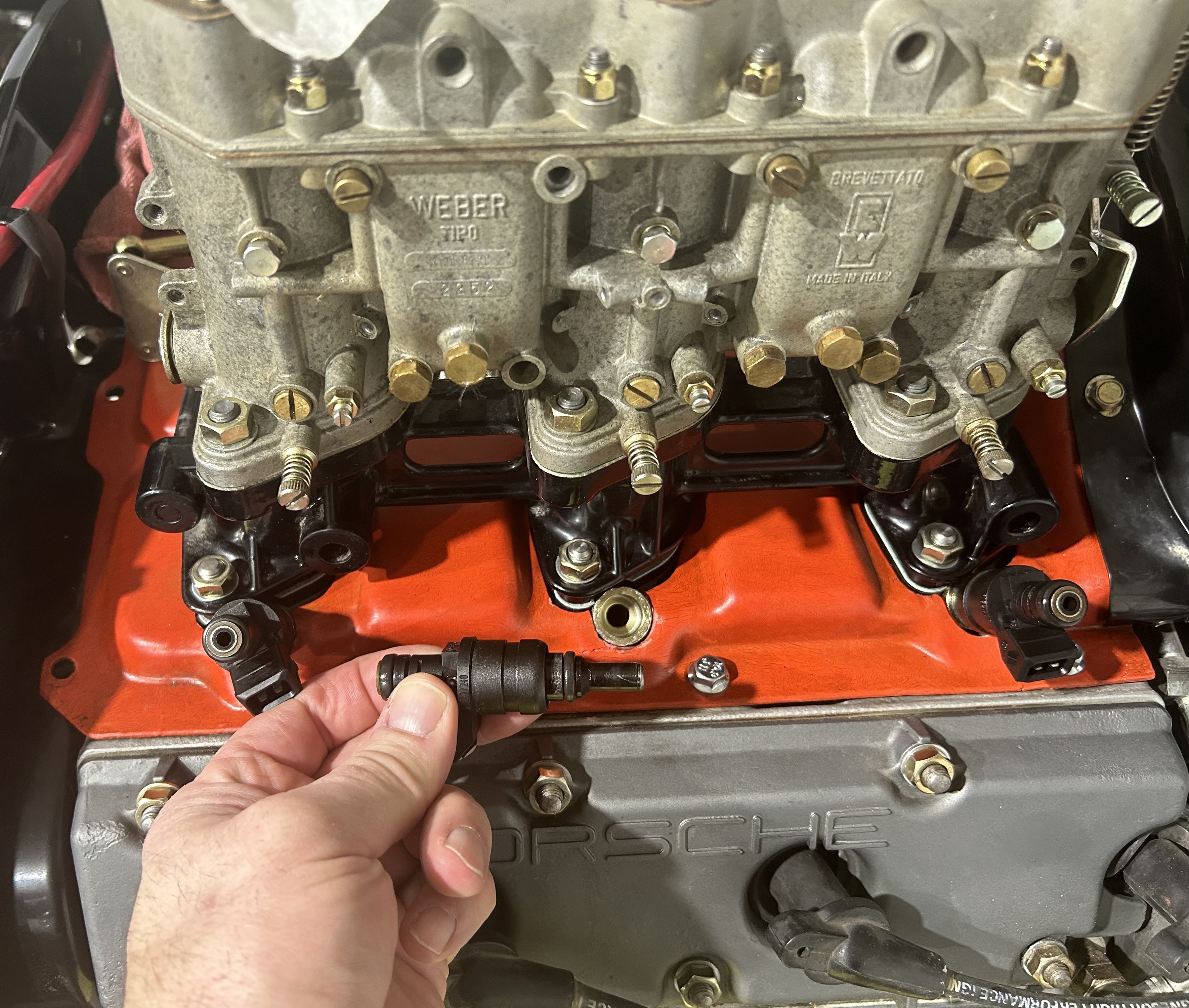

For you viewing pleasure Attached Image

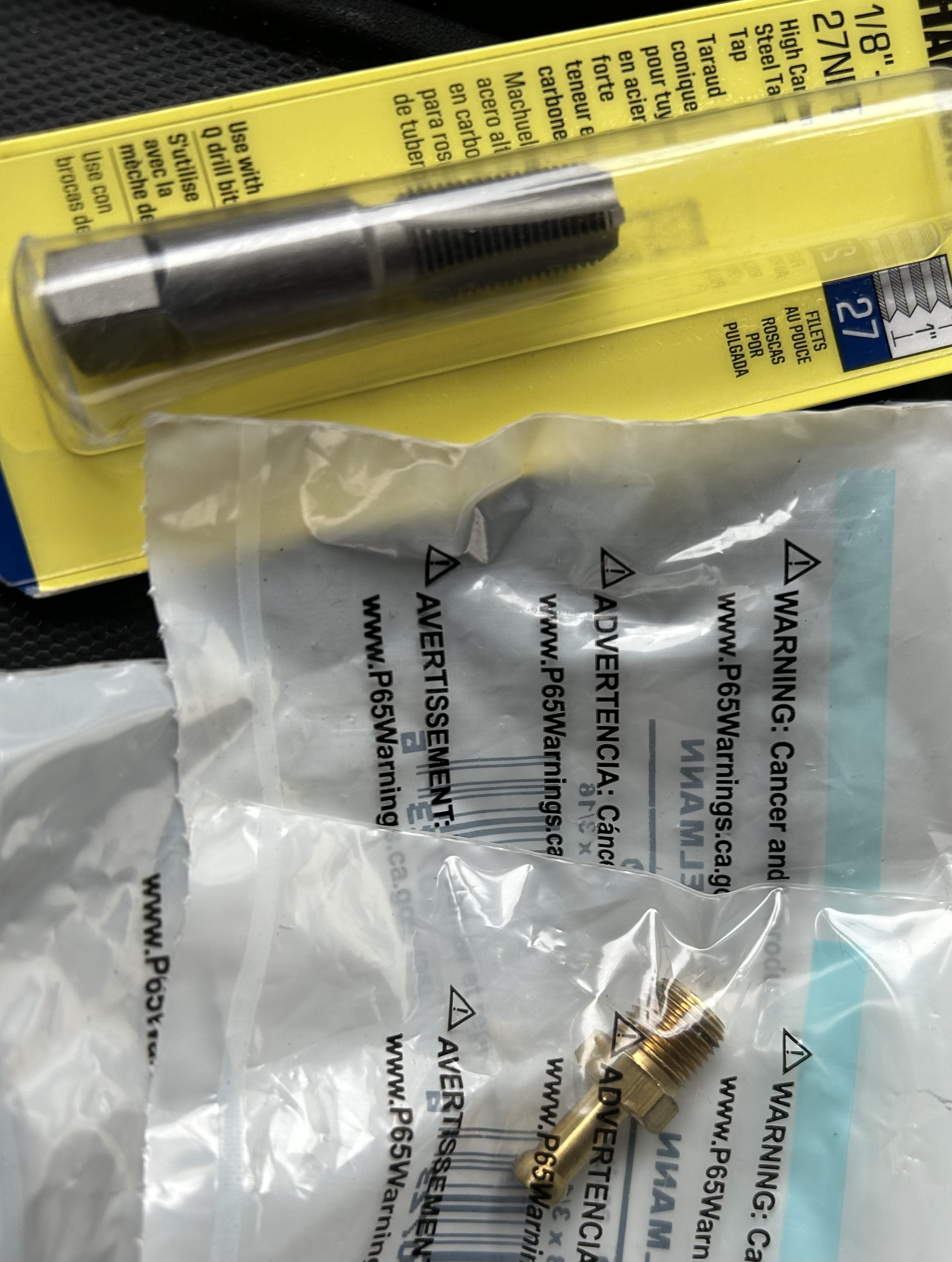

Vacuum fittings selected. I will have to drill and tap each manifold to get a good signal for the MAP sensor Attached Image

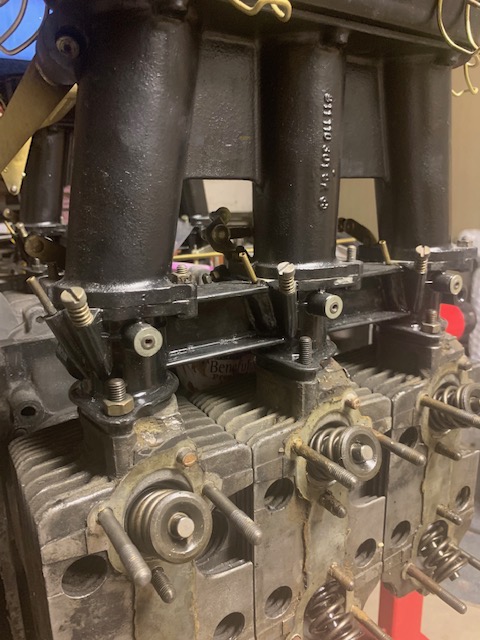

Here is what I did for vacuum fittings on the mag throttle bodies. The little brass tube at an angle on the far left throat next to the idle air bypass screw is the single stock vac port. I machined the middle and right throats for insertion of brass tubes and then used JB Weld to form a boss to seal them that mimics the stock boss.
I’ll run the six vac lines to an accumulator to smooth the vac signal. I hope to run a TPS driven alpha N and MAP signal to the Motec. Hoping to get throttle response as good or better than MFI.
You can see the injector ports on this engine I am using for mock up have been sealed with JB Weld or similar by the PO. I think the ports on my actual engine are sealed with the screw in plugs you mentioned.

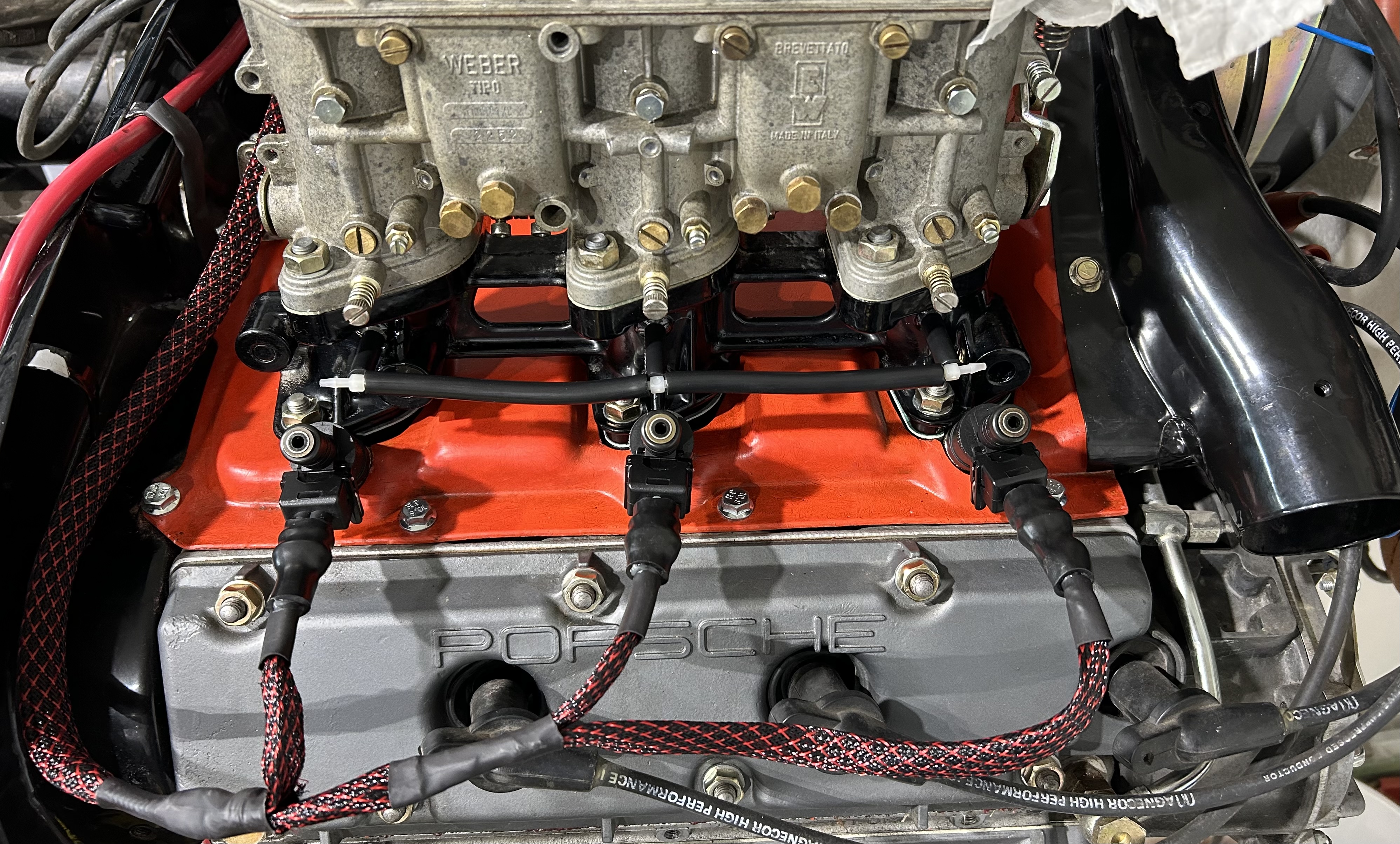

Went a different route on vacuum tubes. Drill .100 hole and used 3/32 brass sleeved inside 1/8 brass and used loctite 638 cylindrical bonding and pushed them in the holes and for good measure so epoxy on the outside. Then connect the 1/8 vacuum tubing only to realize that I need to run individual lines to a manifold to ensure no reversion. I did also start on the injector harness as well. Attached Image

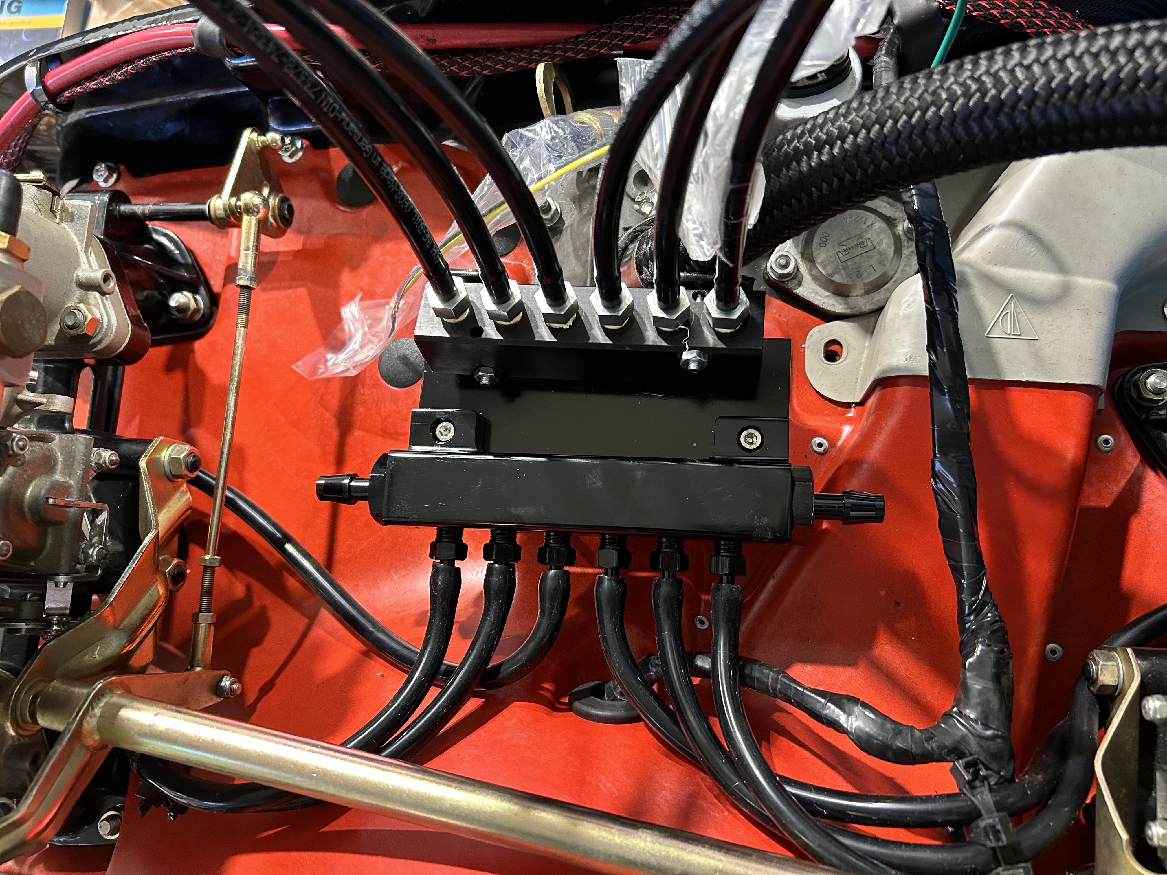

Equal length vacuum lines and manifold for a clean signal. Making headway Attached Image
