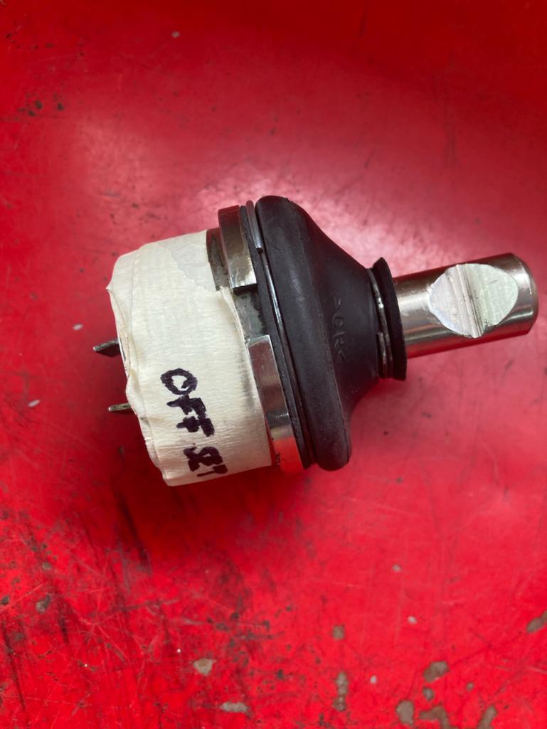

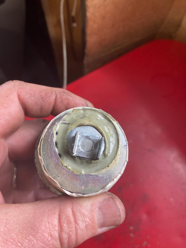

Offset lower ball joints are another legal way

How much negative will the offset ball joints get me? That sounds like a good compromise. I think 2 degrres is plenty?
brant
post Jan 21 2023, 01:09 PM
Posts: 11,951
From: Colorado
Member No.: 47
We’ve been running -2.25 front and -2.5 rear
I can’t remember what the ball joints come in
Vaguely want to say -1degrees
I never put these in as they were not needed
