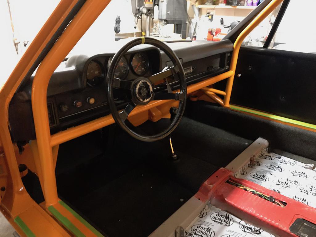

I finally got out to the garage and put in a few hours on the race car. Snapped a couple of how the cage ties to the rear suspension points, should it be of interest. Front of car is still buried under a dis-assembled fuel cell so couldn't get a clear view of that just yet. I'll have more time at it later this week when my wife goes out of town (IMG:style_emoticons/default/biggrin.gif)
So, speaking of rules - this car was most recently run in SCCA VP2 class. Rules for that seem pretty open -mainly dictated by displacement. Is that an option for y'all easterners?

I definitely have to take a closer look here. Svra, hsr are the biggest and have the tightest rules. Pca, vsca, and vrg are the less stringent ones for sure. Did you do the period gt reinforcement of the rear ear to firewall?

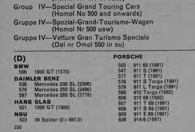

The 914-6R (or 914-6 GT) was a race car made by Porsche, it’s configuration were documented by the FIA in 2 Testblatt’s (group 3 and group 4) not the other way around. This was done with all Porsche race 356, 550, 718, 911…etc.
Most European race organizations classified cars according to engine displacement not performance like SCCA and modern IMSA. FIA is the predominant professional sanctioning body so it would be easiest for smaller sanctioning bodies to just follow FIA homologation standards because they are laid out with great detail and easily obtained.
The 914 in this configuration was accepted by AvD, ADAC, DARM, BRDC, l'ACIF, l'USA, IMSA, RAC and CASC to name a few. It seems to me that following SCCA rules of the era is eliminating most of the car in the world. SCCA race cars are a small subset of race cars in the world so why use their rules? I am not calling for the elimination of rules I am asking rules that were more commonly used like FIA. My answer is to allow a vintage car to conform to the rule for which it raced under backed by documentation.

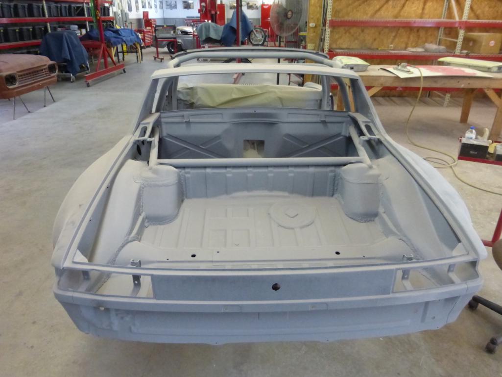

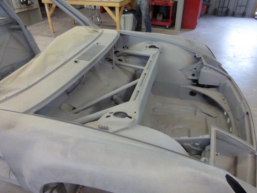

https://pbase.com/9146gt/9146gt_factory_rac...rs_sn9140430181
Those Rear Bars where added in Haist to make a Race....
My expierence ..oh you need the x =angle rear hoop support bar , and or foot well intrusion bars, front foot well ..results vary..

I had front footwell protection added just recently actually so good there. Nascar bars on the driver side as well. Also changed the rear bar to correct the angle for seatbelts.
That rear sway on the yellow car is very interesting....

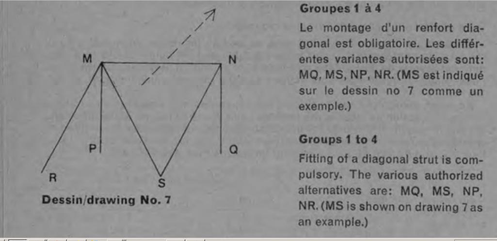

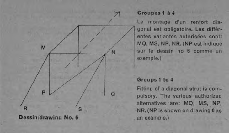

I found the Memo dated Feb 9 1971
1.3. Für den 914/6 wurde ein Zusatzbügel mit 2 Diagonalstreben
entwickelt. Diese Konstruktion entspricht zusammen
mit dem serienmäßigen Bügel den von der F.I.A.
geforderten Werten.
I will have to look for the FIA rollbar modification mandate for 1971
as Jeff pointed out it is for safety so who can argue with that?
gms
post Feb 16 2023, 03:54 PM
Post #31
Posts: 2,718
Joined: 12-March 04
From: Chicagoland
Member No.: 1,785

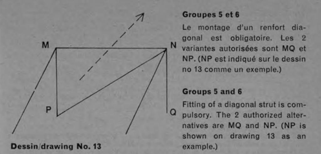

I found it! 1971 appendix J has the roll cage requirements

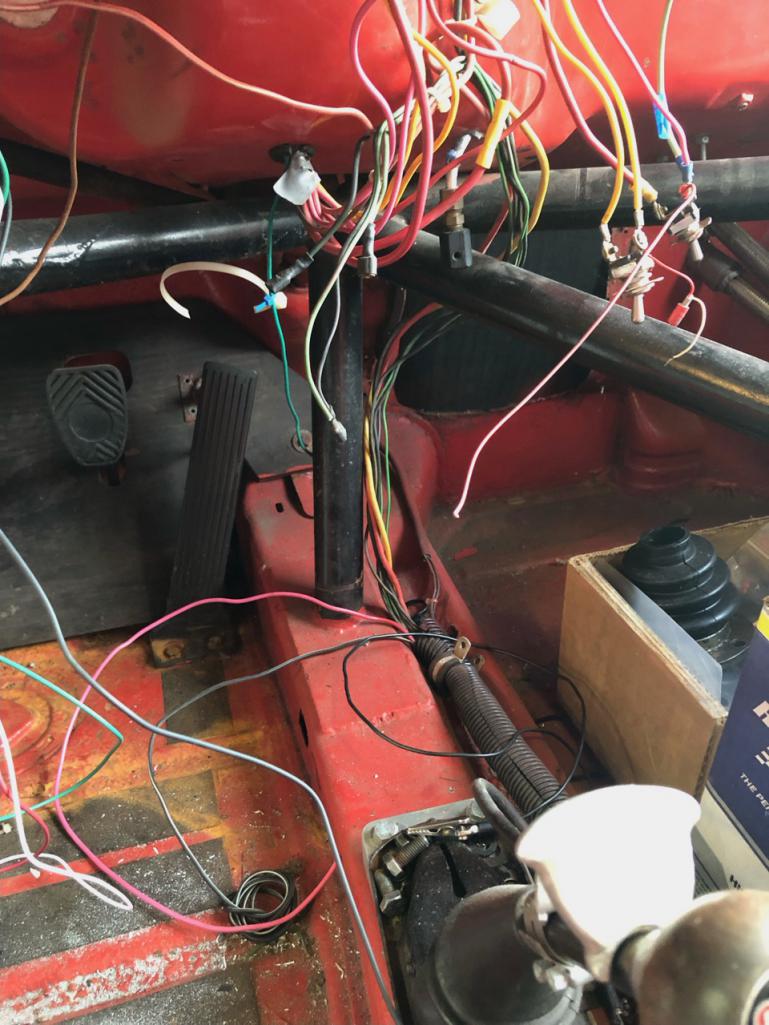

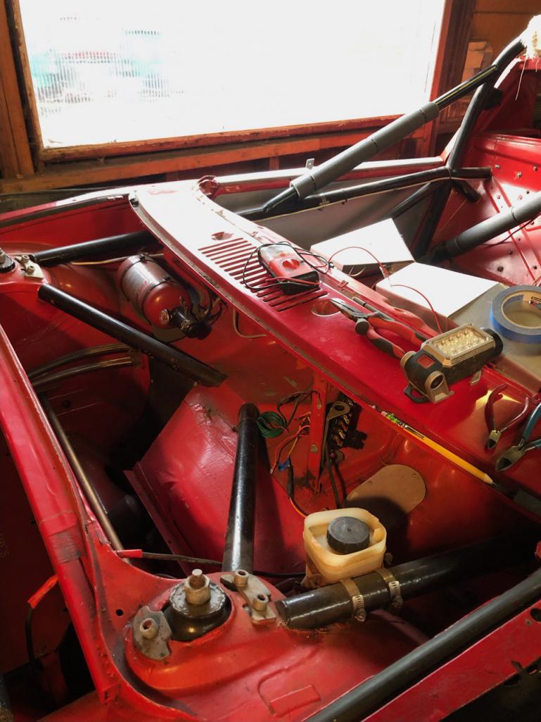

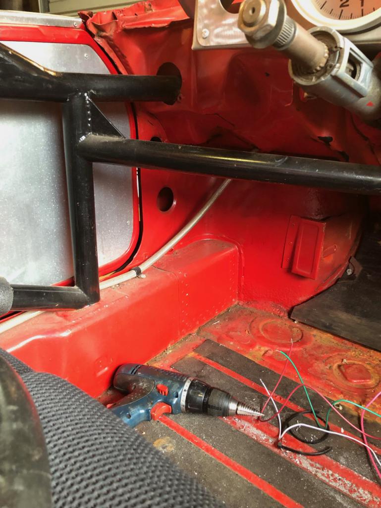

Here is how the front half is constructed. Please pardon the mess - I'm up to my elbows in a re-wiring project at the moment. There is a central vertical post mounted to the center tunnel that the diagonals from the front bars connect to, as well as diagonals from the side bars.
I have no idea who built this car. I've talked to a previous owner (2 owners ago) who said it came from Ohio. I don't know if it originated there. It was Orange at some point in it's life. Maybe from the factory. I don't know if it got color changed to red right off the bat, or if it happened later.
The car was most recently run is SCCA VP2 class, which is from 1.9 to 3.2L displacement. I'll be running a 2.6, so right in the middle of the class. Against 3.2L cars I won't have a chance, but I'm strictly out to have fun. What is kind of interesting is you can prep your car to whatever era from the rule book you choose that falls after it's manufacture date.

I planed to go vintage racing...but just got to old. I will return to the track for DE's. My cage to suspension points is very similar to Charles. Make chassis very stiff. Best, MarkAttached Image Attached ImageAttached Image

Not sure if i am a fan of the kinked bar in the front?

Not sure if the cage would pass tech under SCCA rules (used by most vintage clubs)
As the GCR says no bars allowed to pass through factory sheet metal
Maybe IMSA or FIA

I agree, the cage is 30 years old. It also had diagonal brace in the door opening. To hard to get in now so that got removed. Mark

That dash bar is low enough to be a knee breaker in a serious crash. For that reason I don't supply a dash bar with my kits that don't require dash removal for installation.
