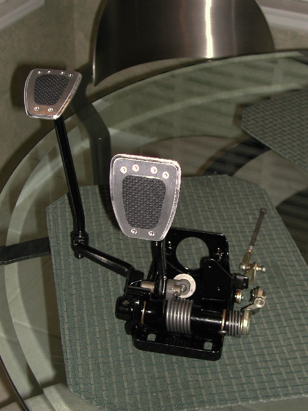

Latest project.... Pedal cluster rebuild.
This is really VERY easy to do.
I had the pieces powder coated. Installed new bushings. Cleaned up everything and reassembled.
I'm also installing AJ billet pedals (I've got the billet gas pedal too).

tahoward   Mental note to self: Must have billet pedals! ...   Jul 25 2003, 08:09 PM

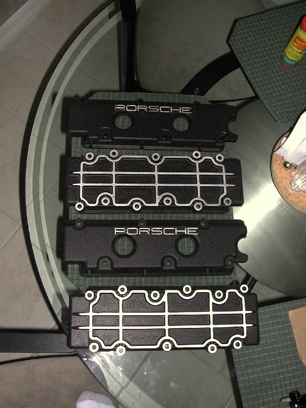

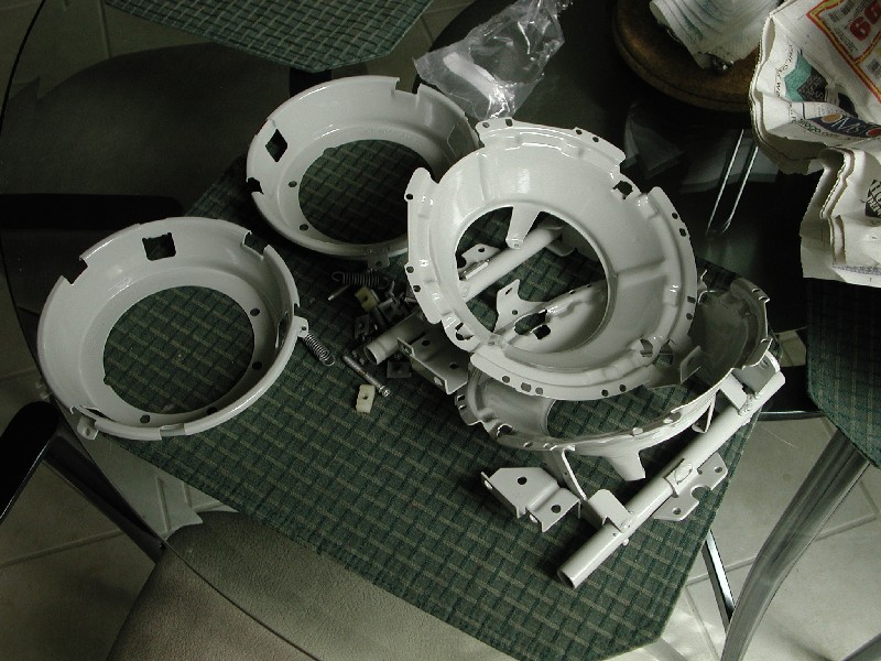

Qarl   Also had the light buckets powder coated... althou...   Jul 25 2003, 08:09 PM

Brad Roberts   Do not let Karl fool you. Not all pedal assemblies...   Jul 25 2003, 08:46 PM
Qarl   Dumping money is right... :bootyshake: I am to...   Jul 25 2003, 08:55 PM
Qarl   Oh yeah... the roll pin was a BITCH. I drilled ...   Jul 25 2003, 08:58 PM

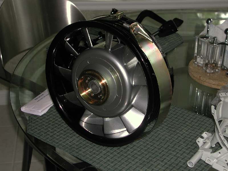

Qarl   Housing was powdercoated in gloss black Fan was b...   Jul 25 2003, 10:01 PM

Mueller   Karl, It's great to see progress like this :...   Jul 25 2003, 10:56 PM
Qarl   Mueller... Yes the lower valve cover ribs were ma...   Jul 25 2003, 10:59 PM

Qarl   finished replating the hardware for the front ligh...   Aug 24 2003, 06:24 PM
