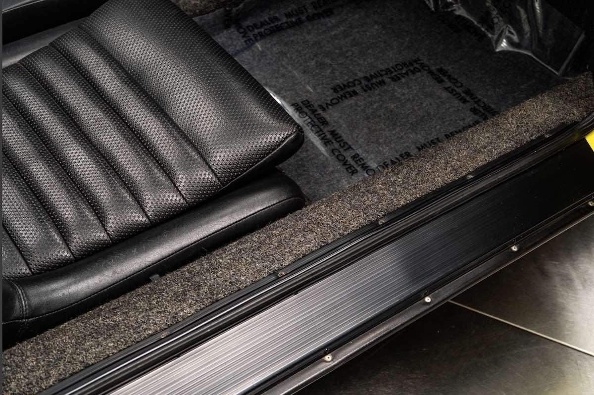

Maybe George will chime in on on this? If anyone knows orginal 914s its George.
What are the factory original rocker panel rivets? Plastic (clear or black) or aluminum (mill finish)? The same or differnet over the model years?
@dr914 @autoatlanta.com

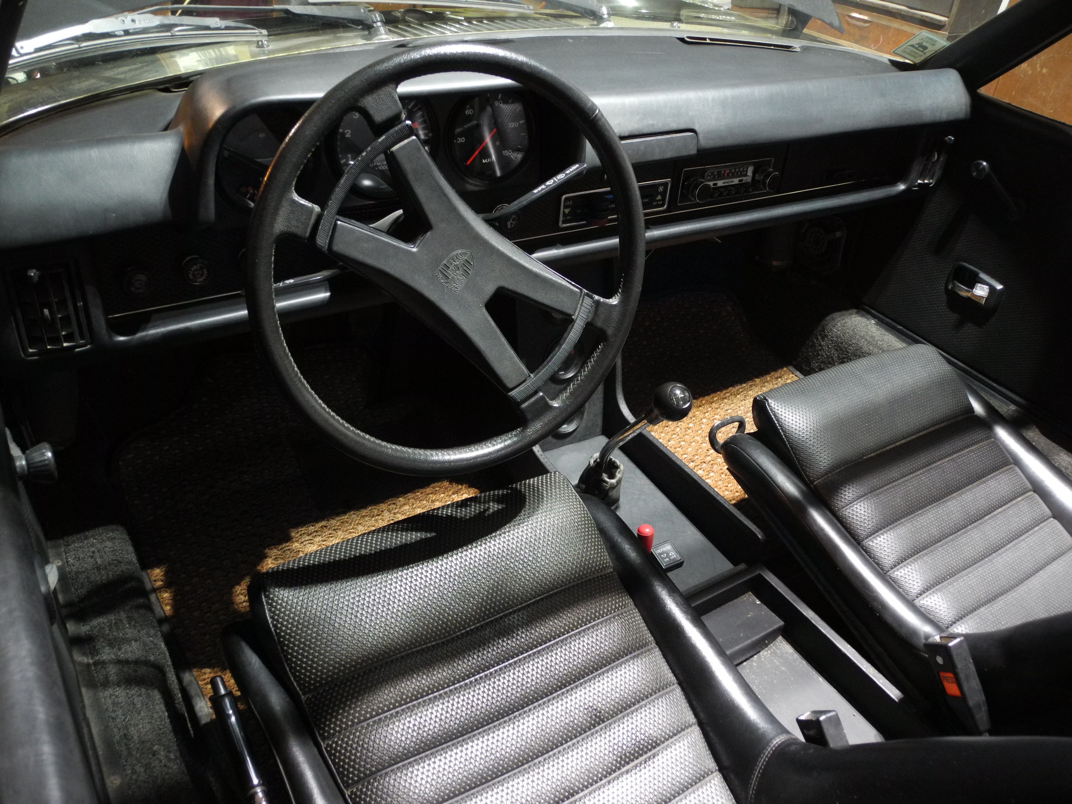

QUOTE(JeffBowlsby @ Mar 7 2023, 10:28 AM) *
i think you are on to something mr. b
its maybe an extensive change in mid 73 when they change the inner threshold plate from alum to plastic?
i've done a bit of searching back through the L jet files i have which are all 74 and 75 1.8s.
i know this from my own car (and PET data).
when the thin inner most threshold piece was changed to black plastic the screws changed too. the screws received additional cupped raised washers to help with distributing the load and keeping the plastic straighter. very few cars seem to have the correct screws surviving. i have the original screws on mine for those very inner most thresholds and a few of the ones i have on file have them as well. that helps with knowing you might be looking at something trustworthy throughout sill area. the earlier cars pre mid 73 just have a screw into the aluminium earlier inner most threshold.
they changed the outer sill threshold piece to plastic at the same time and the rivets in that changed to black. all the examples on file match mine.
they had been white in the pre mid 73 cars to fasten the alum threshold.
i looked up my first addition restorers guide to authenticity.
its getting a bit old now (out of date?). i don't have the more recent edition.
down the back on page 78 is a photo and description of the earlier alum threshold. also shows rocker panel. the rocker panel is held on by the same white plastic rivet. so i believe @914werke is right about that. when it comes to earlier cars.
however there is no detail or description on the post mid 73 in my edition of R G.
but---everything i have on file from L jet research which are in some cases drawn from BAT archives has silver alum rivets fixing the outer sill rockers. i think i have got at least two original examples i would trust to a reasonable degree on that. they could have been black rivets that the paint has worn off. but they are silver now which indicates alum not plastic.
it could be interesting. they might have changed the rivets in the outer rockers from mid 73 on. your example you have posted where the owner assured rockers had not been off and the rivets are silver alum seems to agree with everything i have collected on file.
i can't say for certain what i did back in the early 90s when i took the covers off was a like for like replacement. but i used to be fairly careful with detail like that and i feel sure i would have replaced what was there to match. but who knows.
i guess the doc will have the full answer.
but there appears to be something in the differences being brought up and contested.
@914werke is definitely correct about the early cars pre mid 73.
@JeffBowlsby may well be correct about the later cars post mid 73. something different appears to be going on there.
a 74.
not mine but identical to mine.
from L jet archive. a pretty original car in all respects.
not a restoration
correct inner threshold screws and seems to have alum rocker rivets. look silver.
matches @KELTY360 's rockers and your example of a 40,000 mile car.

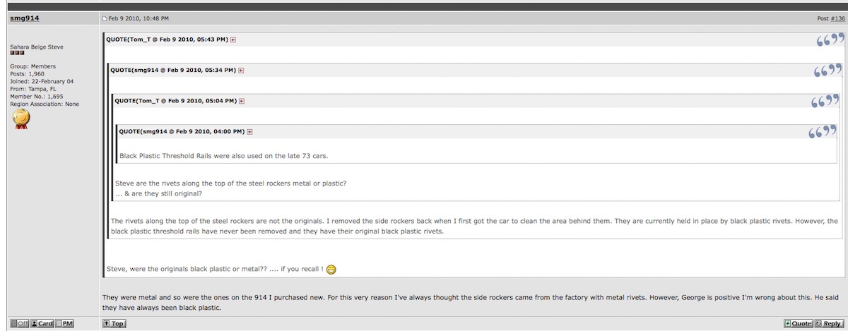

i thought to myself i know there is an in depth photographic record of S G's sahara beige 74 2.0 in originality section. went snooping to see if there were photos of sill.
uncovered a very interesting exchange.
unoriginal sill rivets - incorrectly restored? (IMG:style_emoticons/default/confused24.gif)
http://www.914world.com/bbs2/index.php?sho...1921&st=120
seems to be a bit of uncertainty around the business of what was on a 74.
and maybe 73? leaving aside what was on an early car.
the black plastic rivets that S G quotes dr914 says were on all 14s def agrees with my files on 75 1.8s. they sure look like they got black rivets.
S G's comments about what were on his super clean super original car when he bought it, before he changed them to black, def agrees with my files on 74 1.8s and the 74 cars being discussed here a page earlier.
DBF
