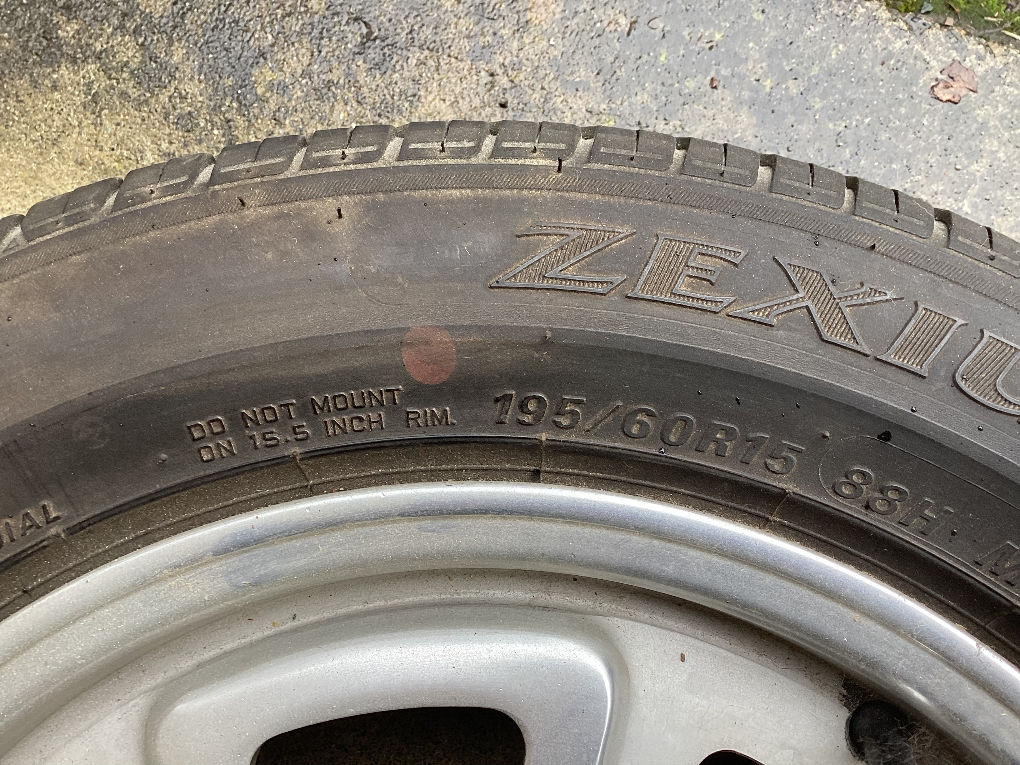

rhodyguy   On 5 1/2” wheels. I imagine disregarding this co...   Feb 7 2023, 12:21 PM
Chris914n6   You only need to roll the rear fender 1/2" or...   Feb 7 2023, 12:29 PM
rhodyguy   The use warnings are enough for me to forget the V...   Feb 7 2023, 05:56 PM
