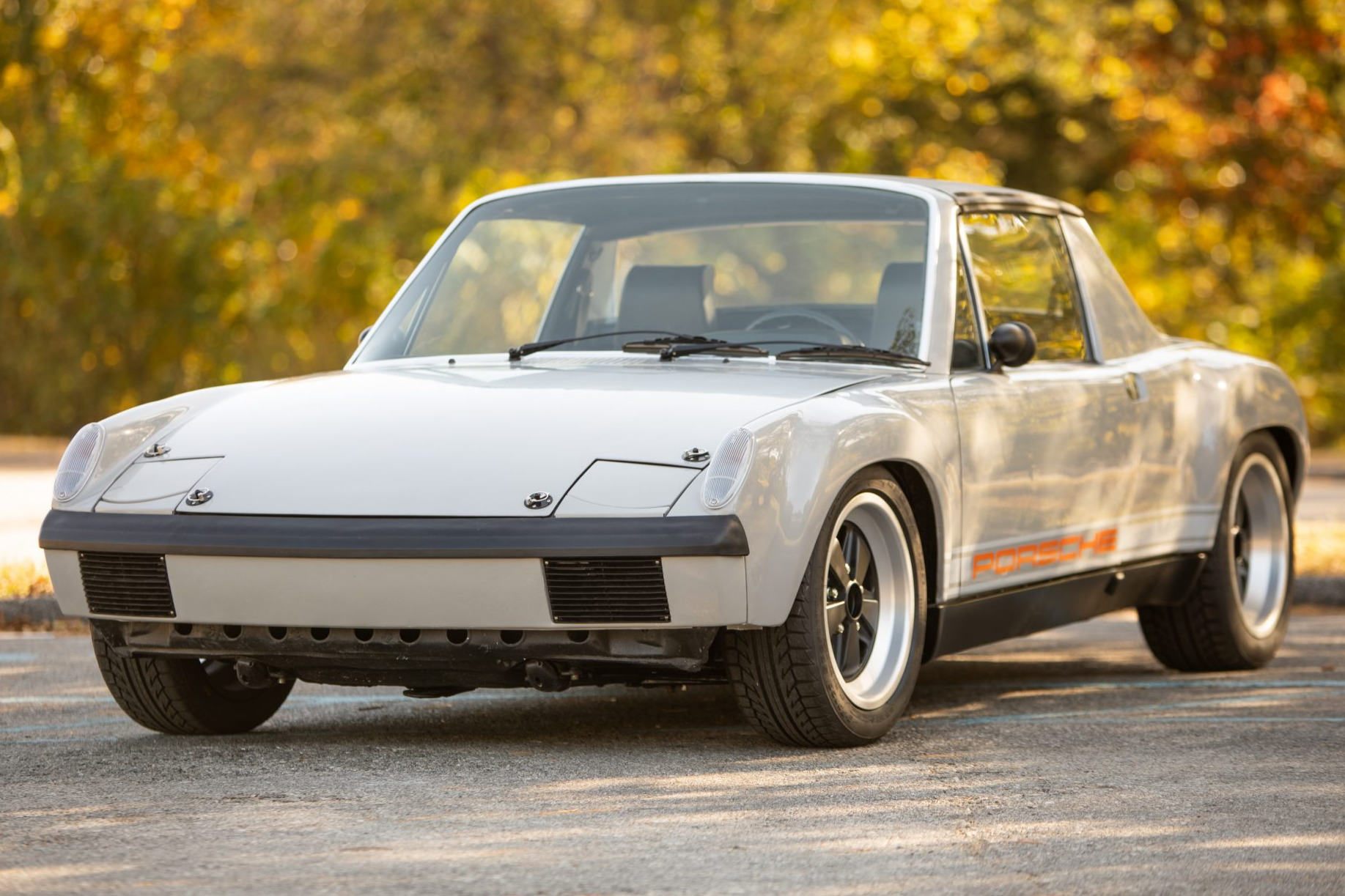

I really like this color and trying to find out more than just "grey".

Not sure who built it, but it says the color is Chalk/Crayon (M9A) in the description.

Here's his build thread:
http://www.914world.com/bbs2/index.php?sho...=348567&hl=
Per his post in the thread: "Body rec'd 2 coats of Nason high build primer, 3 coats Axalta Challenger base (Porsche Chalk/Crayon) and 4 coats of clear. "

I just looked over the BAT pictures and think while this car looks nice at first glance, it seems like someone spent a lot of time to make it look pretty but made some decisions on the job that don't make sense. The engine compartment looks a bit rough, they left off both front and rear valances, and the front has no plugs in the bulkhead holes, so air and water will just be blown into the front trunk with gusto. The muffler is missing most of the bolts that attach it to the heat exchangers and it isn't even attached to the support bracket. These are simple things that are missing which may indicate that someone just tried to wrap things up quickly to sell. Who knows what other short cuts were taken. Thankfully the buyer didn't pay some crazy high BAT price for the car.

Probably got in too deep and had to bail, could be a ton of reasons. Agree with the hasty assembly. Seems to lean as well, setup and ride height not finished. That was a while ago, hopefully all is completed now.

I was thinking Audi Nardo Grey, but that's a little dark. I swear VW/Audi has a grey that looks just like that.

Not a huge backstory... I just really enjoy briging my visions to life. This was the very first car I did major metal fabrication on (cutting and welding the fenders) as well as a full body base/clear paint job with a compressor and spray gun. Prior to this, the most I had ever done was a little welding of some exhaust components and grafting in a small panel on another car. Any paint work had been a rattle can, blend and sanded. This was a pretty big project and undertaking. One I was quite proud of. Not perfect, but far better than many, many other novices out there.
QUOTE(jvmarino @ Feb 9 2023, 08:40 AM) *
The engine compartment was never touched, nor was the exhaust. The engine and its components are exactly as the car was when I bought it from previous owner in Kentucky. The only thing I did was change the oil and gear oil. No short cuts taken in my work. The lack of valances was my own personal liking and part of the restomod look I wanted.It was sold with the intention of whoever bought it would complete and finish it to their liking. It was well known the engine wasnt rebuilt or reworked in any way.

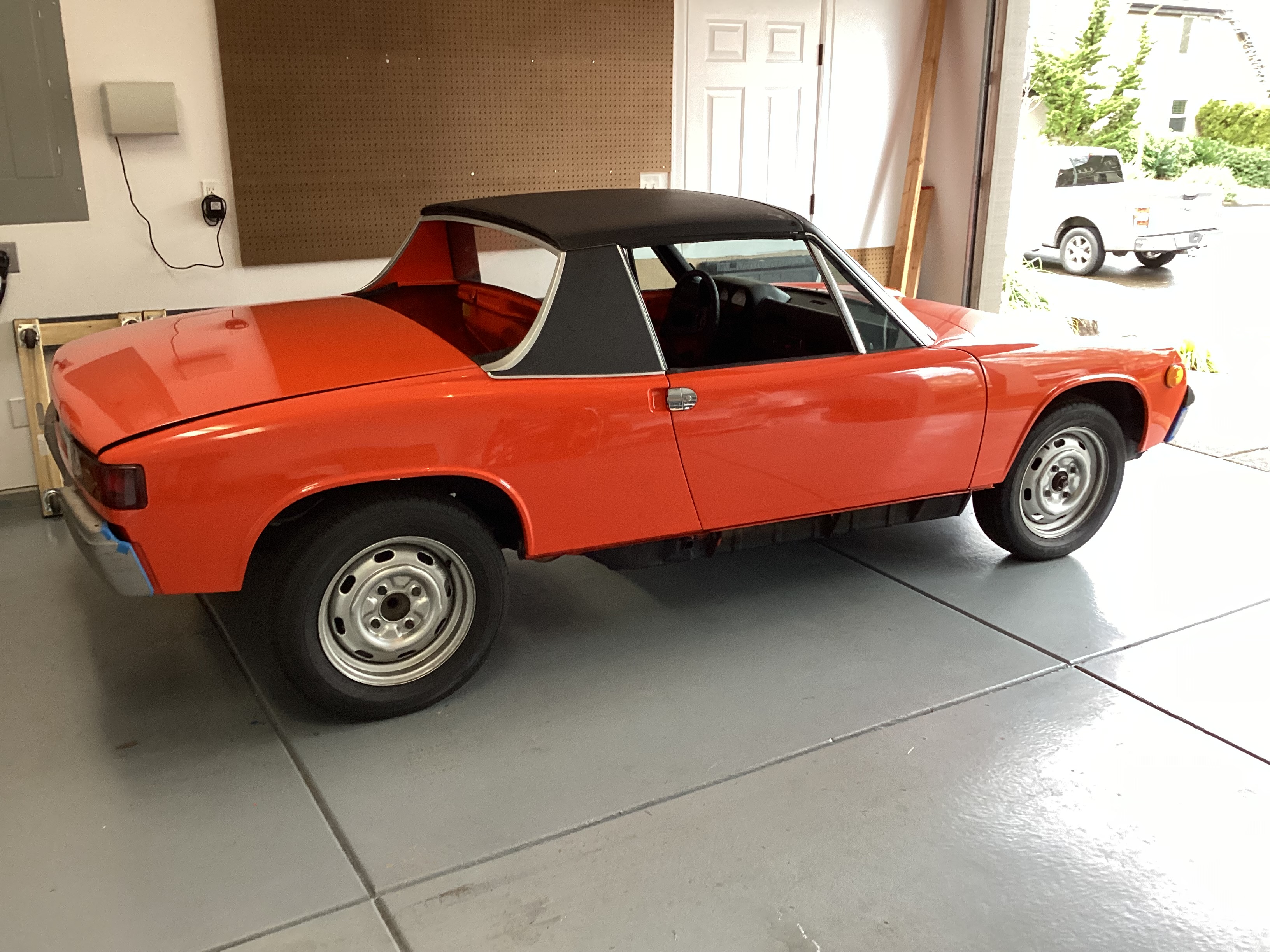

Then bought and flipped a few Boxsters, retaining one for myself. I recently built a house and a new garage to allow me to grow my hobbies. I just recently acquired a 1970 signal orange 914 which will be the next project. I will start a new thread with pics and progress once the car is in my possession

The car is not in my posession yet, but here are a few pics of her where she's still residing until transport is squared away.

I am thinking it would probably make sense not to drive it home.
