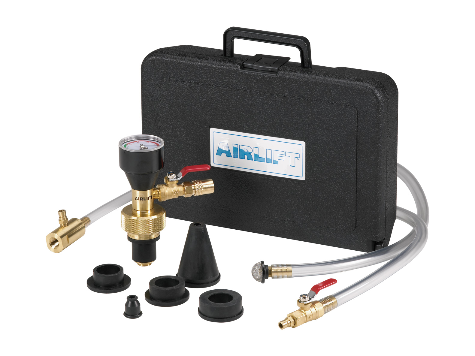

L-Jet914
post Feb 18 2023, 06:44 PM
Posts: 358
Joined: 24-October 12
From: Davis, CA
Member No.: 15,080
I've worked on EJ's as well. I think the best invention to come out for EJ's, FA's is the vacufill system that pulls the cooling system into a vacuum, prime the fill line shortly, pull another quick vacuum, then fill the cooling system. I ran into many an issue with EJ25's in the late 90s to mid 2000s outbacks. Fans would come on high speed and I only got cool air through the radiator. I had to burp the system multiple times. As for the VW Vanagons which I have also worked on, they have a bleed valve on the top of the radiator. Before the vacufill systems arrived we would raise the front of the Vanagons and burp the cooling systems that way until all of the air was out with heater on full hot. I have the Snap-On version where I work but AirLift was the first version I heard of when the tool came to the market. I use it on the occasional MR-2's that come in and the FR-S/GT 86's (Subaru BRZ) and all of the other Toyota's that I work on at the dealership. Cuts cooling system bleeding time down significantly. You can also put a coolant fill funnel that attaches to the radiator cap/neck to do a final check if you like. I tend to slightly overfill coolant reservoirs as I know it will burp a little more after the service.
L-Jet914
post Feb 18 2023, 06:48 PM
Posts: 358
From: Davis, CA
Member No.: 15,080
This is the tool.
jeepguy06
post Feb 18 2023, 08:35 PM
Posts: 45
Joined: 11-January 21
From: portland or
Member No.: 25,060
QUOTE(L-Jet914 @ Feb 18 2023, 07:44 PM) *
I got the bucket set up that goes on the radiator cap on the fill resivor that's next to the intake manifold. I also had an extra hose line on the radiator u got and used it to bleed the air out of the front part of the system but will have to check it again.
Thanks for the ideas.
