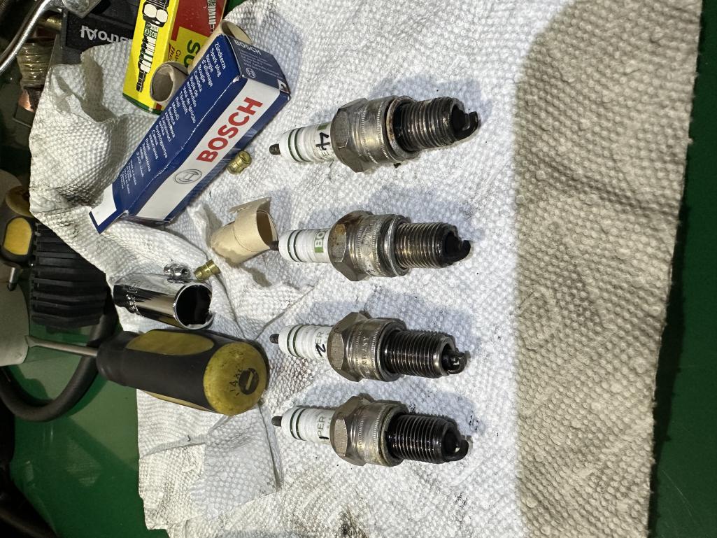

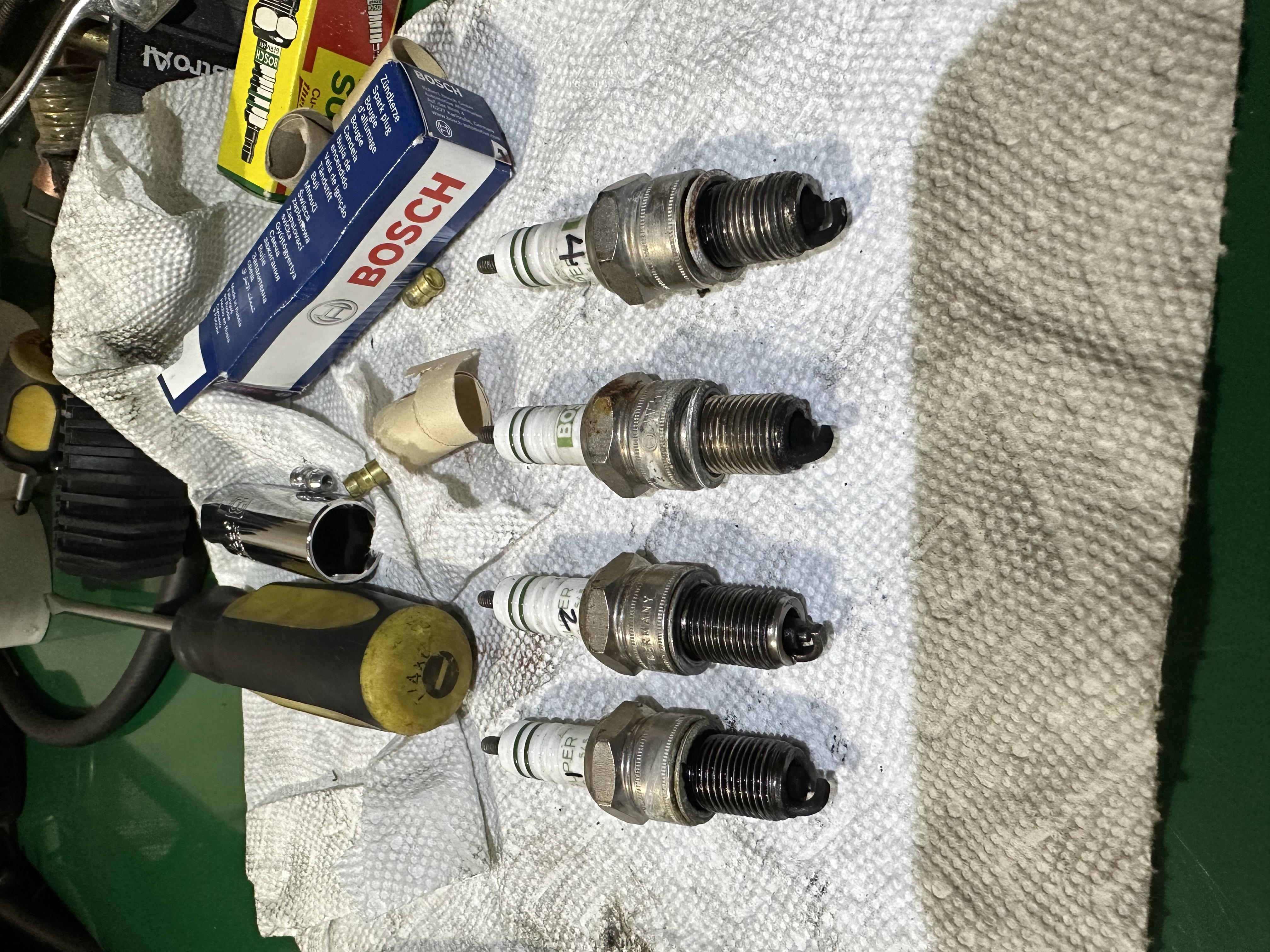

Finally got some time to continue searching for any vacuum leaks and doing a proper tune up with new sparkplugs and seals for injectors and intake plenum gaskets. Going this weekend to Carlise Central PA swap meet to buy seals for 914. The old sparkplugs that I removed looks like cylinders 1,3,and 4 are heavily running rich with lots of soot (see photo.)Attached Image

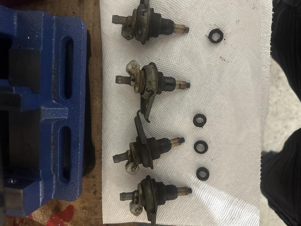

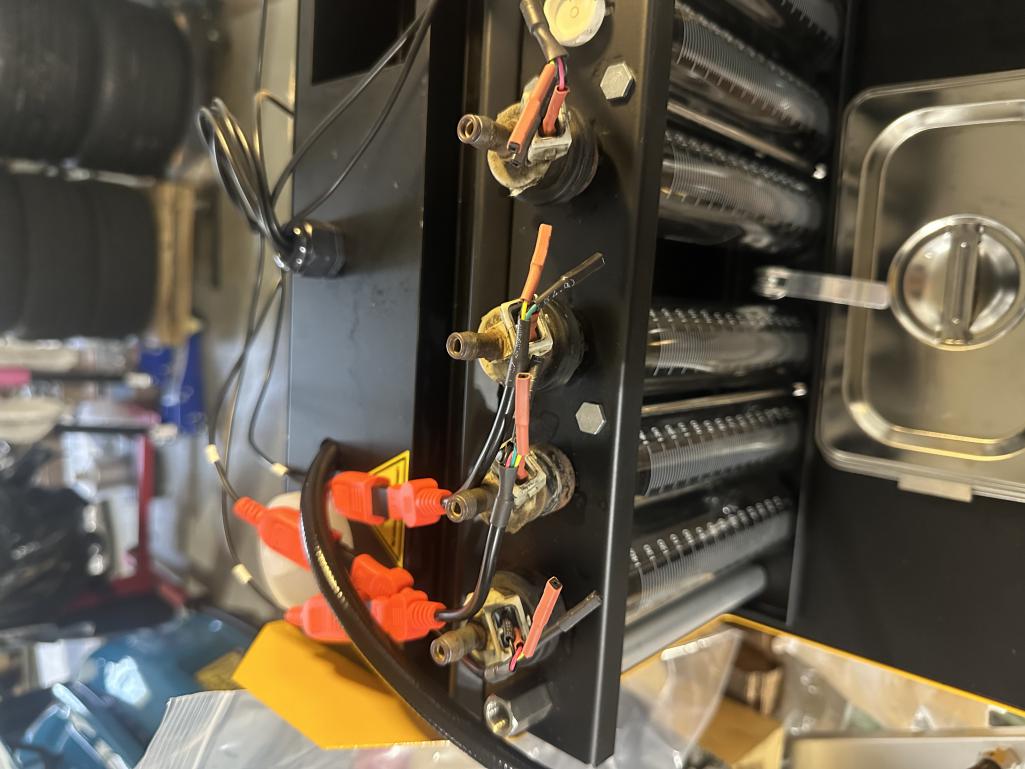

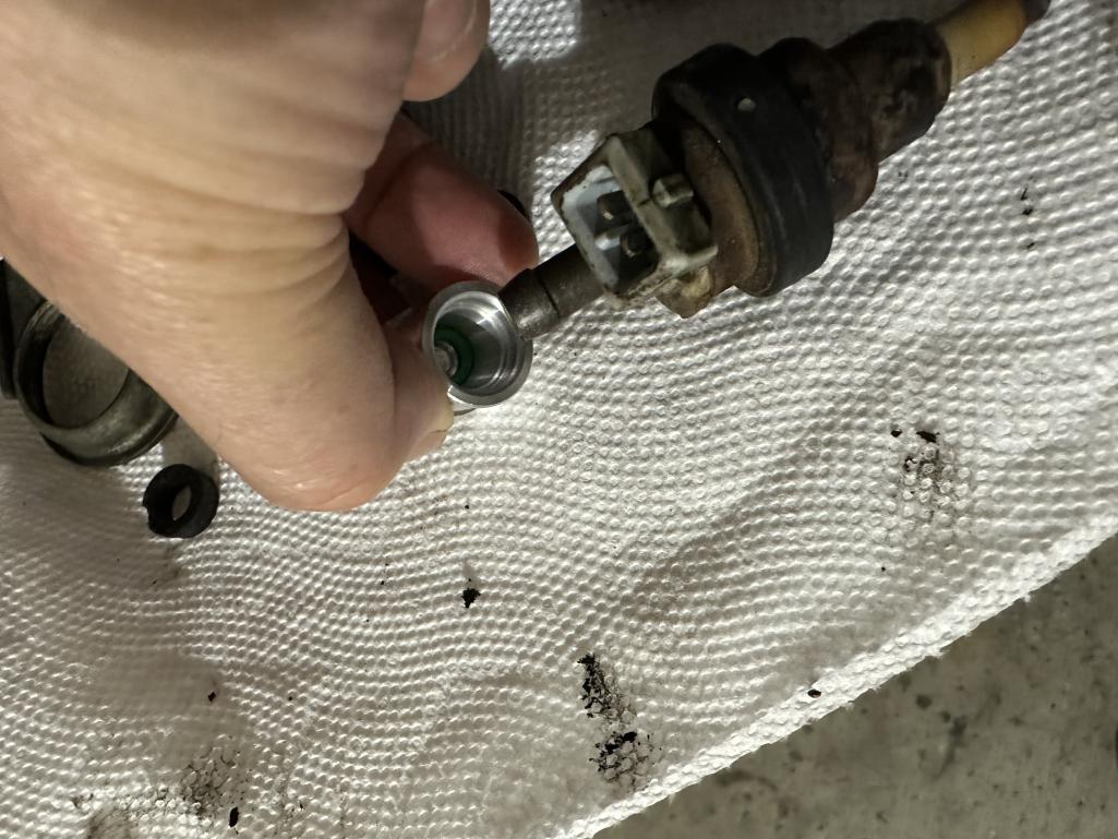

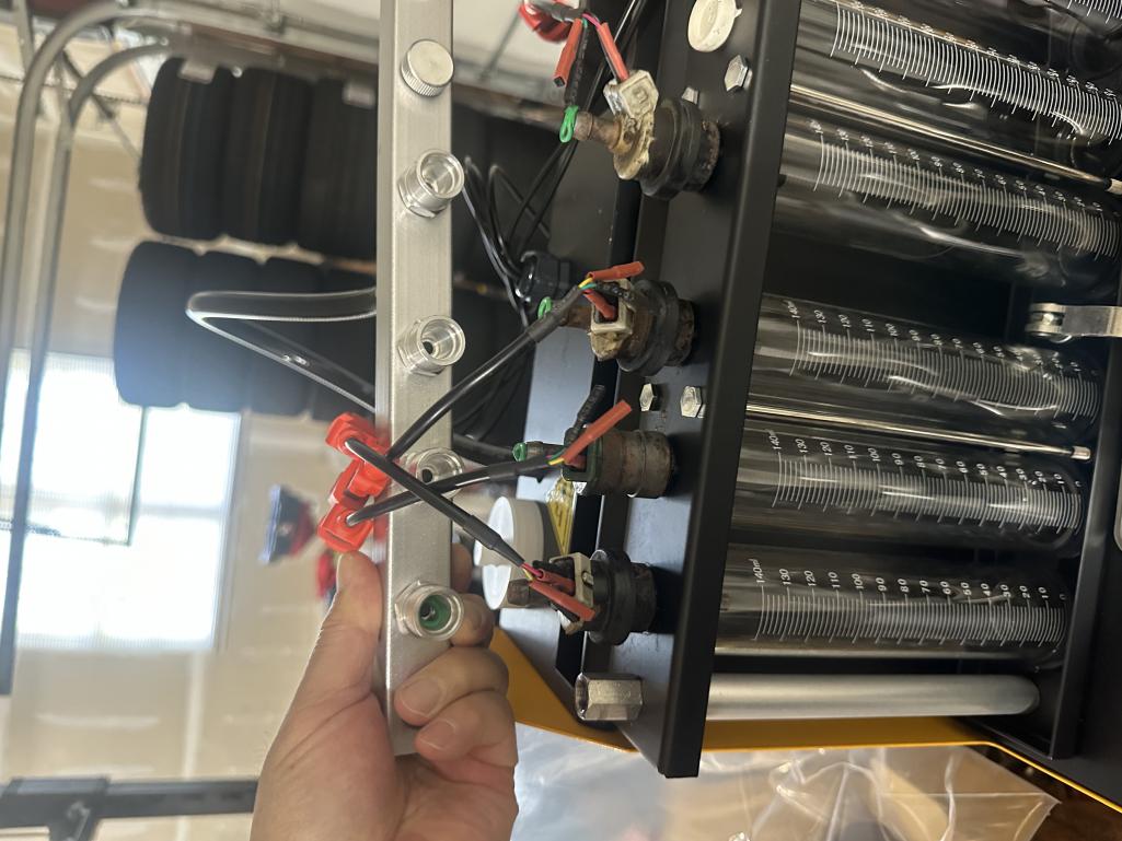

Well your wish has just been granted.I took out all 4 injectors of which 2 inner seals look suspect and have new seals to reinstall after testing. The machine came with very little info on how to assemble and use but any mechanically inclined person can figure out how to set it up. The way in which the fuel rail gets sealed to the inlet of the injectors requires a rubber O-ring that gets compressed down by the fuel bar and O-rings were not provided with the unit. The posted photo shows a green O-ring that was used to seal the adapter to the top of the injectorand when I tried to replace the #2 injector with a 2.0L injector that O-ring seal was not in place or was distorted) I went to Harbor Freight and got a box of assorted size O-rings. As you will see on my YouTube pfan12000 channel there were some short videos where I had problems with leaks and such which were corrected. Overall the machine did as advertised and I am quite satisfied with the results of running those tests (02 setting is idle speed , 03 is medium speed, 04 is fast speed, 05 is acceleration, etc). It appears my #2 injector is not spraying like the other 3. I will try to sonicate that injector to see if it can be cleaned to work like the others.

The tests showed that injector #2 was spraying or leaking much more fuel than the other 3 so when given throttle that injector most likely flooded that cylinder and messed up the fuel/air ratio that stalled the engine.

The problem I had initially trying to set up the machine was getting the fuel rail feed to seat properly onto the injectors. The green O-rings I used were not right and I had lots of leaks that were fixed by using the brown Viton ones that were the right size as shown in the photos.
I paid $500 for CT200 from Amazon Prime. I used it to clean all 4 injectors and got them to behave the same through-out all ranges of flow rate (idle, medium, fast, and acceleration). Checking the web for new or re-manufactured injectors that would work for 1974 914-1.8 found them on PartsGeek for $62 each + shipping is going to cost at least $250 for a set of 4.
