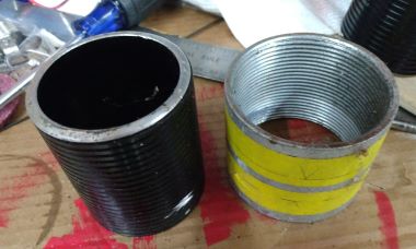

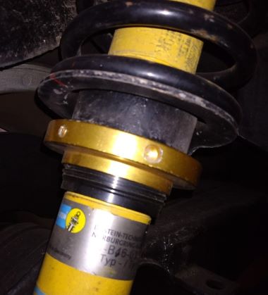

I went to my local salvage yard and found pipe collars to fit over the the threaded part of the adjusters. I had to hog out the threads to make them fit and cut them to 1". The collar fits on top of the adjustment ring and the spring perch sits on top of the collar.Attached Image Attached Image

Interesting solution.
It looks like the stock spring OD isn’t too much larger OD than the “race” springs? Nice to see the picture since I don’t have parts right in front of me.

QUOTE(Geezer914 @ Mar 2 2023, 04:41 AM) *
Very clever, a spacer! (IMG:style_emoticons/default/smilie_pokal.gif)
That is exactly the type of answer/solution I was looking for! (IMG:style_emoticons/default/smash.gif)
Thank you!!! (IMG:style_emoticons/default/beerchug.gif)

QUOTE(Geezer914 @ Mar 2 2023, 07:41 AM) *
Geezer, did you already have a Ground Control or similar system on the rear? The gold anodized collar looks like their component. I’m unclear how you incorporated that with the salvage parts. Can you elaborate just a little more?
