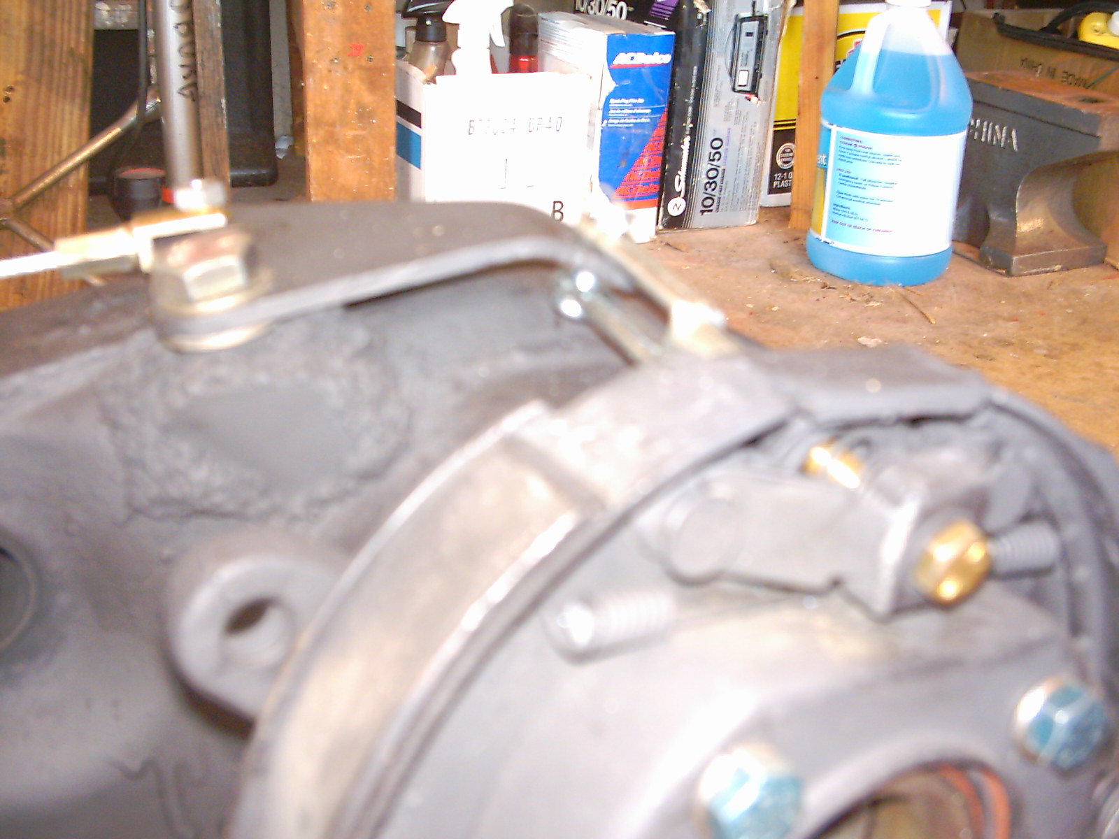

Here is how I made it work
911 rear brakes - e brake was shoes pulled by lever

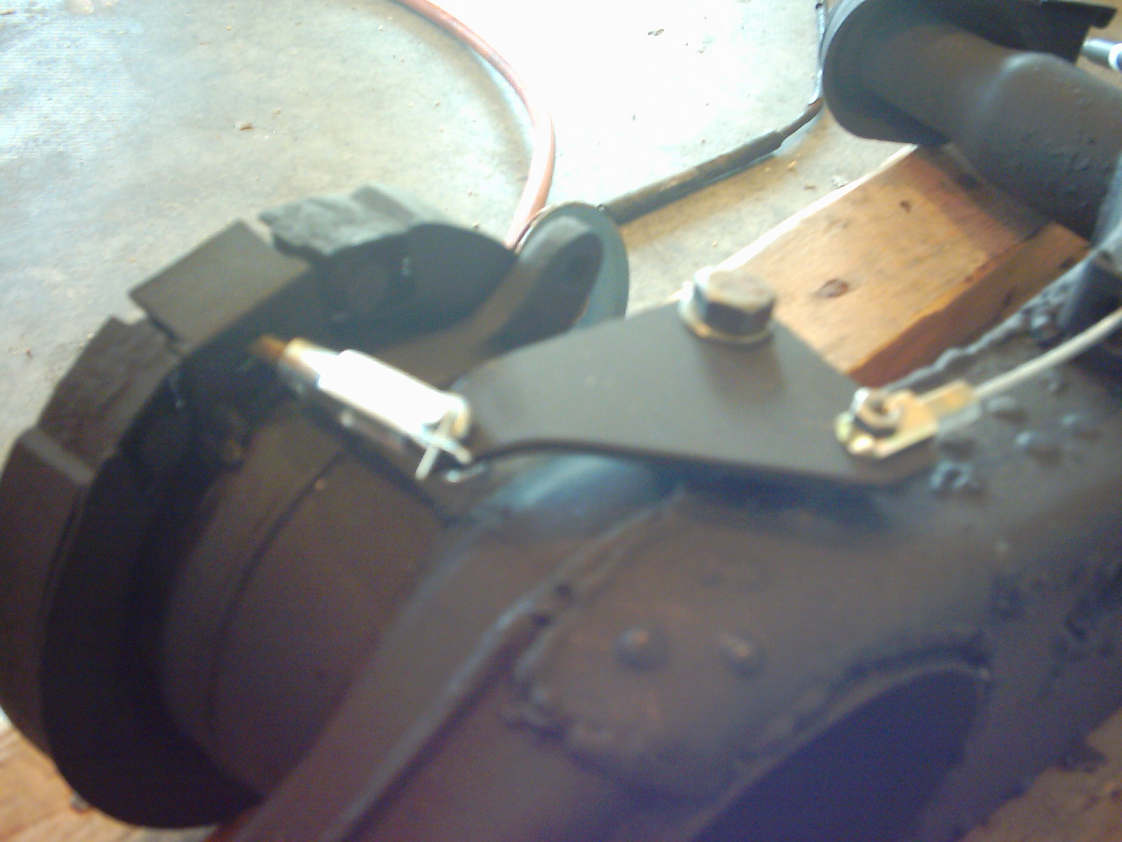

See photo
I’m using the vented rear disk cut by 3 mm with the /4 caliper using the V kit, the spacer for the brake shield has to be placed on the outer side of the caliper instead of between the caliper and trailing arm for the correct spacing.
