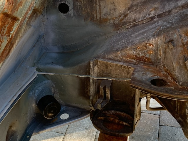

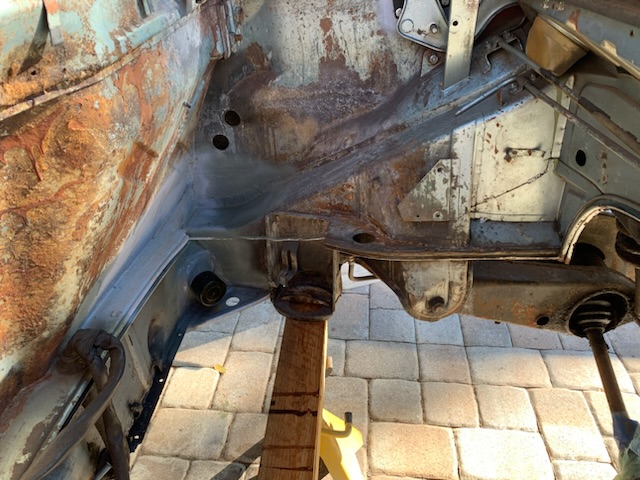

After the hell hole repair, I have the engine shelf to repair/replace. Question for those of you who have done this before, I’m trying to decide on splicing in a short repair section or trying to extract the remaining original panel and install the whole new RD panel. The latter being the most work.
Not a special car in terms of rarity, options, or other. Been doing lots of rust repair. Just not sure how to tackle it yet.
Thanks
Look forward to hearing your feedback.

Done it both ways.
Actually there are 3 ways... Complete R&R.
Patch it & replace the seal rail whole and,
Patch it & try to splice the seal rail as well.
Since most of the shelfs now come with rail attached I tend to R&R complete.

I typically splice it right at the rear of the suspension ear but not the channel, I replace that fully.

QUOTE(914werke @ Mar 11 2023, 05:57 PM) *
Done it both ways.

I spliced a section of shelf, about where yours is cut off.

QUOTE(Dlee6205 @ Mar 11 2023, 09:04 PM) *
Kind of what I was thinking to do. But how do you find the spot welds in the old channel to get it removed?

QUOTE(seanpaulmc @ Mar 11 2023, 10:54 PM) *
I use a small wire wheel on a drill to expose what I can.

Just to be clear…
You don’t just replace the channel for rubber. Go to restoration design and you’ll see a picture of the whole engine shelf with the channel already attached.
On mine I replaced almost all of it… but made a cut near the rear and butt welded that back part.
Not sure if this clears it up. Also… restoration design has a video about installing the shelf.

QUOTE(Ishley @ Mar 12 2023, 02:02 PM) *
Just to be clear…
I appreciate the explanation. Yes, I already have RD part in hand. It’s so well made which is why I was thinking of attempting to do the whole part.
However, splicing in the forward portion where the engine shelf is the most narrow seems like a good alternative to tearing into the rear portion where it is solid and in good shape…and has paint.
Again, I appreciate the feedback.
