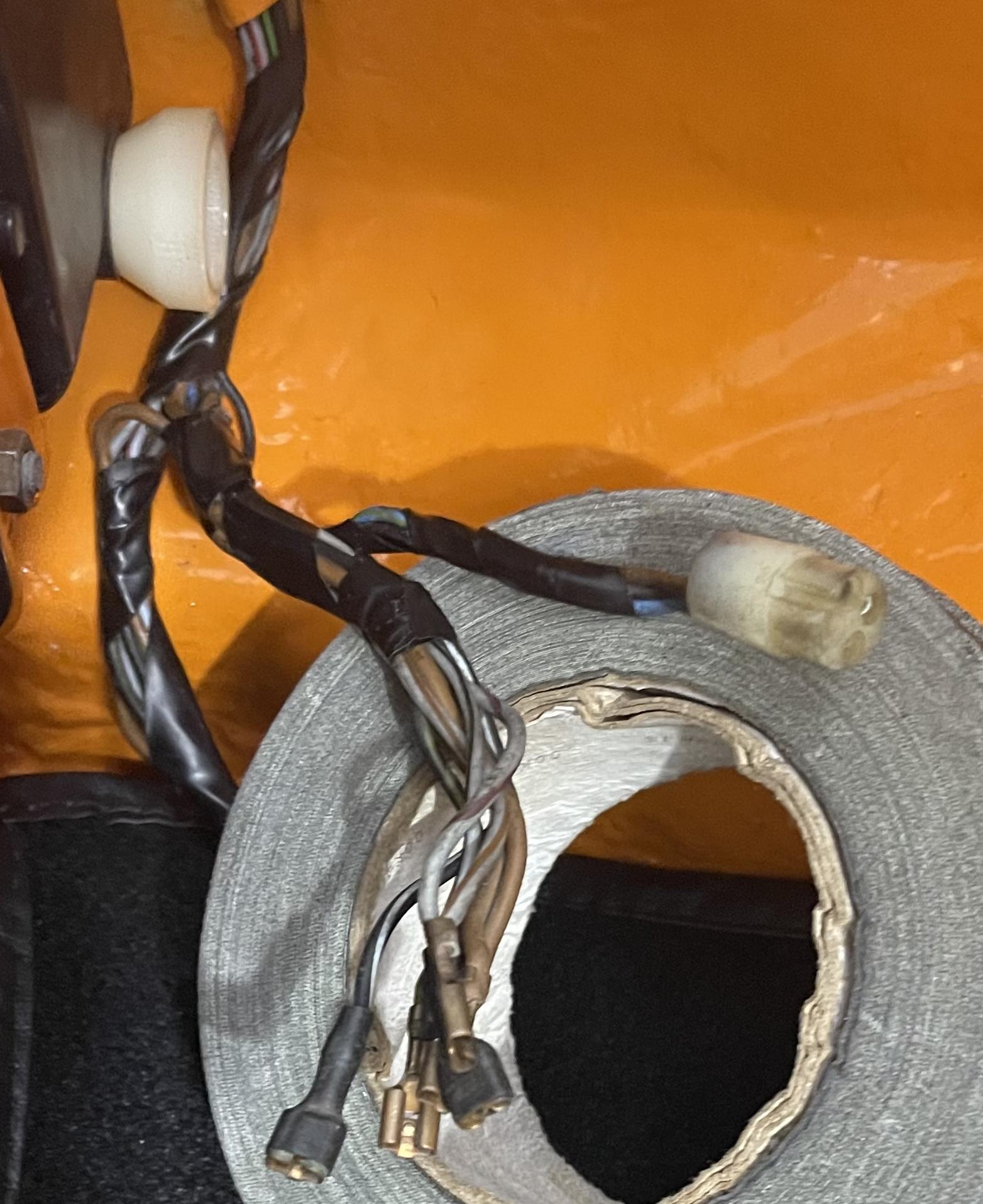

Car came from Nevada but I can't tell if it was originally a California car. It still has injection but doesn't have a cat or smog pump. Doesn't look like it ever had either but I'm wondering since I'm going to try and register it here in California. Thanks in advance!!
Here is the Vin:

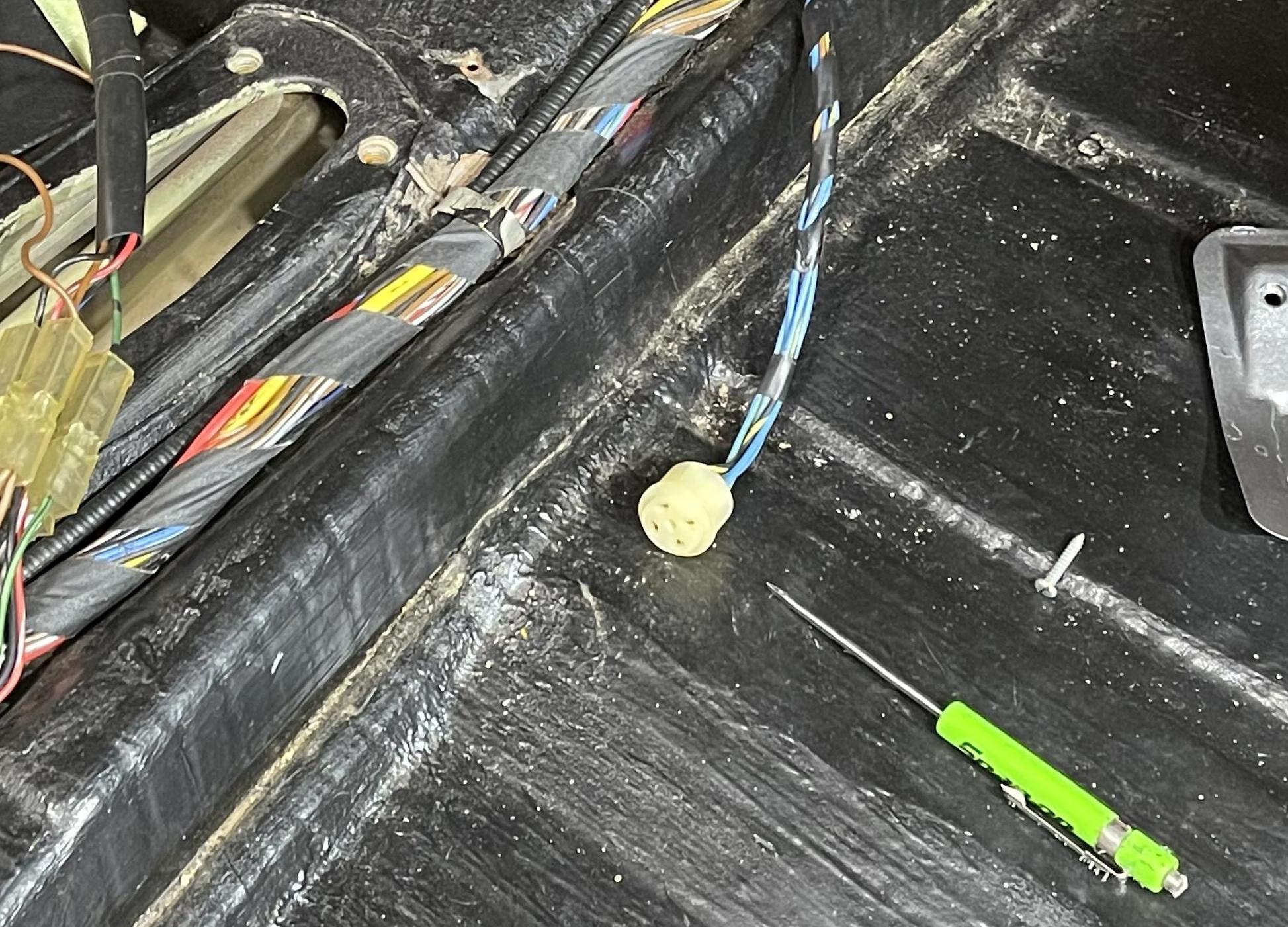

A 1976 California car will have a EGR lamp on the dash and a EGR reset box under the
passenger footrest

Thanks. I'll be able to look at the car more this weekend and see what's missing. Might be a bit of a project to get it Cali legal.
passenger footrest
and something like that on the drivers side in the rear trunk. If you have these and they are not plugged in to something it's a 49 state car.
