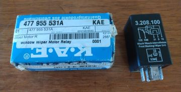

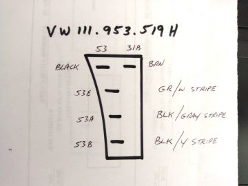

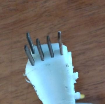

1975 914. Installed intermittent wiper relay. Wipers worked but would randomly turn on while driving. Removed relay, wipers worked fine on low and high. Check other posts, problem: switch not grounded. So I purchased a VW111.953,519H switch that has the little ground post on the upper right screw. Installed everything, turn on the wipers with the intermittent relay and the wipers do not shut off. Pulled the relay and the wipers only work with the stalk all the way down in the intermittent position and in the off position. If I move the stalk to the low or high position, they do not work. (IMG:style_emoticons/default/headbang.gif) (IMG:style_emoticons/default/headbang.gif) (IMG:style_emoticons/default/headbang.gif) It appears I need to switch some wires on the motor. The VW111.953.519H Wiper switch was pictured in a post as the switch needed for intermittent wipers. The diagram is the VW wire diagram for the wiper switch. What is the diagram for a 914? What I am asking is what wires from the motor need to be switched to correspond to this switch?
