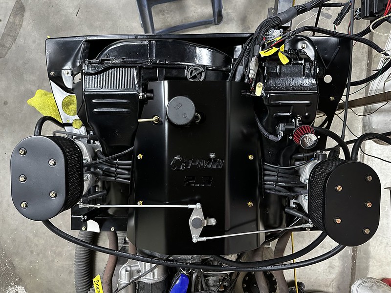

About 18ish months ago I bought into a new engine program Eric and PMB were starting up. If you have seen me in person I've probably talked your ear off about it. Sorry about that, I've been pretty excited.
Mine is No2 off their line, and its crated up in Utah waiting for the shipper to pick it up.
So its really real time here in Dallastown, and I've started getting my 2056 ready to come out.
The new engine!
(IMG:http://www.914world.com/bbs2/uploads_offsite/live.staticflickr.com-1435-1679065407.1.jpg)
(IMG:http://www.914world.com/bbs2/uploads_offsite/live.staticflickr.com-1435-1679065409.2.jpg)
I *think* (and could be wrong) that Eric also used my motor as the promotional model for Facebook and his Web storefront - though that could have been Risdal's engine which was right behind mine.
Eric and Larry did a lot of testing on the #1 engine in Jim's car, got a lot of driving data at Red Rocks last fall, and then had to wait on components to come in that resulted from that real world testing.
My engine was crated last week. I asked Eric to include some other things (including his new brake lines and new pads), paid the final invoice for parts and shipping and the engine will hopefully be in my garage next week!

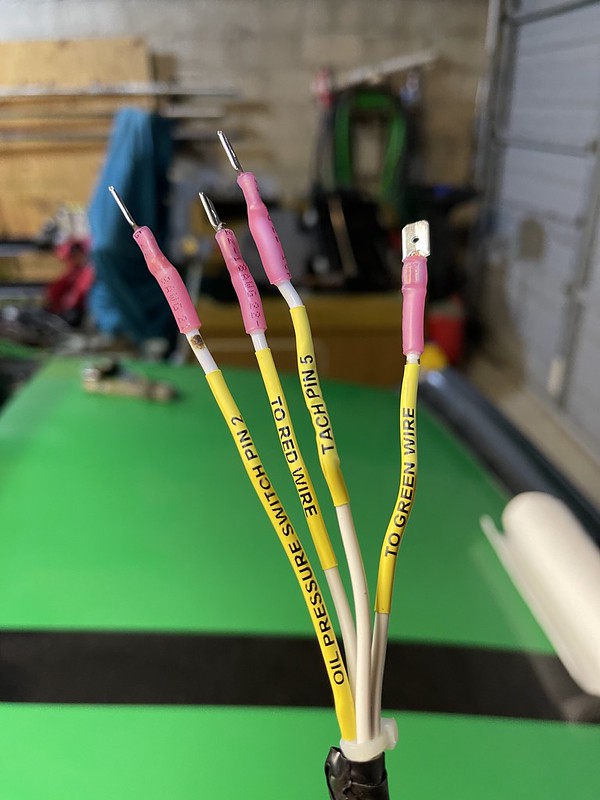

I also remade the 12pin connector harness. I reused my old harness, but cut back the old wires and remade them.
(IMG:http://www.914world.com/bbs2/uploads_offsite/live.staticflickr.com-1435-1681401572.1.jpg)
I'm kinda proud of this one. With custom wiring documentation is everything. 10 years from now I know I won't remember what I did. Instead of drawing the diagram and sticking it in my manual, I labeled the wires themselves by printing labels on heat-shrink tube.

OK, need to know, how did you print on heat shrink tubes? (IMG:style_emoticons/default/confused24.gif)

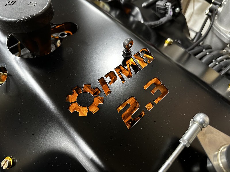

914werke   What is that shroud made out of?   Mar 17 2023, 10:26 AM
NARP74   What is that shroud made out of? Hopefully alumi...   Mar 17 2023, 11:39 AM

rhodyguy   I think the stock tin is still used.   Mar 17 2023, 01:33 PM
NARP74   I think the stock tin is still used. The cover a...   Mar 17 2023, 02:12 PM

VaccaRabite   Finally a little time to work today over lunch. Fu...   Apr 19 2023, 12:58 PM

VaccaRabite   @jamie Any modern label maker can load cassettes ...   Apr 19 2023, 05:35 PM
VaccaRabite   So close but no cigar tonight. :headbang: http:...   Apr 19 2023, 08:28 PM
VaccaRabite   Thinking about this with a clearer head this morni...   Apr 20 2023, 06:04 AM

VaccaRabite   whtCGQ4mIVU First start! I let the 15 year o...   Apr 20 2023, 07:44 PM
