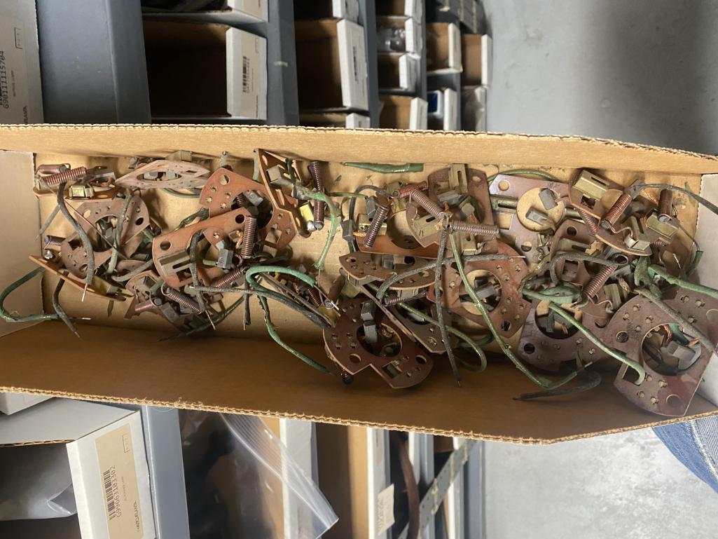

we have the factory brush holder in stock 91462890300
