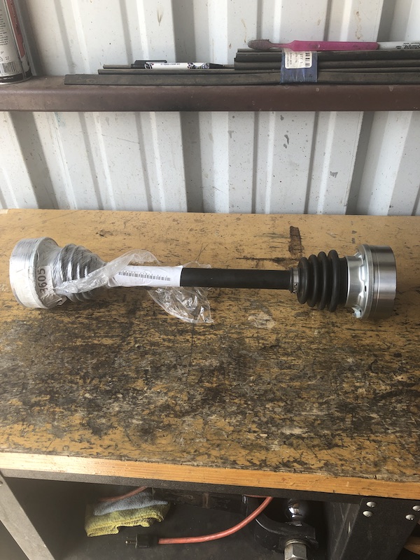

I was able to purchase a VW Bus Axle. 914 axles are 20.25 in length and about 25mm in diameter. This bus axle is 20.50 in length and 28mm in diameter (double check the length on what you are buying). Best I can measure the CV's are in the same place with just 3mm on each end difference. The 914 axles I have look like they were ground off to make them shorter from the factory There is plenty of room in the 944 Turbo stub axle and the 915 transmission flange for movement. The axles are fully loaded and ready to go. Depending on where you shop you can pick up a pair shipped for less than $185. The only modification I see will be adding extra gasket on the transmission flange. To make these work you will need 944 stub axles and 915 transmission flanges.
The old original bus cv's had 17 degrees on angle. The new 944/bus cv's go a full 24 degrees. Stock 914 cv angle was 12 degrees. Will play around this weekend and see what comes up.

Not this is not a plug and play. This may let you use a stock off the shelf VW bus axle (100mm CV). You will need a 69-73 914-6/911 rear hub, 915 or 944 stub axle along with 915 transmission flange. Using these pieces you should be able to do upgrade.

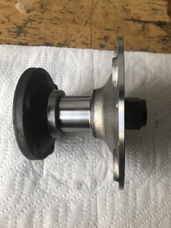

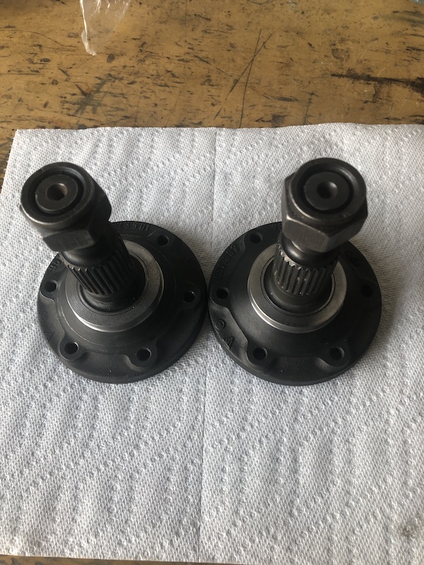

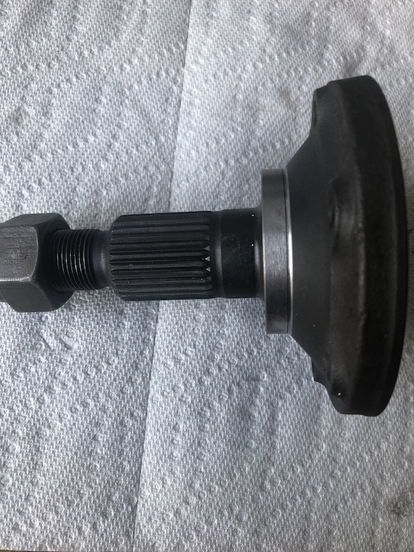

Lots of axle makers on the internet. Just have to make sure you get the 20.50 " one. Adding pictures of 944 Turbo stub axle with custom pressed on spacer. Also shown with 914-6/911 hub.
