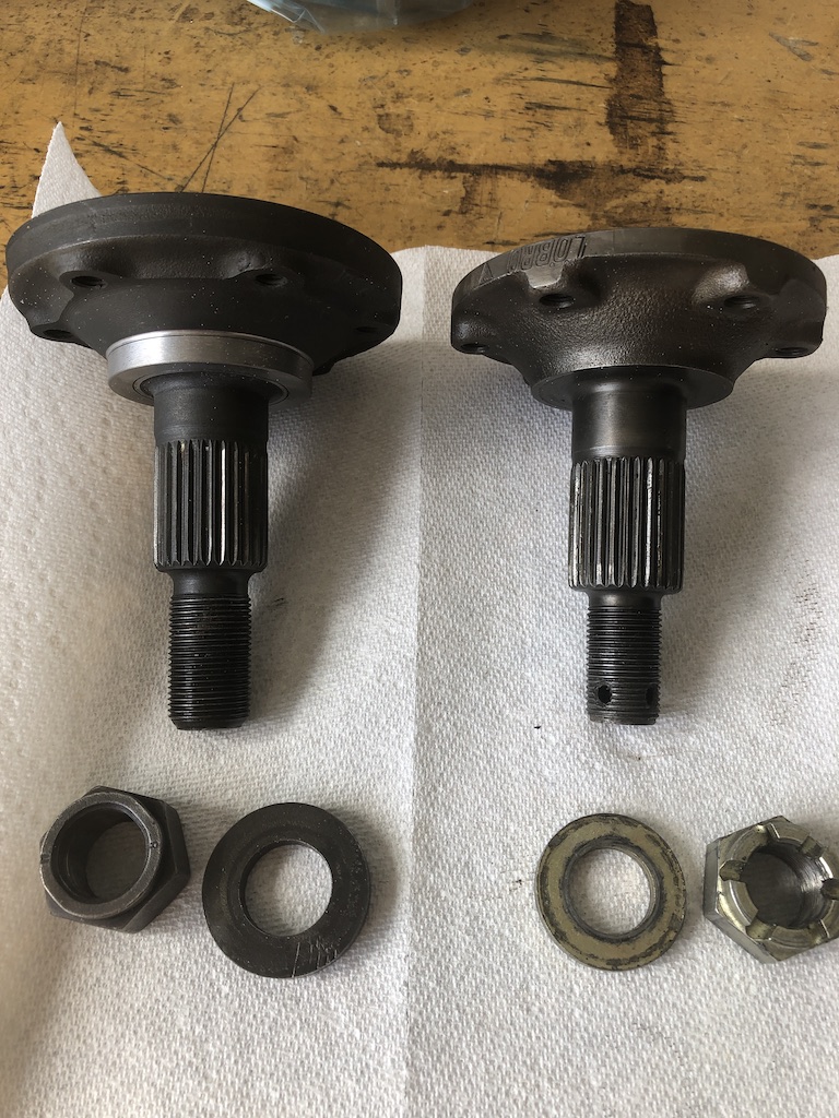

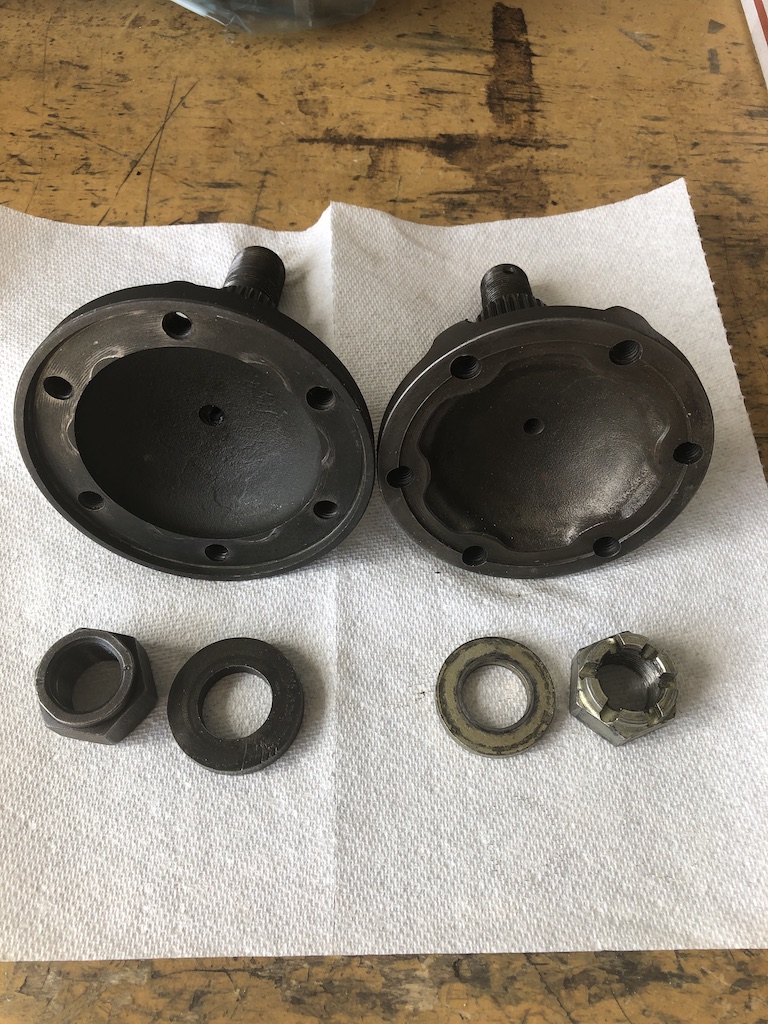

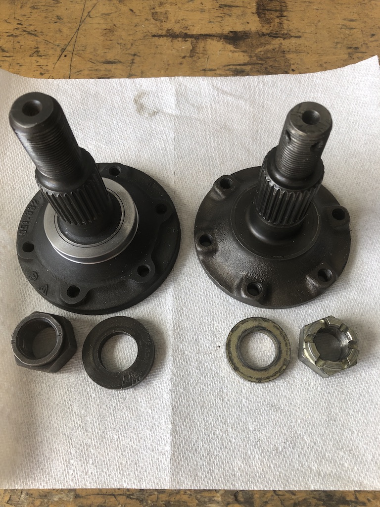

Had a 944 Turbo hub and 911SC out today. The 944 T hubs have a 32mm fine thread nut and a thicker washer. 911SC looks like the 914 but with a grove cut in hub for gasket. When the 944T hub is installed in 914 control arm, there is about 10mm of clearance all the way around.
