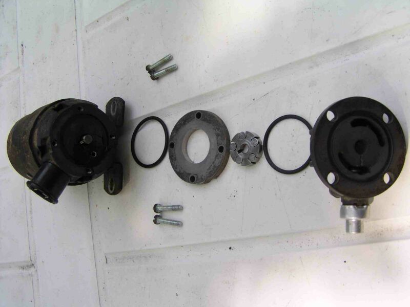

Here's a photo of the pump taken apart if you haven't seen it.

yuck - sorry about the size guys. Have to get out the photo editor before adding more pictures.
