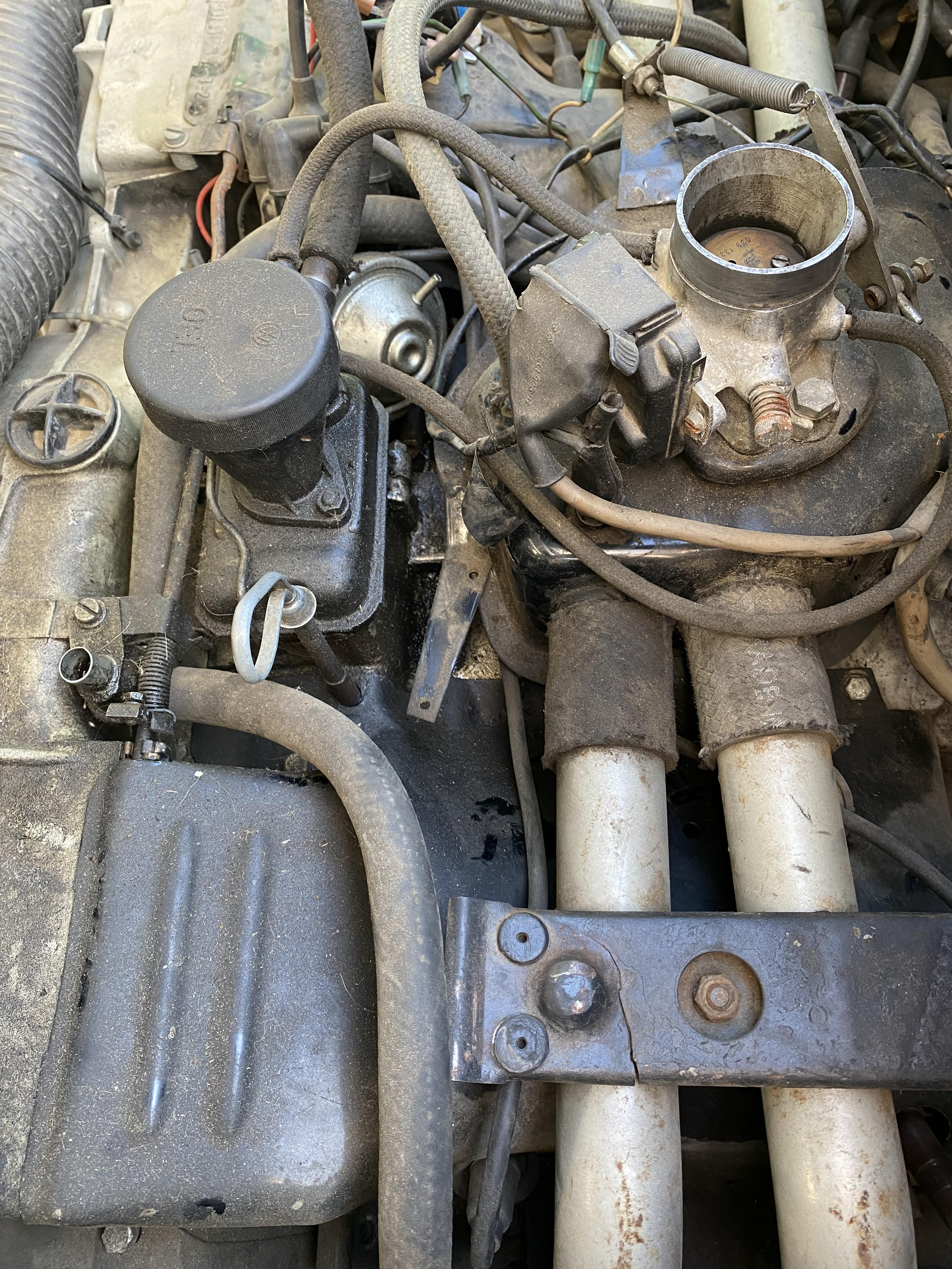

After some researching, I figured between Issue 1 and the high idle I would poke around looking for vacuum leaks, checking for a stuck open AAR, etc. I popped the air filter housing off to get a better view and was surprised when I could find the AAR. Turns out there is no AAR or Decel valve. The CSV is unplugged as well. Obviously, it has run without them but I’m not sure that is the best long-term option. I also don’t know if this would contribute to/exacerbate Issue #1.
(side note: not sure about the how the hoses are run. For example the hose running from the throttle body (retard?) to the oil filler and not the distributor? And is that a 1.8L oil filler?)

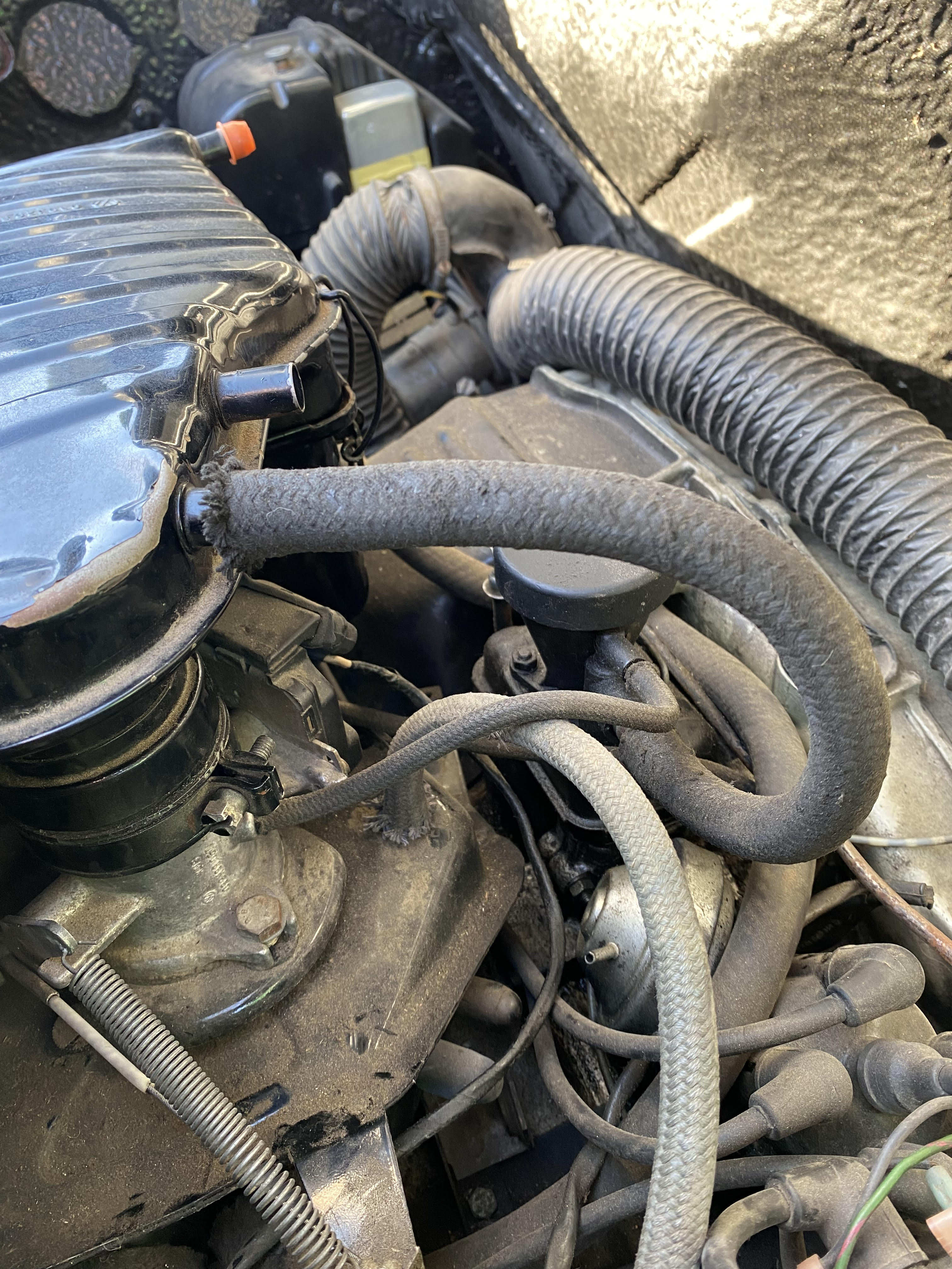

Looks like there's a mix of things going on here that could use a little cleaning up. With the AAR and Decel valve gone it can be a little hard to just go off a known diagram.
The head vent and PCV system are from a '73-'74 model 2.0 setup. Oil filler is not a 1.8L part.
The PCV should have the branch fitting removed and have a hose going to one of the two ports on the bottom of center manifold that are capped(the ones pointing at the distributor). If they are different sizes pick the one that fits the hose the best and leave the other capped.
The port that has the head vents coming to it(mounted near the dip stick) should have a hose going up to the top of the air filter housing above the throttle body.
The short vacuum hose going from the TB to the branch fitting currently on the PCV should be removed and the port on the TB capped. Save the branch fitting if it's not in terrible shape if you plan on sourcing a decel valve in the future.
Can't tell in the photos, but the plastic portion of the CSV has the fitting in it(kind of looks like a plastic spacer) for the AAR to be routed to. If that fitting isn't capped you have a pretty sizeable vacuum leak.
The air cleaner port that has the orange cap on it would have been for an Evap hose. It's fine for now. The other two unused ports on the air cleaner above the TB can be capped as they were for the Decel valve and the AAR.
