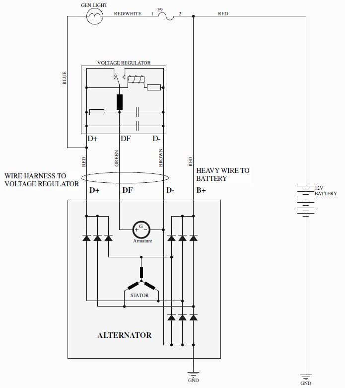

With the engine running, measure the voltages on the VR to chassis ground, not the engine case.
Measure D+ to chassis: should be 14V
Measure DF to chassis: should be 5-10V
Measure D- to chassis: should be 0V
Measure Battery to chassis: Should be 14V
Here's a basic charging system used on the 914. The 911 system is very similar.

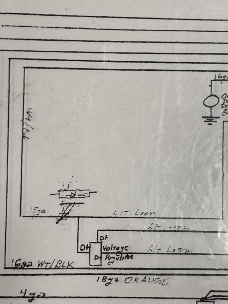

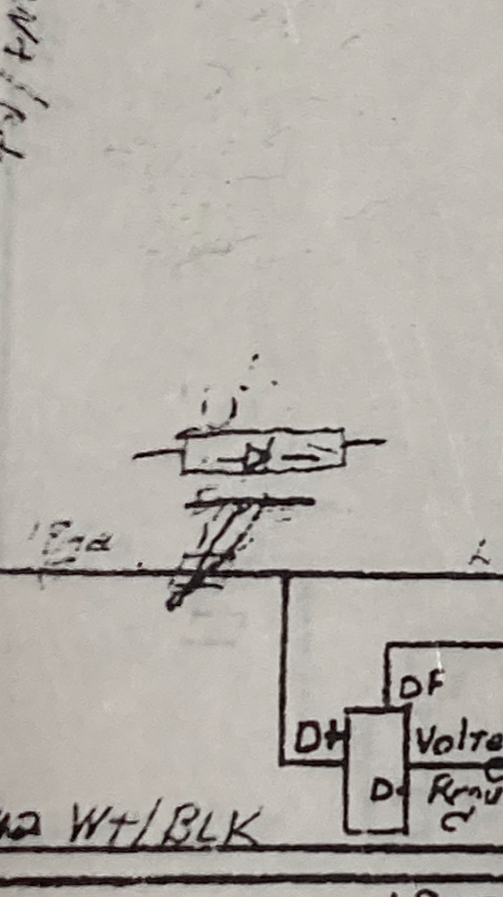

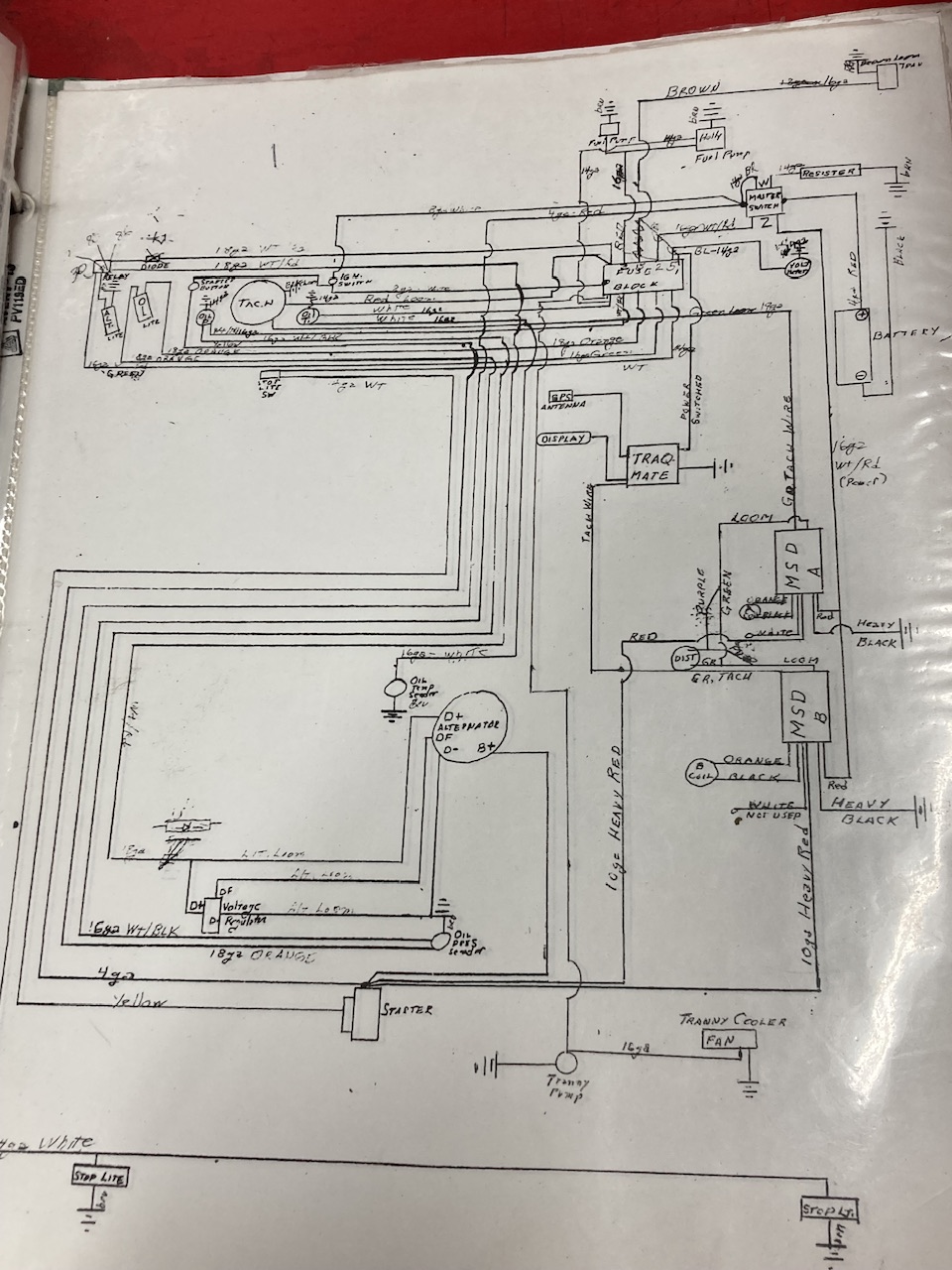

Thanks to everyone. The issue was the fact I used an LED on for the alternator light. Now the battery checks out to be 14.2 volts which is what the shop that checked it got. I do have one more issue however and is when I turn the key off, the car keeps running as its getting power from the alternator. I have found that the correction for this is to add a diode so the current can only run in one direction. Once this is done I should be good.
brant
post Apr 22 2023, 09:41 AM
Posts: 12,010
From: Colorado
Member No.: 47
You have to put a one way resistor into circuit
We did also in our conversion
I’ll try to pull my diagram today for the info
brant
post Apr 22 2023, 10:38 AM
Posts: 12,010
From: Colorado
Member No.: 47
Here is our racecar wiring
Superhawk996
post Apr 22 2023, 10:40 AM
Posts: 7,212
Joined: 25-August 18
From: Woods of N. Idaho
Member No.: 22,428
QUOTE(brant @ Apr 22 2023, 10:41 AM) *
Not pointing this out to shame you, just the facts.
There is no such thing as a one way resistor. All resistors are are bi-directional.
Are you referring to a diode? Small black, round cylindrical package with a band on one end. Diodes only flow current in one direction. Could easily be mistaken for a resistor to anyone not intimately familiar with electronics.
I don’t have schematic in front of me but i do know there is a diode used in my 73’ behind the instrumentation.
brant
post Apr 22 2023, 10:43 AM
Posts: 12,010
From: Colorado
Member No.: 47
Correct. Diode
Old man’s disease
Plus I really don’t love wiring
My dad wired the racecar and also hand drew the schematic
Looks like he drew a diode even

Schmaz356
post Apr 24 2023, 09:17 AM
Posts: 9
Joined: 4-November 21
From: Michigan
Member No.: 26,054
Brant;
One more question.
I installed the diode like you have shown in your drawing. The band is toward the regulator. The engine now shuts off but the generator light does not light at all. Am I missing something?
