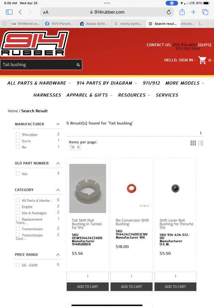

You should be able to find one as most folks convert the tail to side shift. https://914rubber.com/tail-shift-rod-bushin...-tunnel-for-914 Attached thumbnail(s) |

Thanks for the replies everyone. @Mikey914 , I intended to install OEM91442422400 but discovered that the ID is larger for the tunnel bushings than the rear bushing at the transmission. Wish I would have realized this prior to removing the old.

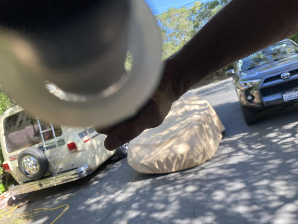

Here’s a pic showing the rod in a new bushing. There is a gap for sure. @fixer34 , thanks for looking up the part number.

Here’s a pic showing the rod in a new bushing. There is a gap for sure. @fixer34 , thanks for looking up the part number. Could you take a photo further back, something doesn’t look right? |

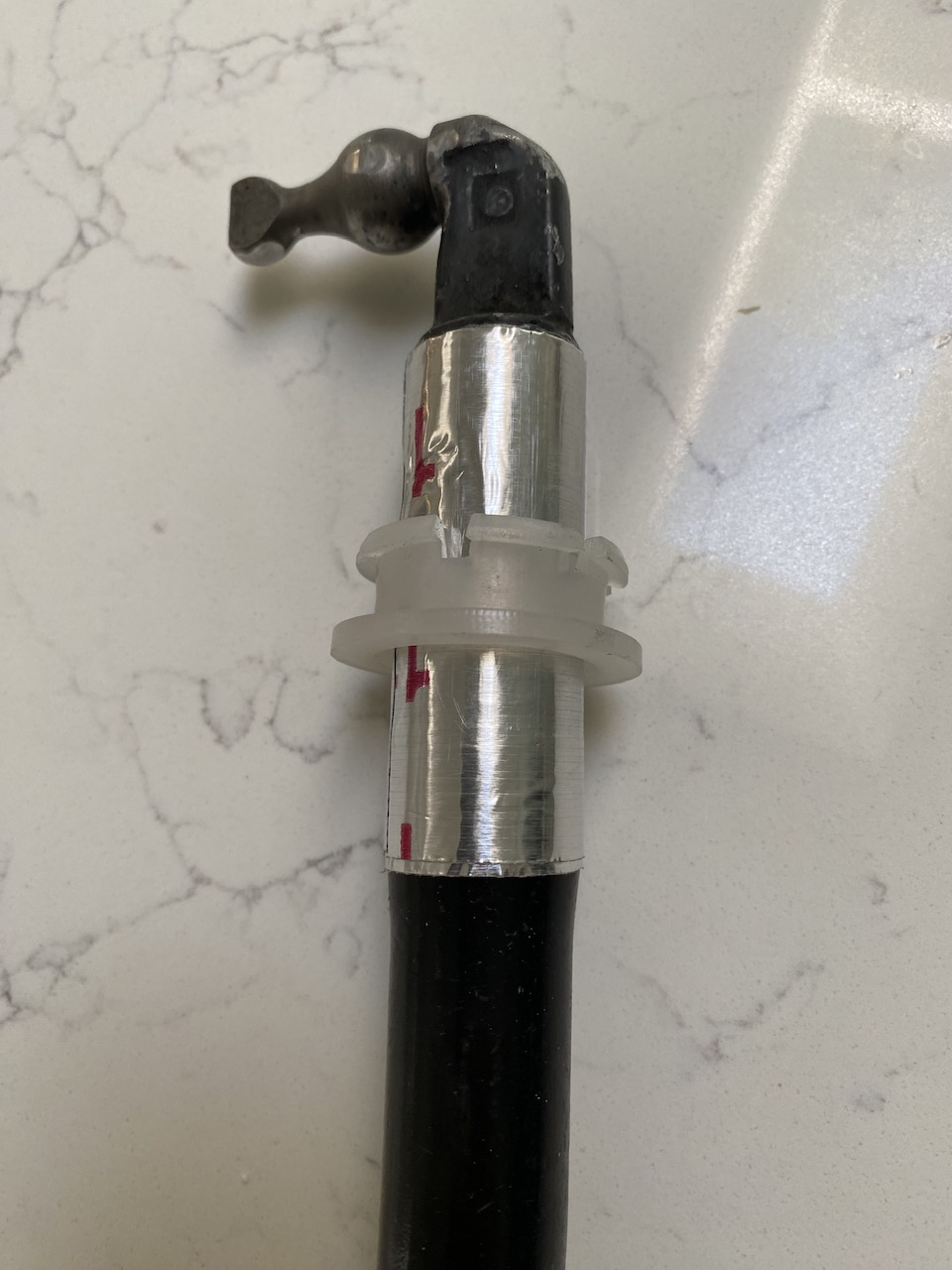

I spoke with George at AA. He confirmed that the 3 bushings are the same part number and that I should get German made ones. I may do that but for now, I’m doing this hooptie fix using Nashua aluminum tape to build up the thickness of the rod. Now it is a tight fit and should last a while. My plans for the car involve moving to a side shift with Chris Foley’s shift rod kit so this is definitely a short term solution. The play at the rear is not attributed to wear on the rod as I have the same problem when moving the bushing past the wear area and on to the original painted surface.

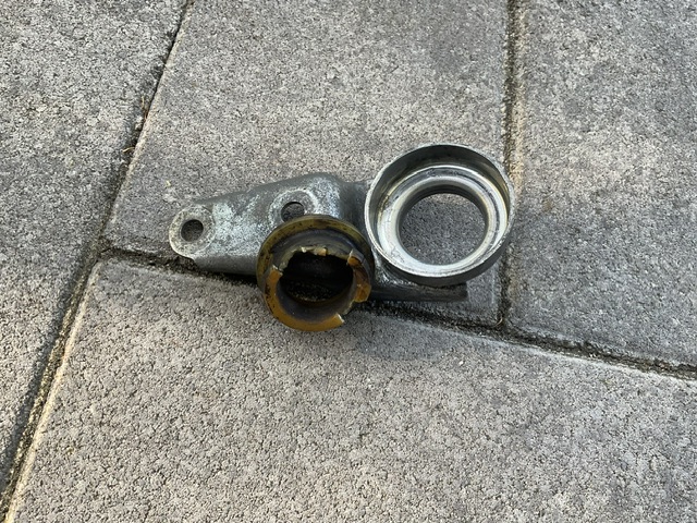

Of course, I can't find the order paperwork now that I offered, but I see you have a 'backyard fix'. I suspect there was wear on the rod, it appears that section in the first photo is shiny. As for trying it further down the shift rod, I believe it is slightly smaller diameter so that is not a good test. The last picture even appears to show it necked down a little past where you added the tape.
I will tell you from experience that the extra gap between the bushing and rod doesn't make that big of a difference; tail shifters are a bit loosey-goosey anyway. |

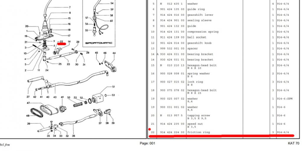

91442422400 get a real factory one, the aftermarket sometimes do not fit tightly enough
Does anyone know where to get the bushing that supports the shift rod at the transmission for a tail shift car? Apparently, it has a smaller inside diameter than the ones that go on the firewall and under the shifter. I looked on 914rubber, AA and Pelican and can’t seem to find it. ![]() |

Just following up on this. I decided to replace all the bushings again using the kit from AA. The bushings were from uroparts and fit much better than the 914rubber ones. The shift rod balls were the same diameter as the 914rubber ones. There was still more play than i would like to see so decided to do the Nashua tape hack on all three bushings and both balls. The aluminum tape held up well after 4k miles so thought it would be nice to see how the car would shift after removing as much play as possible without going overboard. I have to say that I am pleased with the results! I thought about powdercoating the rear shift rod to take up some clearance but took the easy way out for now. I was also thinking of making my own balls on the HF lathe which may still happen if the tape craps out. For now, the tailshifter is not bad at all. Another thought if wanting to take this further would be to configure some sort of heim joint setup doing away with the balls completely.
