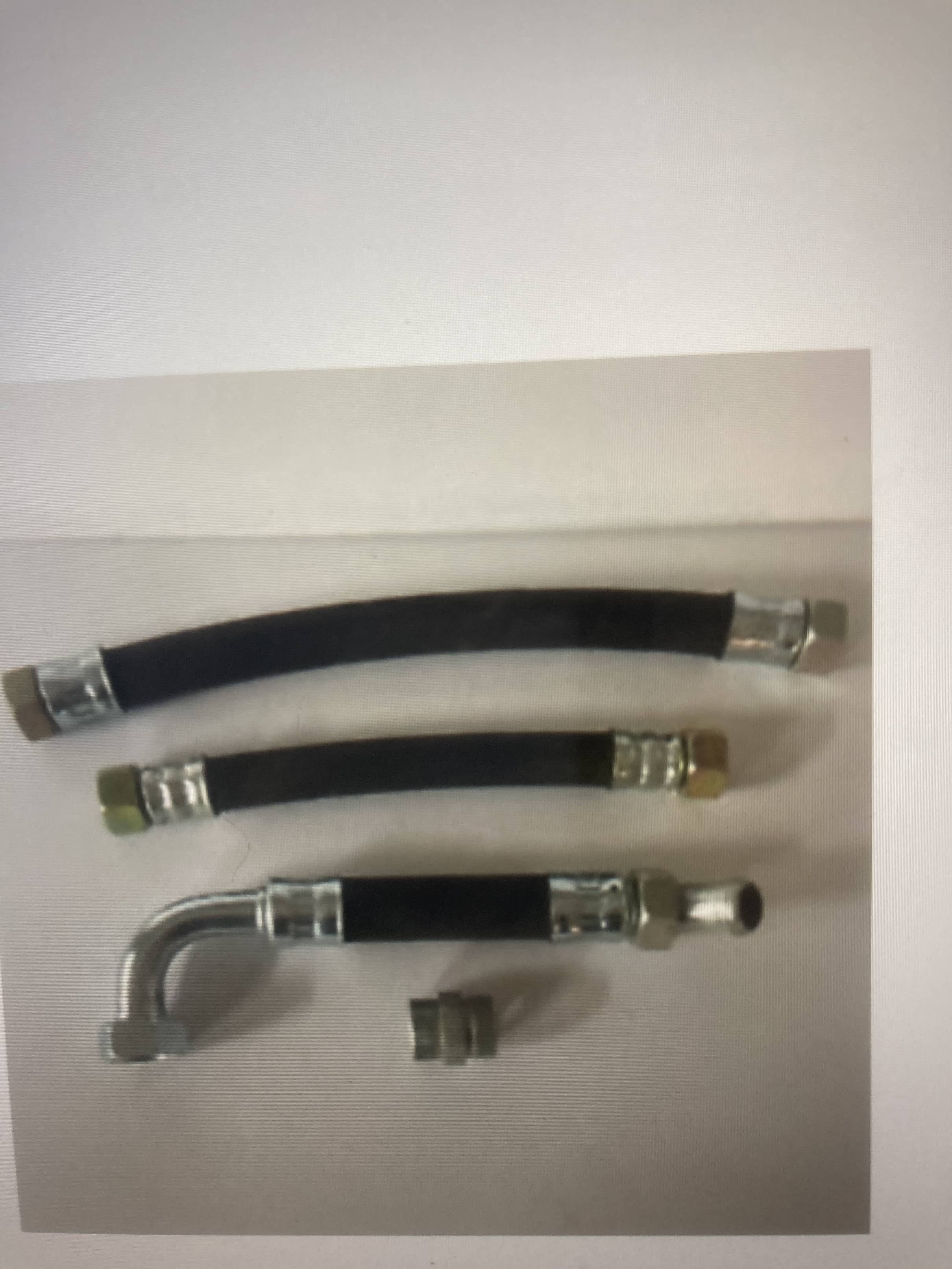

Ar3 these the same configuration as original…..for some reason they don’t “seem” to be….but haven’t had one in front of me for a while.

They look correct but without actual measurements I cannot confirm

Obviously aftermarket as the ends are different. Something I discovered when replacing the long hose (I reused the factory ends) to the oil cooler is you want one with the 90 degree bend already formed into the hose. It tends to kink otherwise. I had to put a couple hose clamps on mine to prevent it pinching at the bend.
