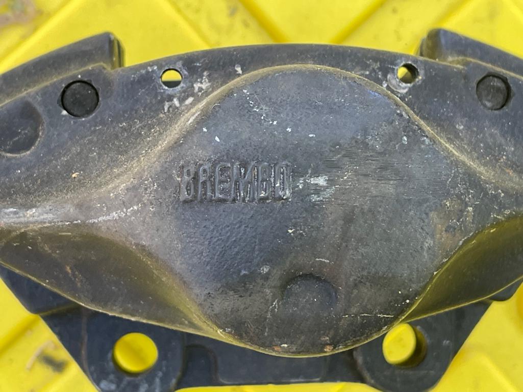

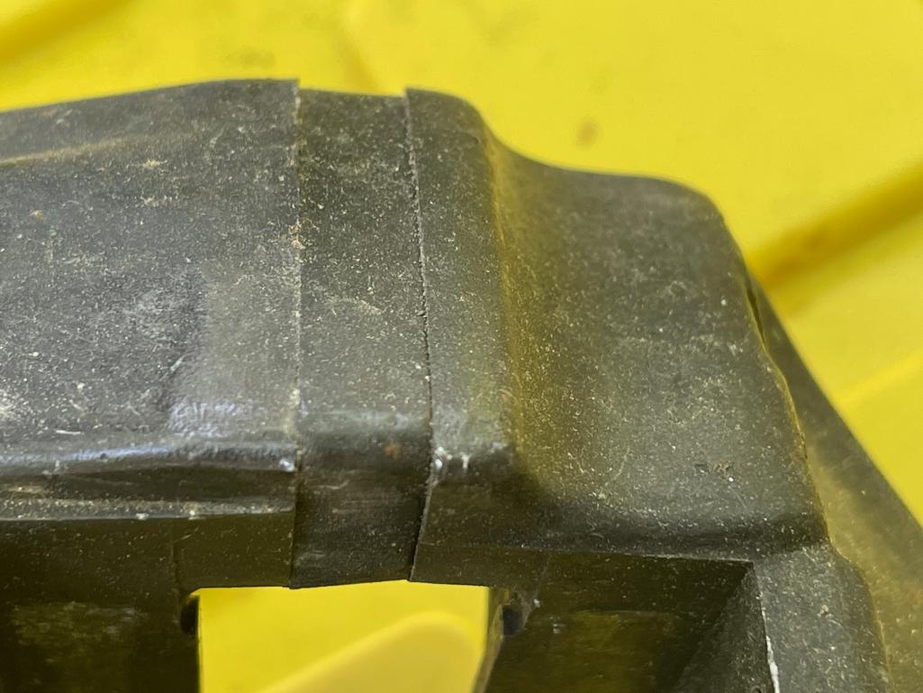

OK - took a while but am back with the program thanks to @mepstein pictures.

I have 3 pair of the Alfa Brembo calipers and they all have spacers that measure approx 9mm thick.
