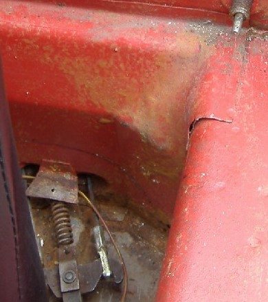

I’m having a bit of a moment. Can anyone tell me where the parking brake spring is supposed to attach? It’s attached to the distribution bracket, but I can’t figure out where the other end attaches. Under that flap is just a rusty hole…
Thanks all!

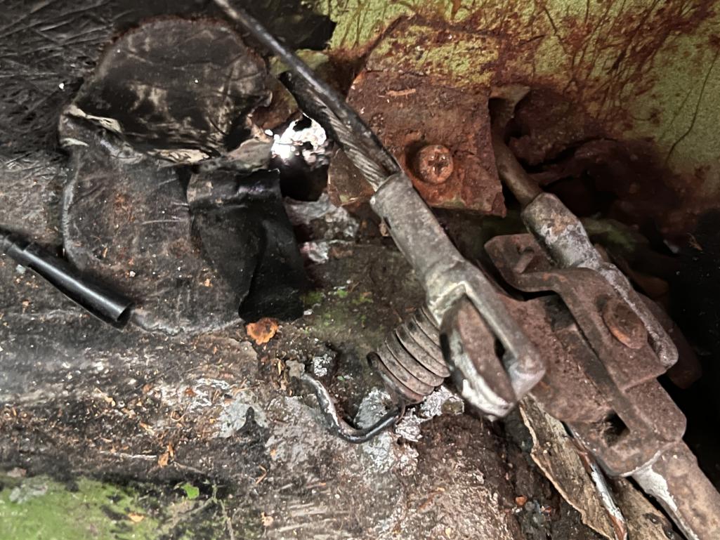

It is a small loop of metal formed out of the firewall. You will need a mirror to see it fi it is still there.

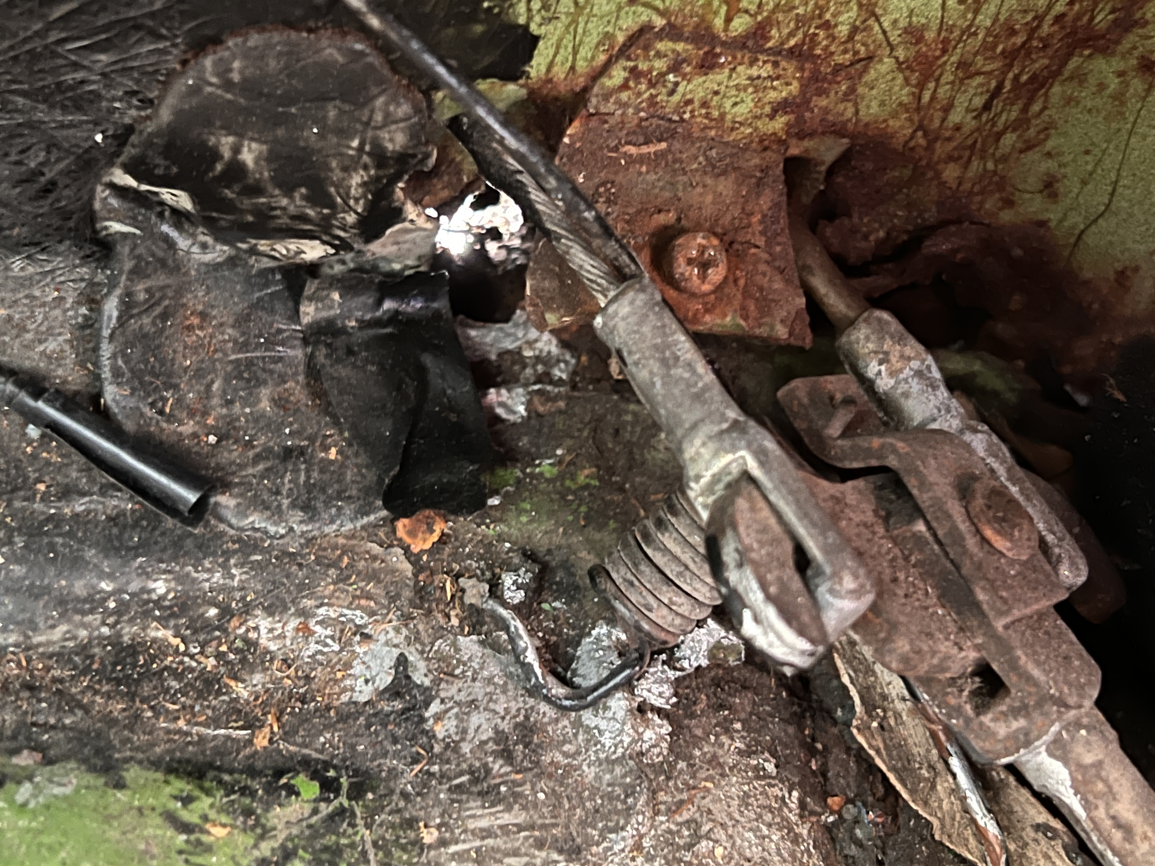

Hope this helps.
