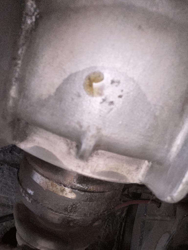

Howdy,
I noticed a newish leak under the car. So I clean up the bottom best I could and let it sit for a bit. The leak appears to just seep through the case slowly but consistently. Maybe a defect or small crack? I'm wondering what my options are here? Only solved with a new case or is there a band aid until this can be bundled with other related maintenance?
Cheers.

Looks like it's leaking at the output shaft seal.

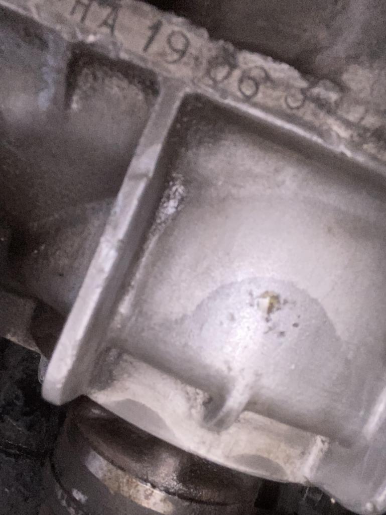

Yeah, I thought it would have been from a seal but there is no trickle down anywhere. You can cleaned it up again and 5 minutes later there is a small drip starting to form right at that spot.

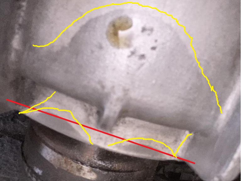

Are you sure? Where the drip shows is just the lowest point. Areas outlined in yellow look like where gear oil has traveled from (or to).
There's probably a better way to test, but after cleaning it thoroughly, maybe dust the whole area with baby powder or baking soda to rule out a leak elsewhere.

@rjames I hear what you are saying so I've double checked again. I can wipe it all down and actually watch the next drop form. It's like digging a hole in the sand and watching water fill it in. The exact spot has a bit of a different texture if I run my finger over it. As for the ring area you highlighted can the case just be that porous and is saturated with gear oil?
I'll give the jb weld a shot but not sure how well it will work as the drip re-forms so fast that I doubt I can get it clean and dry long enough for the jb to set up.
