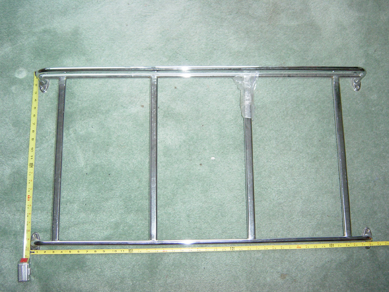

I have one of these but I don't know if it can hold that much weight without distributing the weight out on a piece of plywood or something.
Jeff
roundboy914
post Aug 15 2005, 04:35 PM
Posts: 210
Joined: 16-October 03
From: Chicago, IL
Member No.: 1,251
Is that 4 sale, or do you remember where you picked it up? Cause i could use it for all of the other crap, and put the tires in the trunks.

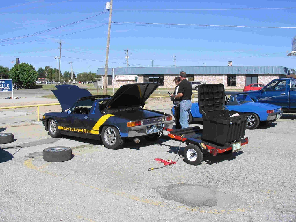

A friend of mine here is really serious about tracking his 914. he purchased a small utility trailer from Harbor Frieght w/8" wheels. Made a simple tire rack for 4 tires side by side. Added a plastic locker tote for his jack and misc.
Attaches it to his 914 by way of a hidden receiver behind the license plate. Open the trunk, pull the hitch pin, remove the license tag receiver. Put the trailer receiver in and install the pin. He then puts the tag into a receiver that he mounted on the back of the trailer. Pretty cool. It does require cutting a square hole into the bumper behind the tag though.

post Aug 15 2005, 04:53 PM
Posts: 76
Joined: 23-February 04
From: Collinsville, OK
Member No.: 1,706
Here is a pic of the trailer. Hope this works!
Geo

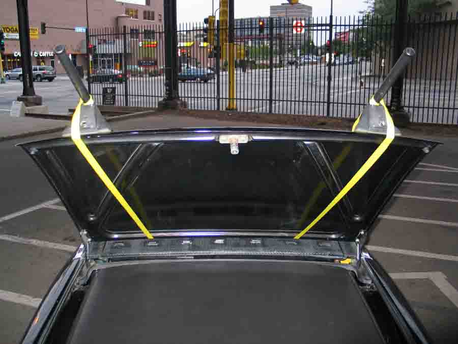

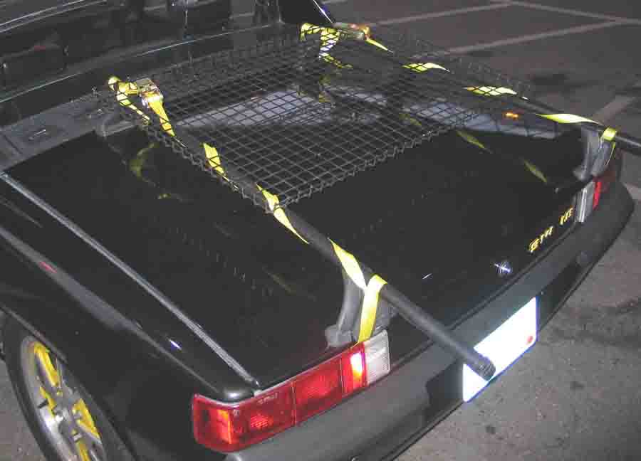

if you can beg borrow or steal a yakima
no pics, sorry, but i'm road-trippin' soon and i figured a way to attach my ('98 jetta) yakima rack to the rear trunk lid.
first, i took the plates off the clamps that normally grip the door sills, leaving only the feet with the rubberized pads. (i had to adjust up the clamp so the guts didn't contact the deck lid)
because my bars are the shorter ones i couldn't mount it laterally (not sure if the long ones would make it), so i measured them out and spaced the equally longitudinally. the feet rested better when i spread the rear mounts out slightly to match the curve of the deck.
i propped the decklid and fed a ratcheted tie strap under and up on each, and fiddled with it to wrap around the feet and bar. i had to have the ratchet on top because there's no clearence inside for it, but when i added the luggage bin, it's sorta hidden. (i could have had the clamp plates fabbed to fit around the decklid and still might, but i didn't wanna spend the cash just yet. then it's just clamp and go!)
don't ratchet too tight as you'll gain tension marginally from the top when you close the lid. if you do it right, you'll have full access to your trunk and engine bay w/o removing the rack, and you can add lateral bars or even 2x's to lash down at least 4 skins.
good vibes 2 ya ~
Jeffs9146
post Aug 16 2005, 08:55 PM
Ski Bum
Posts: 4,062
Joined: 10-January 03
From: Discovery Bay, Ca
Member No.: 128
Sure is! PM me with your offer and we can chat about it!
Jeff

lotus_65
post Aug 17 2005, 12:58 AM
Posts: 1,609
Joined: 21-March 05
From: minneapolis, mn
Member No.: 3,795
QUOTE (joseph222 @ Aug 17 2005, 12:29 AM)
(IMG:http://www.914world.com/bbs2/html/emoticons/thisthreadisworthlesswithoutpics.gif)
Come on. Give'em up. (IMG:http://www.914world.com/bbs2/html/emoticons/biggrin.gif)
dood! my camera's out of town. thanks though, it is a good setup... i'l try and borrow 1 tomorrow.

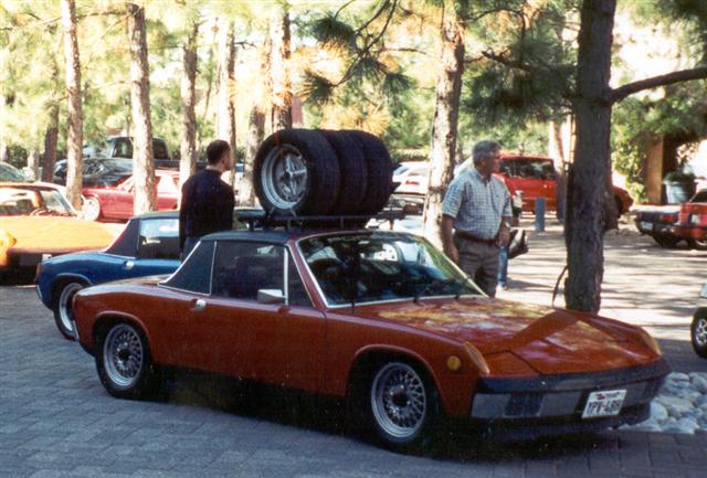

I took a spare roof and made a rack that holds two to five tires. At the track I install a plain roof for running. A friend is borrowing the rig now but I have a pictgure of it on my car with tires. I'd be glad to post it if someone would tell me how to add pictures to these messages.
Ed

post Aug 17 2005, 10:16 AM
Posts: 44
Joined: 5-February 03
From: San Antonio, TX
Member No.: 247
here is my picture attempt. this was taken at the 2001 Dallas 914 gathering

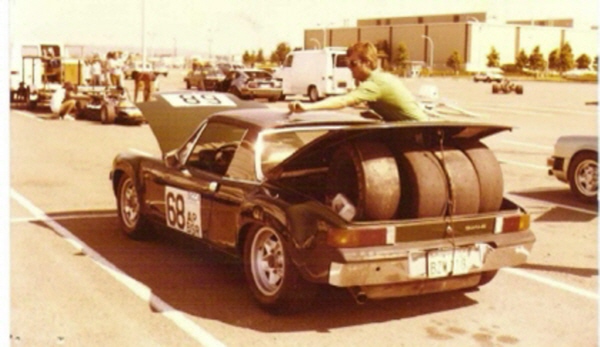

Hmm, another variable in cars and tires. I can get two Kumho V700's in my front trunk 205/50-15.
one in the back trunk and one on the floor board.
Hoosiers only allows 1 in the front. one in the back but you can't get the roof in. one on the floor board and one on the seat.
Wife may go with me to next event So I will put all 4 in the back on edge and the ton of other crap up front.
Might put my "dicked up" rear deck lid on.

lotus_65
post Aug 17 2005, 07:25 PM
Posts: 1,609
Joined: 21-March 05
Member No.: 3,795
rack 1
lotus_65
post Aug 17 2005, 07:26 PM
Posts: 1,609
Joined: 21-March 05
Member No.: 3,795
rack 2
