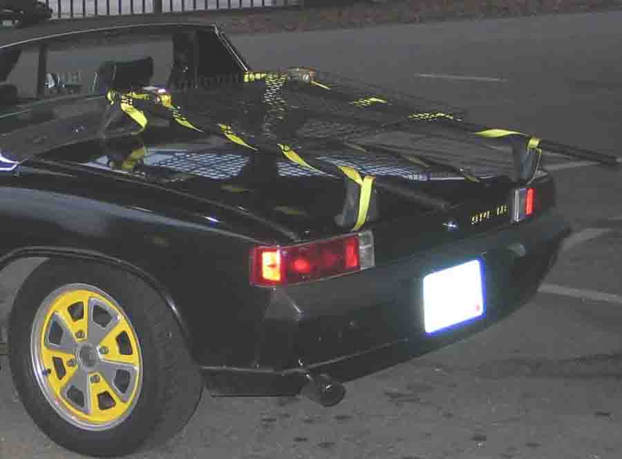

lotus_65
post Aug 17 2005, 07:26 PM
Post #21
Posts: 1,609
Joined: 21-March 05
From: minneapolis, mn
Member No.: 3,795
rack 3

lotus_65
post Aug 18 2005, 08:26 AM
Post #23
Posts: 1,609
Joined: 21-March 05
Member No.: 3,795
QUOTE (roundboy914 @ Aug 18 2005, 07:32 AM)
Now that is what i am talking about. thanks for all of the great ideas. That is what i love about this place. Ask a question, and most likely, you will get more than one response. Thanks again.
yea, sorry 'bout the resolution, i have the larger files...
i think it would be easy to use bars or even 2x's laterally with ratched straps to lock down your gear. good luck!

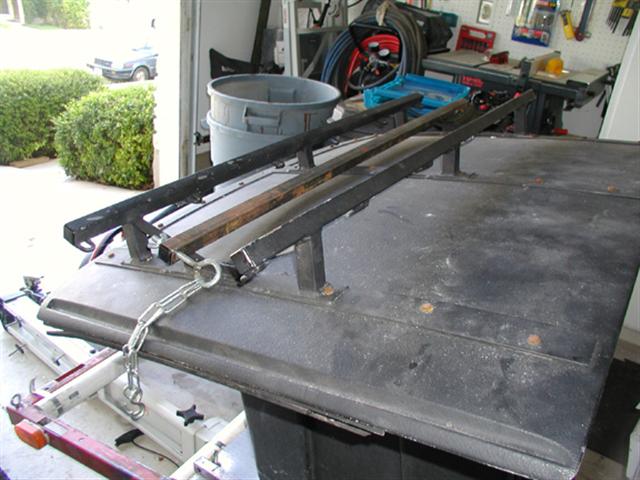

Oled
post Aug 18 2005, 09:06 AM
Post #24
Posts: 44
Joined: 5-February 03
From: San Antonio, TX
Member No.: 247
In case someone might give a rat's patoot, my friend took some pictures of my roof rack and sent them to me. The tires are secured by a bar going through the wheels and fastened to the cross bars by a chain and turnbuckle. note the foundation of the rack that covers a wide area of the froof. This gives great strength to the unit and keeps the top from cracking when a large weight gets bounced on a small area. I have several different through the wheel bars to use to secure different numbers of tires on the rack.
Oled
Post #25
Posts: 44
Member No.: 247
Another view

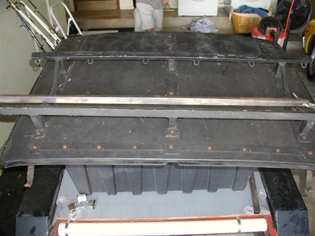

Oled
post Aug 18 2005, 09:07 AM
Post #26
Posts: 44
Member No.: 247
Yet another

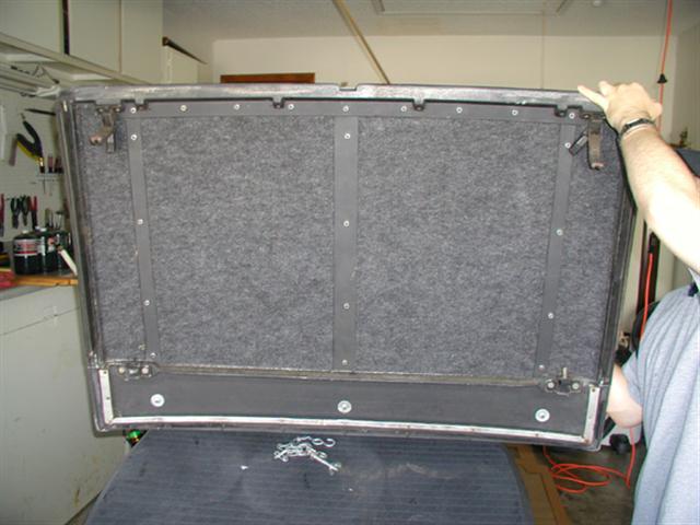

Oled
post Aug 18 2005, 09:09 AM
Post #27
Posts: 44
Member No.: 247
Here is the underside of teh roof. The mounts for the roof rack make a sandwhich with the roof in the middle. this does a great job of spreading the load.
